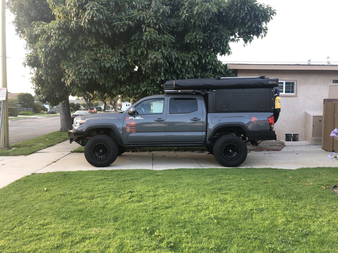

    This is my dream rig. I have a white 2018 Toyota Tacoma SR5 and want it to look exactly like this!!

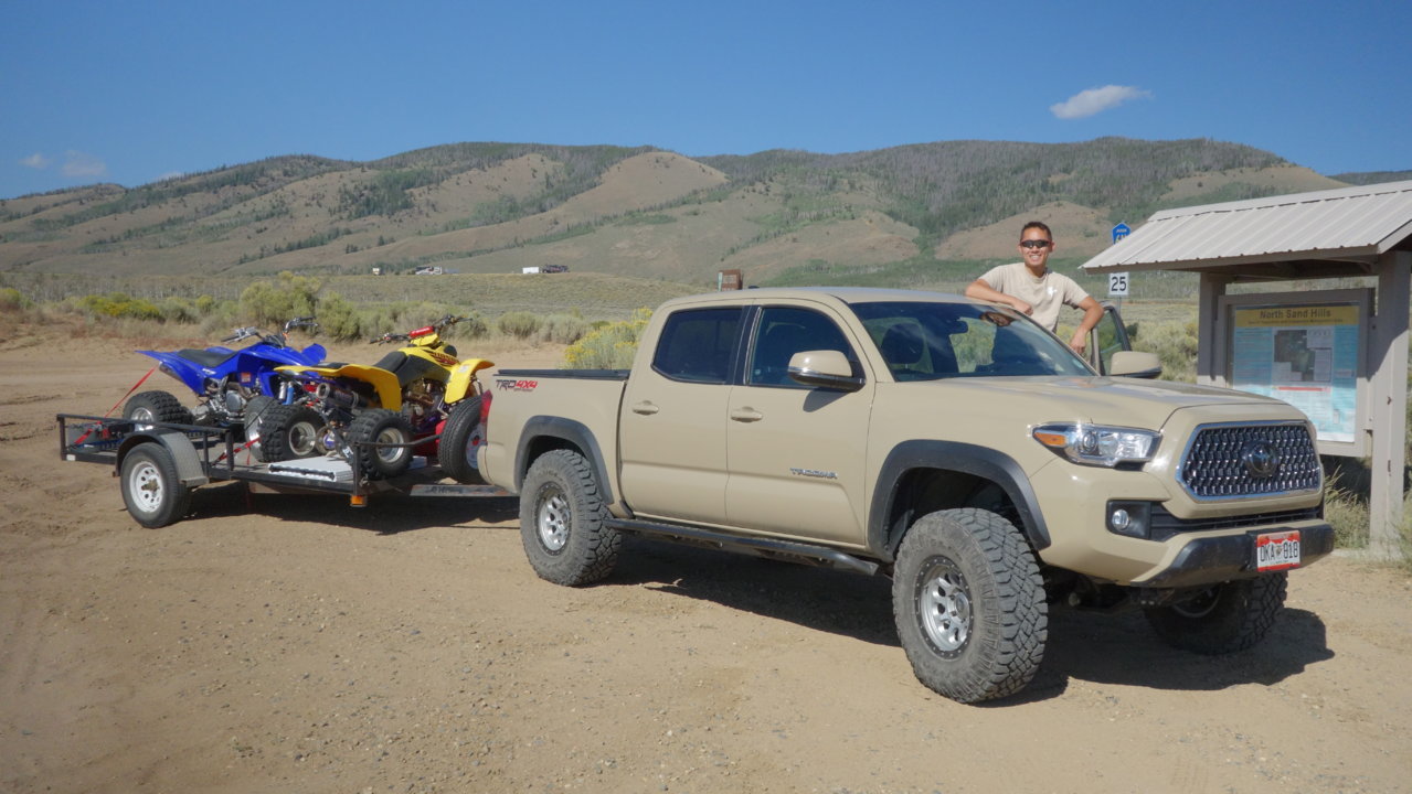

    Did some towing on Option 1 last weekend! I should have changed it to Option 2 prior. I thought I would never use the extra leaf but I'm glad I have the option now for the next trip haha.
