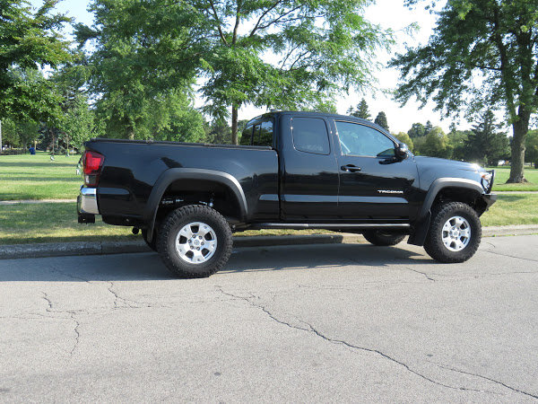

    Option 3 with Speedway Ford Model-T leaf liners P/N 91033038-BLK
    I have an Extang Solid Fold tonneau on an empty bed. I got 4 in. of lift total, of which I estimate about 3.6 in. from the leaf pack, and 0.4 in. from the leaf liners (1/16 in. x 7 layers). Took it for a test drive afterwards and got up to 50 mph. Did a few hard launches and a few coast-downs from different speeds. No driveline vibes and no squeaking after 4 months and three wheeling trips.

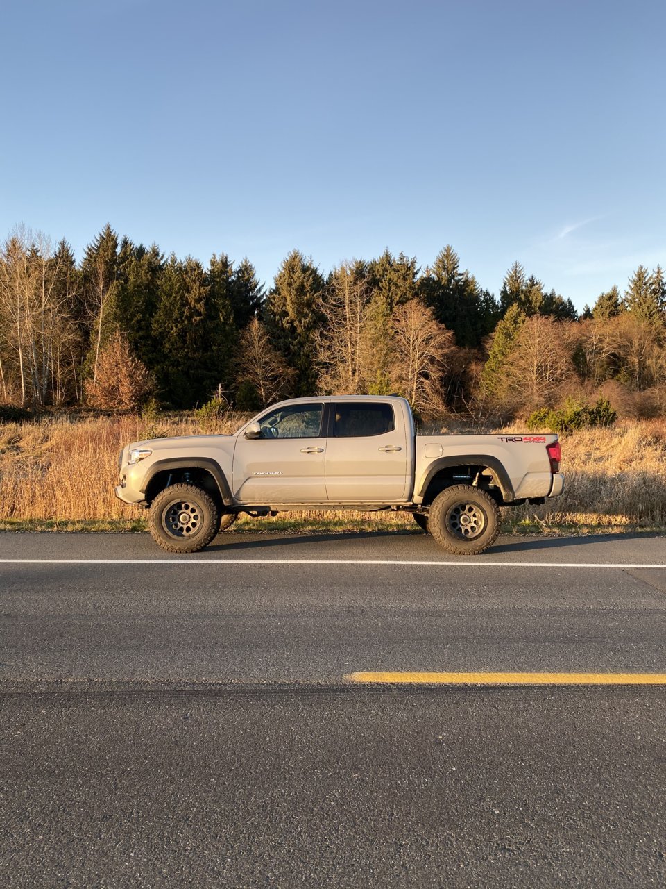

    Installed my RXTs last night. Running it at Option 2 and paired with Kings w/ adjusters. I’m not experiencing any shudders or vibrations (I hope I wont jinx myself...) I do have a CB Drop which I previously had on when I had an AAL set up. The only shims I have on are the shims that came with the OEM leaf pack which I then added to the RXT pack.
