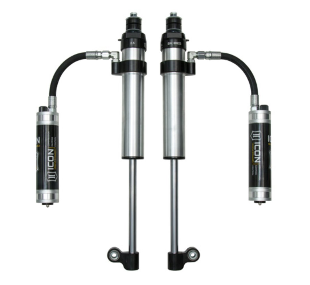

    ICON cdcv shocks
    Fluid film eh? do you have a link for it? sorry i am not familiar with it.. thank you in advance

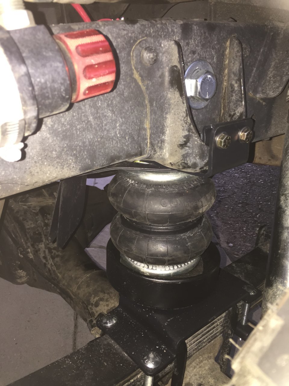

    I have the exact same setup, but just installed airbags for the trailer (same weight) and some of the wood loads I carry (900lbs +/-). I will be interested to see how they perform.

    I'm curious how it performs too. I'd think about something similar if I towed more but wouldn't want to sacrifice offroad ride as I think the airbags would stiffen the ride quite a bit.

    That’s why I added the cradles so they aren’t connected and can allow articulation. Check this out more towards the end of the video

    I had no idea something like that was available. Very cool. Do you just run the minimum 5 psi when you don't need the bags?
