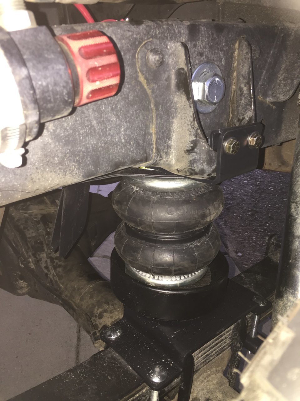

    ADS shocks and Icon RXT leaf stage 2. Airbags too.
    Factory mounts

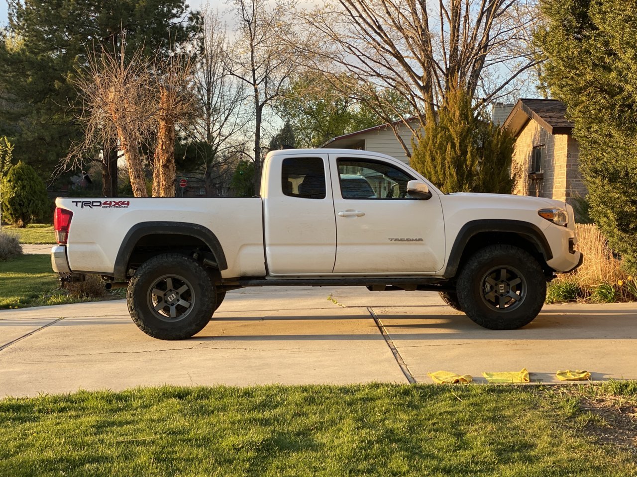

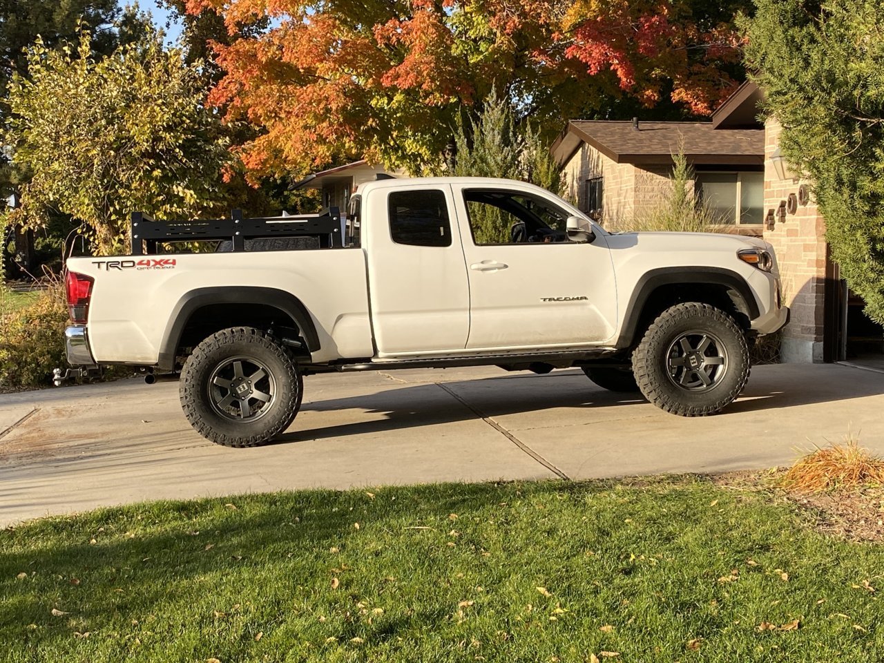

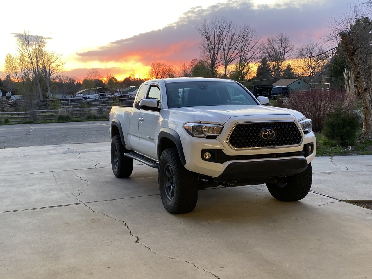

    Thanks for all the advice here. Got mine installed today and it rides great!
    Set at option 2. Bilstein 6112 set on 5th perch in the front and 5160 in the rear.
    Hardest part of the install was changing the brake lines.

    How much of a rake did you end up with?.. looks good..

    Thanks!
    Hard to say. Didn’t take any measurements. It was level before using another brand leaf spring and now it has like a 0.5-1.0” rake. Got a CBI high clearance bumper on order and it will lose a little rake once that’s installed.
    Here’s a before and after picture
    Before
    After
