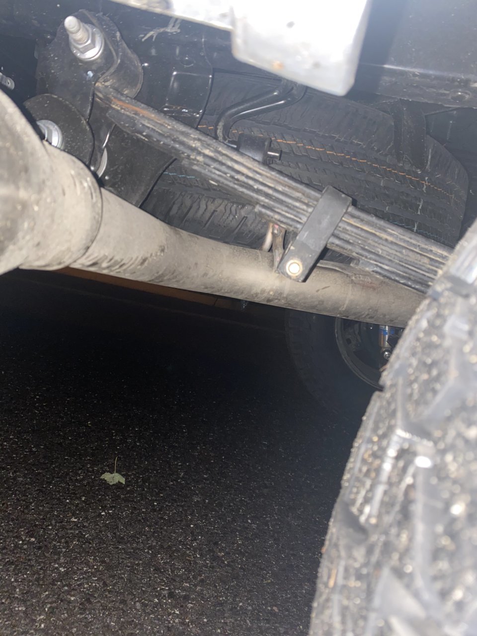

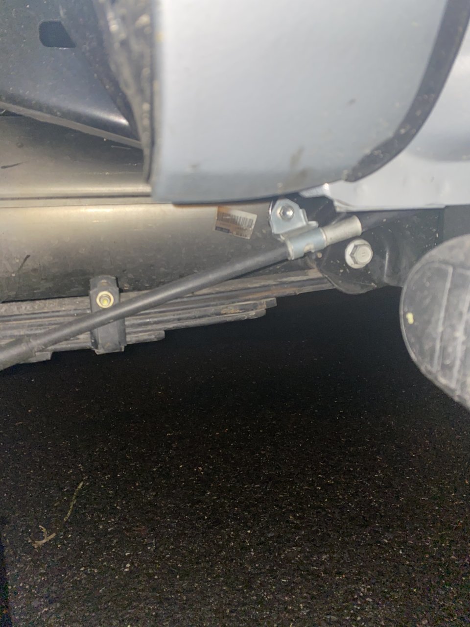

    So looking over this thread I have option 3. Seems I might have installed the leaf the wrong way
  19. May 23, 2020 at 11:15 AM
    #519
    Nomis88
    Nomis88 Well-Known Member
    Jul 3, 2019
    #298181
    141
    max
    17 taco
    Yeah, I did the same thing. That’s wrong
