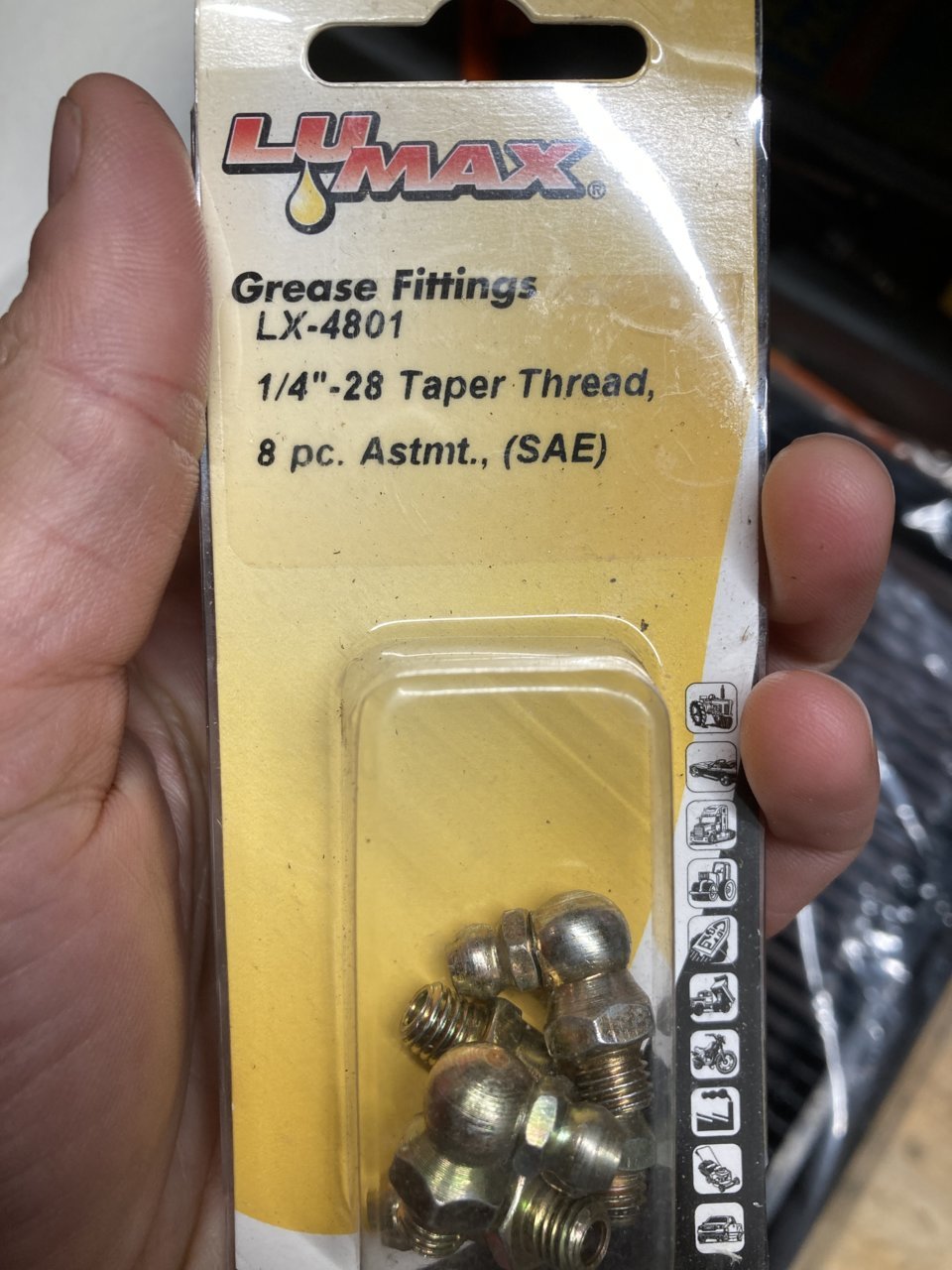

    What size zerks did you use? I picked up some M6x1 (15mm long) and they look purty small.

    7,366
    2016 TRD OR DCSB
    C4Fab LoPro, BAMF Sliders, Ext ADS 2.5’s, 4.88's, OVTune (OG to KDMax)
    CAG Gonzo[QUOTED] likes this.

    Thanks for that. Does size matter (at least in this context)? I don't have a grease gun yet but given how small the M6 size is, I wonder if I'd need a special nozzle just to latch on to it.

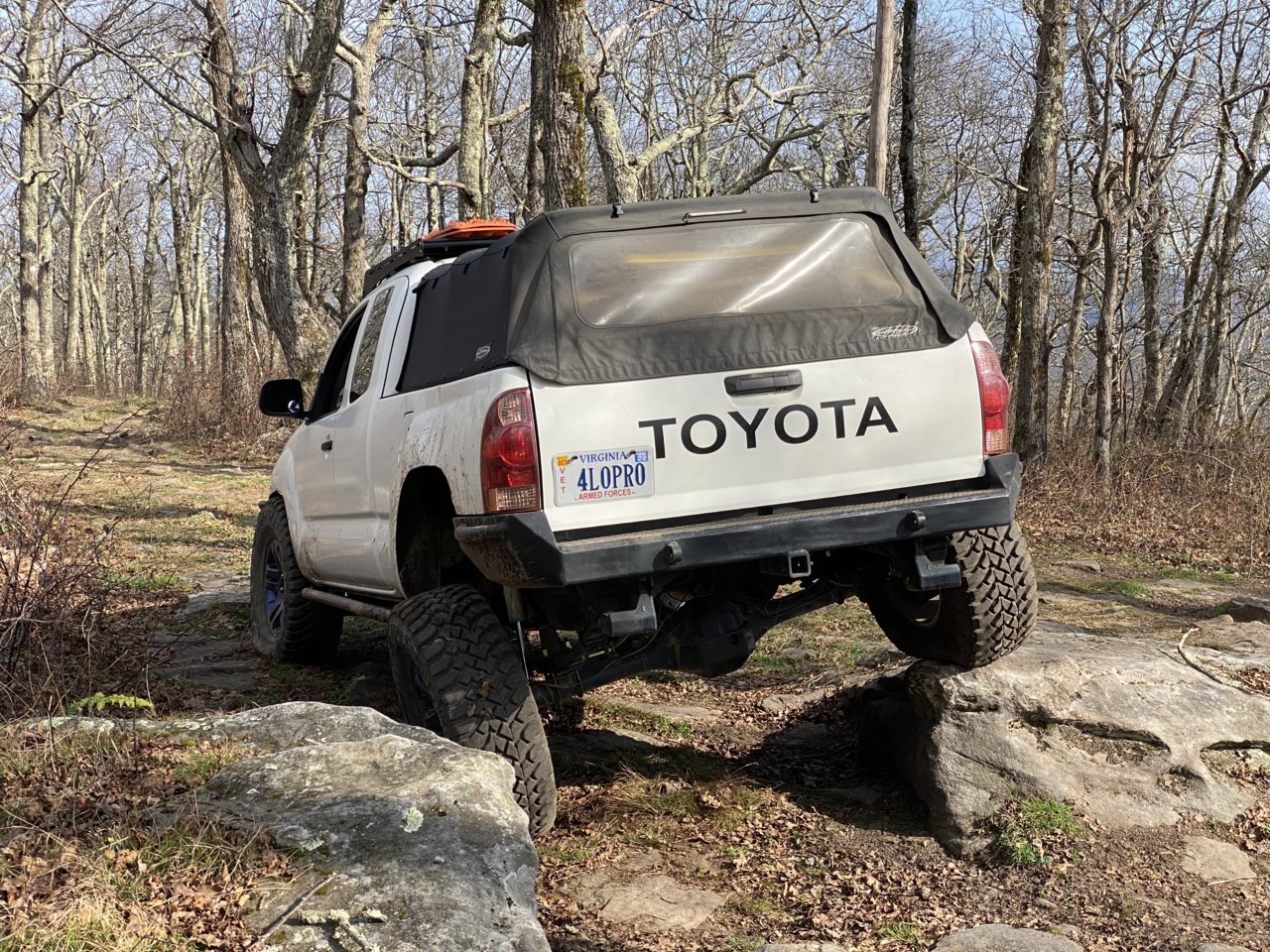

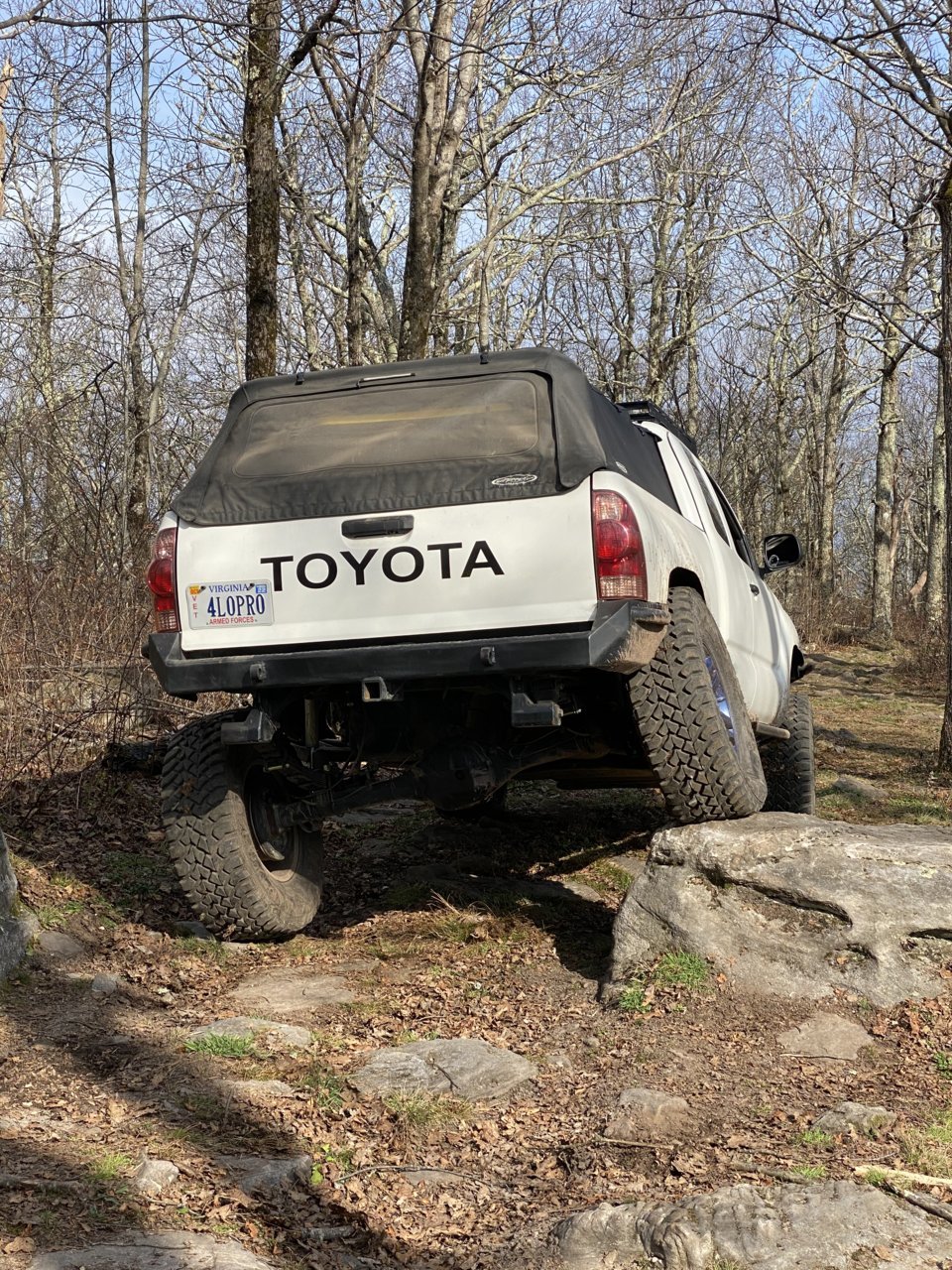

    I was leery of leaving the rubber bushings in for fear of losing some articulation due to their design vs poly bushings. I decided to go wheeling first and see how they do and then go from there. I have poly bushings in my shackles for reference.
    I went wheeling yesterday and no articulation trouble. Who knows how long the bushings will last because they’ll constantly be strained off-road, but for now they are fine. I’ll report back in the future if I switch to poly.
    This picture isn’t full droop (I still had slack on my limiting strap) but it’s still pretty ok.

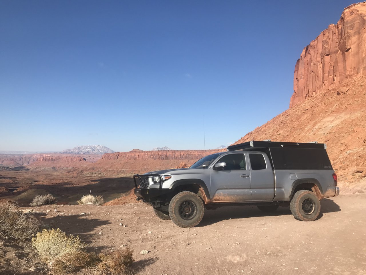

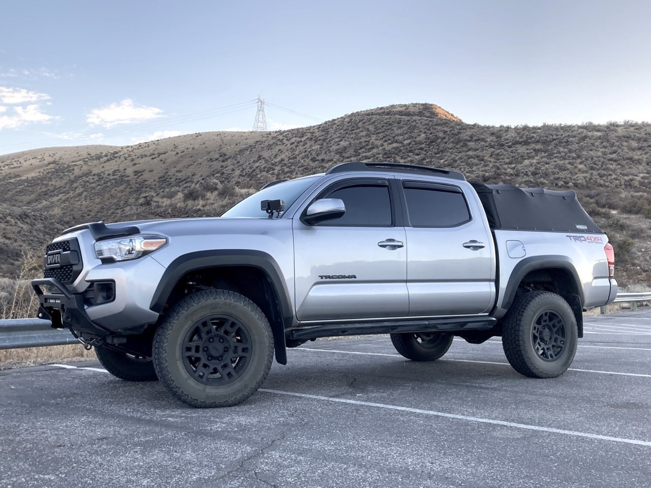

    I have my rxts on stage 1 with no aal
    With the go fast and I’m actually pleasantly suprised. Only really sags when I am loaded up with a weeks worth of gear.
    Definitly want to put it on stage 2 when I get a ubolt flip kit. And maybe some hammer hangers. What flip kits are people running and more importantly bump stop height in the rear?
    Pic of truck fully loaded with 9 days worth of gear and food and 20 gallons of water
