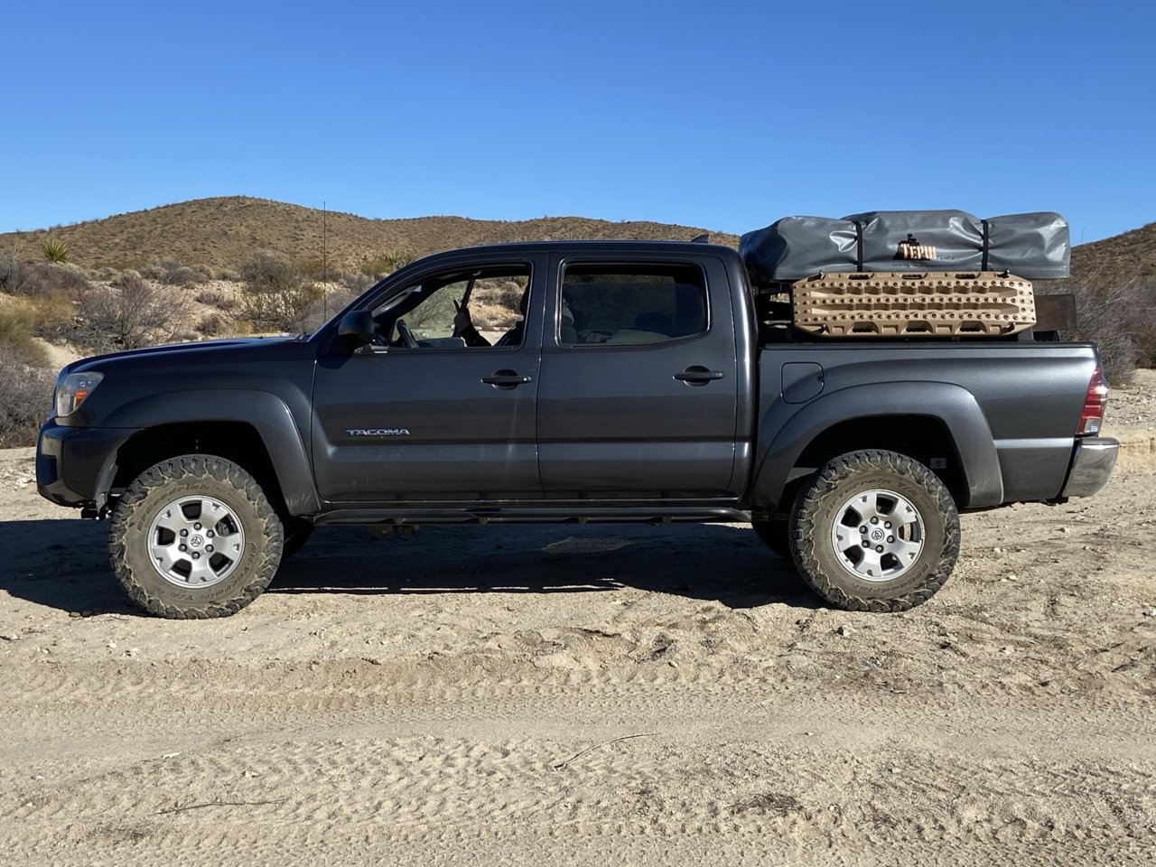

    600#? I’d suggest option 3
    Here’s about 400# on option 2 which levels out my 1.75” - 2” rake unloaded. Not even carrying water or fuel cans in this pic...a gear diet can be a good thing...

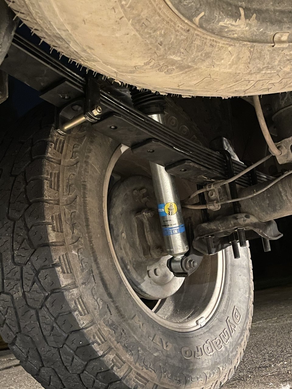

    Is that an assembly error or does that retainer really go there hanging down like that like a mini anchor?

    2011 Tacoma DCLB
    I’m not sure I understand what you mean by retainer?
