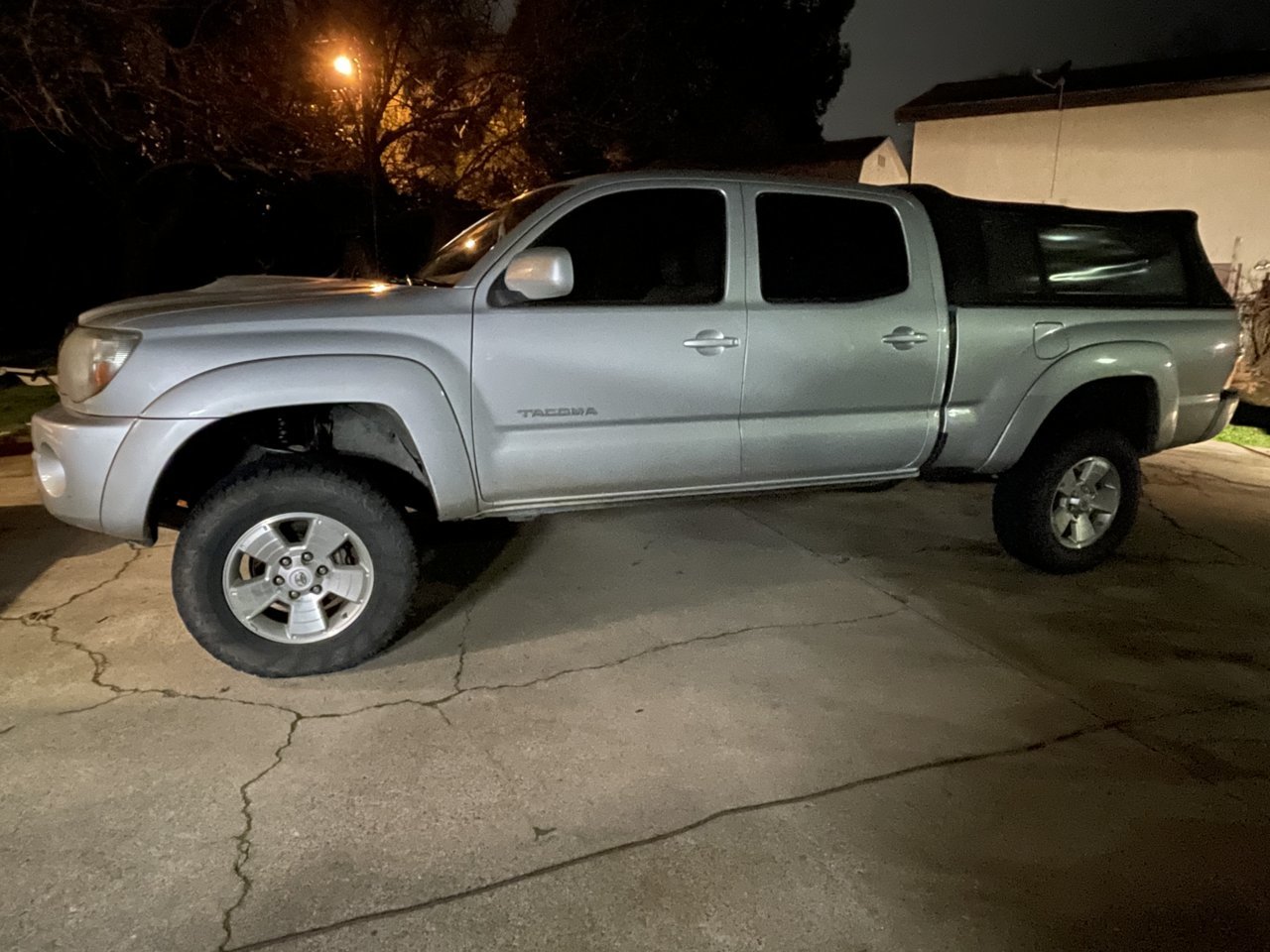

    Truck is done. Finished up the front end tonight. Took me and a buddy just over 3 hours. It drives so nice. Getting an alignment tomorrow. Truck sits with just a slight rake. Be interested to see where it settles.

    That’s how they’re supposed to be

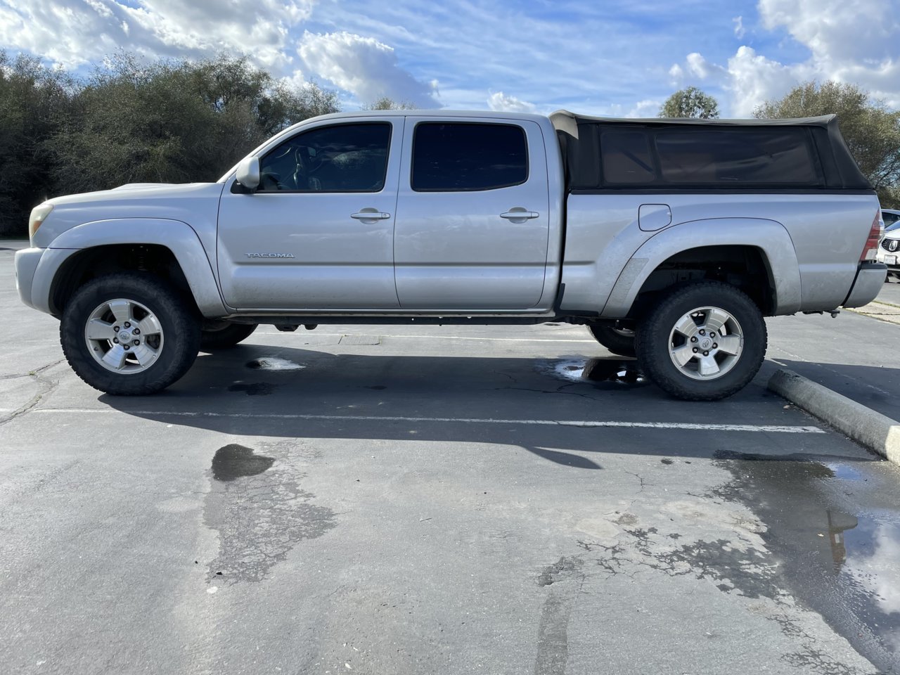

    For those that are wondering here is a better view of the stance and posture of the truck with Bilstein 5100’s all around set to 0, OME 885 coils up front and RXT leaf pack set to Option 2 there is no weight in the back of the truck right now. Stock UCA’s with a new alignment within spec.

    Looks good, you've got a decent amount of rake which is what I want. If you're not bottoming out your rear shocks using them with these leaf packs then I should be fine with my OME shocks as well. Worst case scenario I'll get some extended length shocks down the road.

    I’m not bottoming out the new Bilsteins. Everything feels good. I think some of the rake will settle in the coming weeks.
