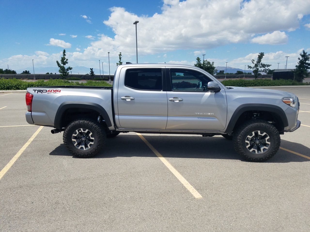

    I originally got 2" of lift out my RXT springs set at option 1. I believe they have settled a little bit, I will have to get an updated measurement. Once I install my skids and sliders I will be changing to option 2.
    Here is how my truck looked with 2" of lift front and rear.

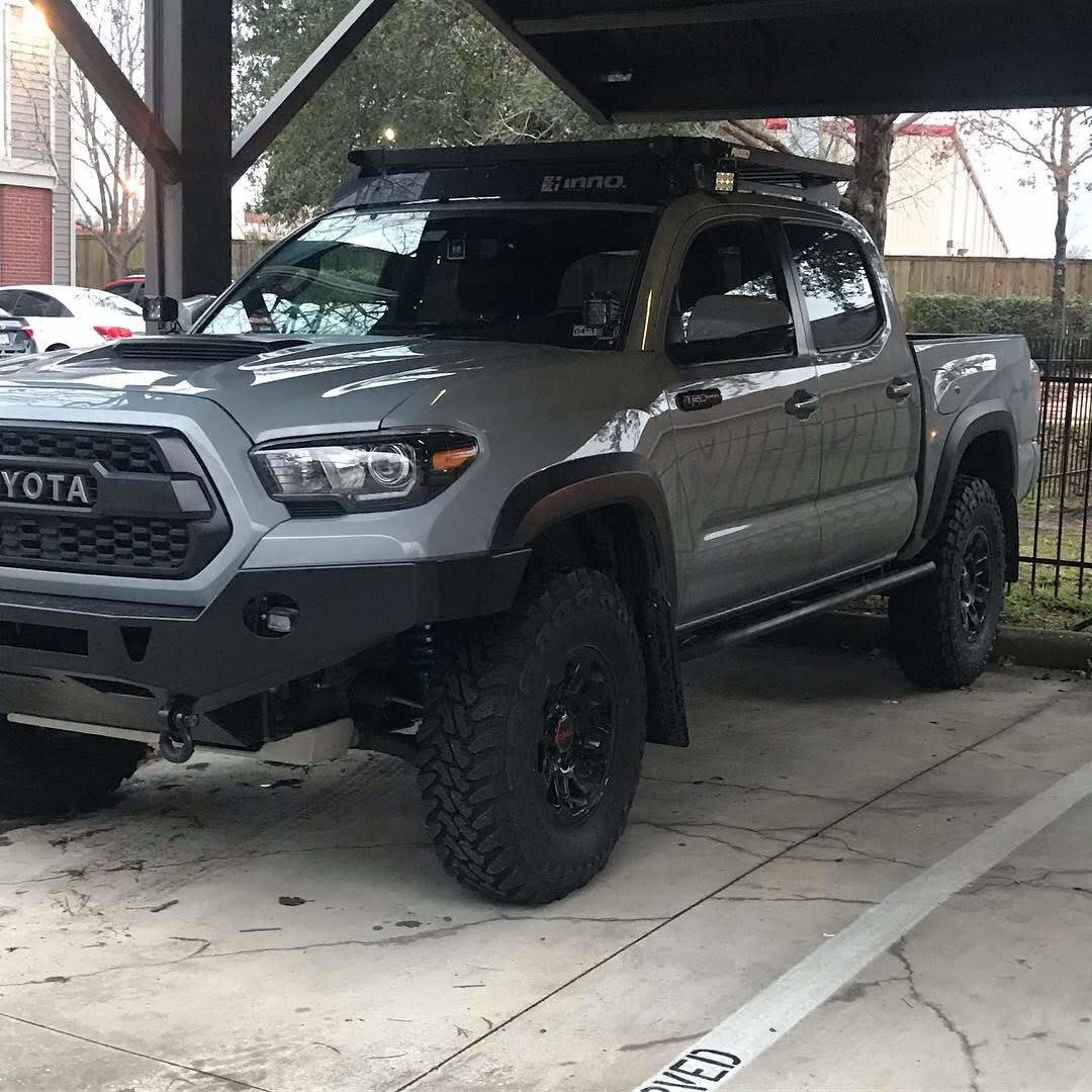

    This is option 1 with 2.5 Kings EXT on all 4 corners. No preload on the front.

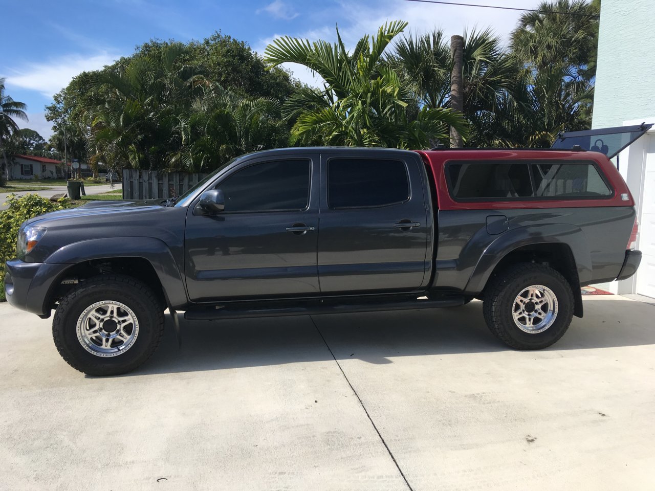

    2011 Tacoma DCLB TRD Sport 4x4
    Wet Okole, Maxxis Razor (285x70x17), Bilstein 6112, RXT's Fn 5star
    I went with option 2 and have aprox 330lbs constant with topper and tools in back. Rear hub to fender for me is 24”. Front is 22” hub to fender.
    I also run bilsteins 5125’s out back and they work pretty good with this leaf pack.

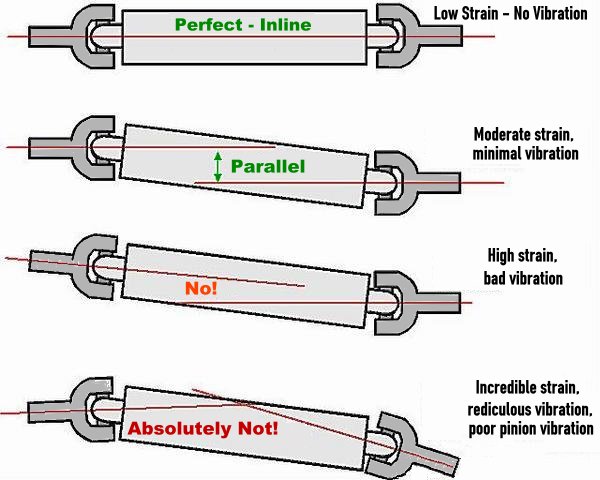

    You will need the same sized shim on both sides. After lifting your truck, the driveshaft angles become more extreme in relation to your rear differential. This corrects that, putting less strain on your u joint/differential yoke. I've read as a general rule for tacos you'll require 1° of shim for every inch you've raised your truck.

    It's more about mis-matched joint angles that lead to vibration, but yes, there is strain as well. When you lift it, the rear pinion rotates down a little more, and your upper joint is fixed, throwing the angles off. You want the plane of your front shaft (in a 2 piece shaft system) and your differential to be parallel in a double-u joint shaft to avoid vibration from the joint accelerating and decelerating at different rates at the 2 ends. A CV shaft doesn't require that, but we don't have CVs.
    Thanks man. Yep 265 75 16. Front are ADS w resi. coilovers. I have put some weight in the back, dont know exact weights. Probably 100 lbs +\~ and dropped about an inch.
