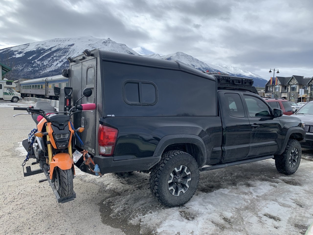

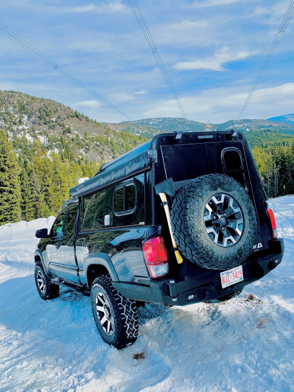

    Finished getting these installed tonight. My situation is a little different. I was originally running the Icon 3 leaf AAL and with the addition of the canopy and the single sided swing out and slide both on the drivers side I was sitting around 22" on the passenger side and 21ish" on the drivers in the back depending on fuel.
    The almost one inch difference was very noticeable (I don't have any great pictures of it though, but believe me, it stood out)
    So I went with stage 2 on the passenger side, and stage 3 on the driver. Currently sitting almost dead level at about 23 1/2" on both sides, hopefully it doesn't settle more than 1/2" which will still leave me with an inch of rake.

    Stage 3 on the drivers side, stage 2 on passenger.
    There’s probably another 2-3 hundred lbs in the bed.
    Grom is about 250 lbs
