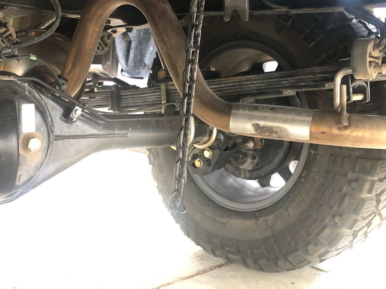

    With option 3, how many leaf's are there? Can someone post a pic of option 3, I wanna make sure my installer actually installed it correctly.

    Well not completely empty - there's a 50 lb Extang Encore tonneau there :laugh:
    8 leafs including a small one (about a foot long):
