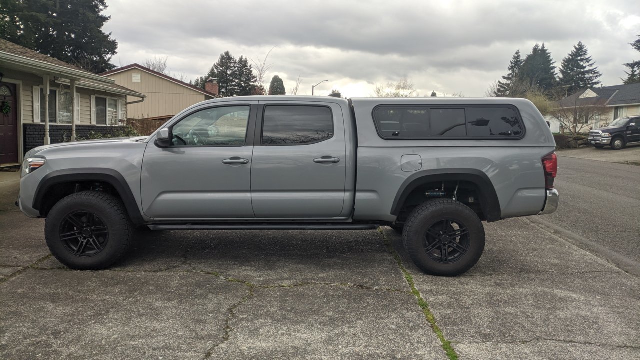

    So, I wanted to sanity check this before I get started. I have a RXT leaf pack that I'll be installing soon on my DCLB. I've got most of my weight installed already in the form of a snugtop canopy, sliders, tools, recovery gear, water storage etc. I drove across a scale the other day and it looks like my rear axle was at 2800lbs with a family day trip in the back. I suspect that was about as light as it will ever be in the back (from there we just add camping gear or firewood or whatever). I'm looking to be around 1.5" to 1.75" of lift after settling. I was planning on installing at option 2 and going up or down if needed after a month or so (obviously not taking the leafs off a second time would be ideal)
    If anybody sees a problem please speak up, otherwise I'll come back when I'm done with pictures and measurements.

    So, I installed my suspension and I'm hoping for a decent amount of settling. I went with option 2 because I've got a snugtop and keep a bunch of tools in the back. I stopped by a scale with a day trip loaded up (family, some firewood, light gear, basic tools) and had a 5900 truck weight with a 2800 rear axle. My initial install measurements took me from 20.25 hub to fender to 24.25 hub to fender. 4" was a bit more than I expected and looks a bit tall in the back. I wonder if the 4" measurement change is because I was a little saggy in the back before?
    I'm getting it all aligned and then will load it down and shake it down and hope for some decent settling. I haven't added any shims or done any trouble shooting, I'll let it break in and solve any problems as they come up. Also, I'd like to take a moment to curse the front leaf spring bolts, talk about a miserable bolt to break loose.

  13. Mar 25, 2021 at 7:43 PM
    #833
    PinStripes
    PinStripes Well-Known Member
    Oct 2, 2019
    #306884
    325
    Oregon
    2018 Cement OR DCLB

    Ha so I am also sitting at 24.25” in the rear after install...have you had any settling yet? Really only wanted 2.25” max

    Stock is typically 22'' hub to fender+/~. When I added my topper I dropped down to 20.5/ 21 ish on stock leafs, and would regularly hit the bumps. Rxt's on option 2 am sitting @ 24/24.25'' hub to fender. Difference being pass. to driver side. This is with the said topper as well as about 140lbs of tools constant in back. Technically you got exactly the lift you wanted. Good looking truck
