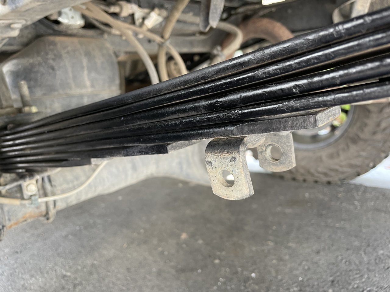

    So I had option 2 on for about two years and decided to move to option 3 because I added a topper, bigger tent, and rear swing out. I had a shop do the move from 2 to 3. When I picked up the truck I noticed the rear clip was not installed on both sides. They just threw them in my truck. When I noticed them on my seat I went out to see why they weren’t installed and it looks like they don’t fit anymore. The bolt does t line up with the hole.
    anyone else experience this after rocking option two for a while and switching to option 3?

    Should have installed the longer clip that came with them for stage 3

    Oh snap. Been so long I dont even remember it came with those. Thanks. I'll reach out to Icon.
