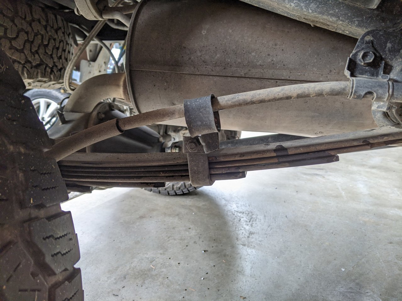

    Eibach 2.0 kit front and rear Icon rxt full leaf pack in rear JBA UCA
    Anyone running the rxt on option 1 with eibach shocks in the rear? Will extended break lines be necessary?
  19. Nov 1, 2021 at 2:45 PM
    #899
    tonered
    tonered bartheloni
    Sep 25, 2017
    #231055
    31,228
    tony
    Lynnwood, WA
    At full droop without shocks on Option 1, the brake lines are great. Plan for 2.75in more than stock (a bit of parallax in the pic):
    Just in case as the instructions were not great about the parking brake lines, this is what I did:
    Just a bit of reaming for the large bolt diameter.
    Texasblue_$3[QUOTED] likes this.
    Thanks for the confirmation with the break lines! Hopefully I can get closer to 2 inches as yours did out of the rear from option 1 also so it’ll sit level with the front and won’t be nose high
    Nice! Thanks for the confirmation I was a bit worried ha
