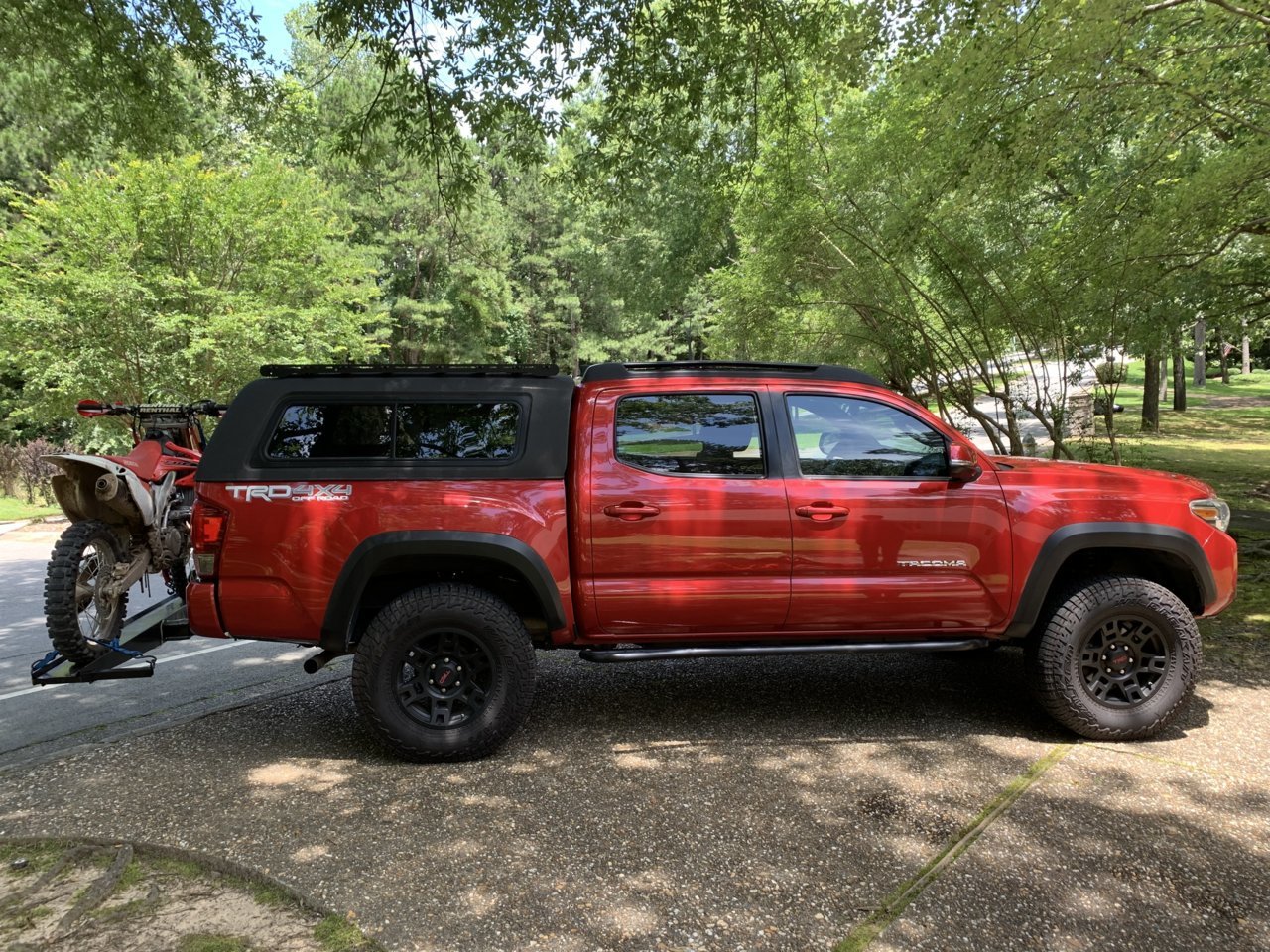

    So I'm about to throw these springs on my 3rd gen. I have the factory trd lift kit that lifts the front 2" and the rear 1" with a block. I'll be removing the block when the leaf pack goes in. Would option 3 be too much of a lift and cause any driveline issues? Camping load is usually around 150lbs but I also put a motorcycle on a hitch mounted carrier once in a while that weighs about 400lbs total.

    @ 150lbs option 1 is fine. I’d go option two so you’re still good with the bike

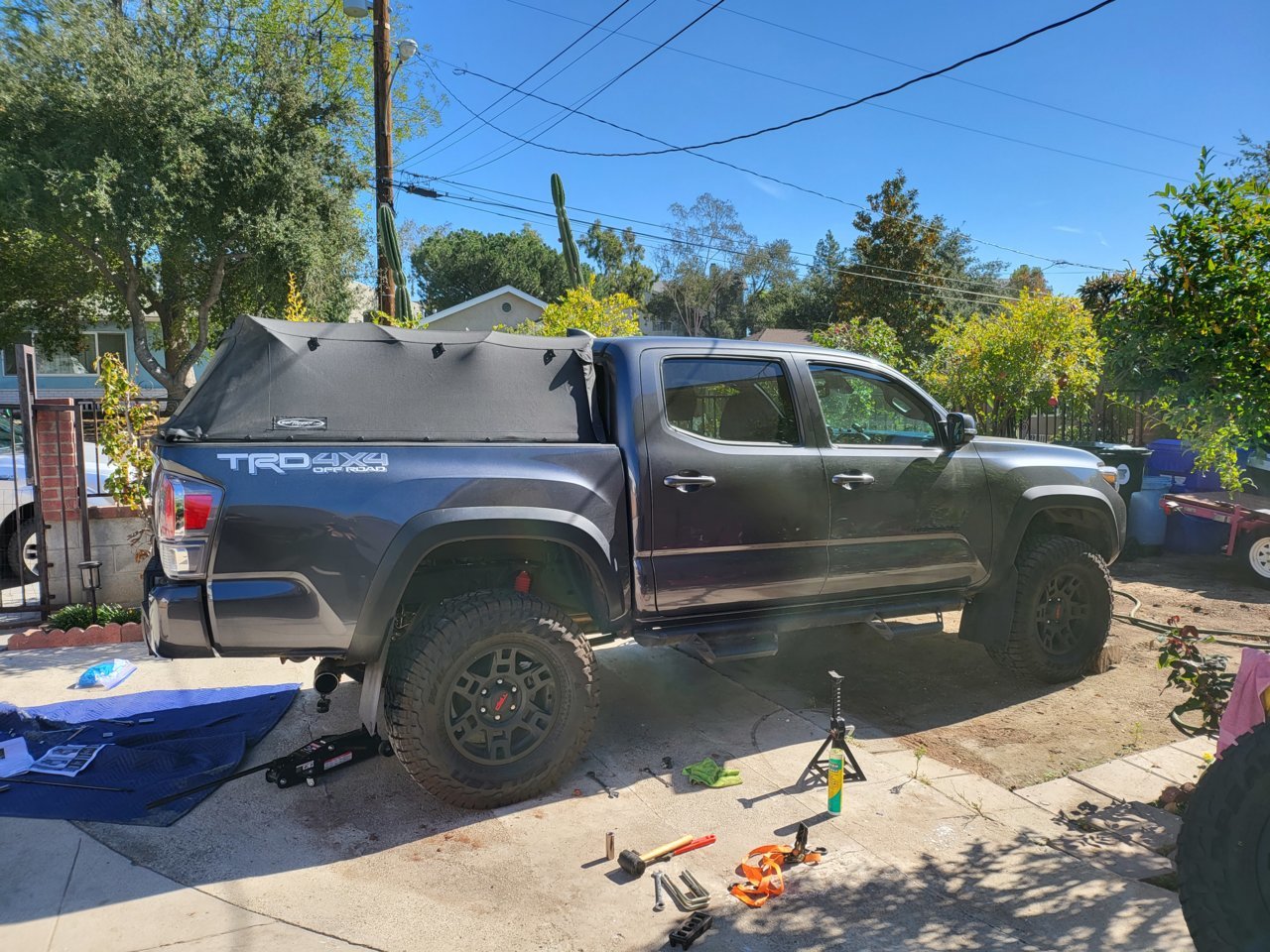

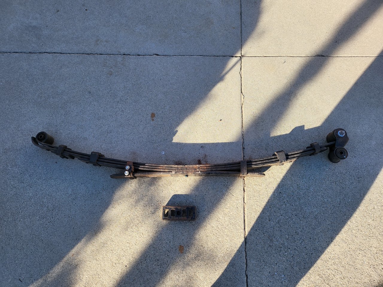

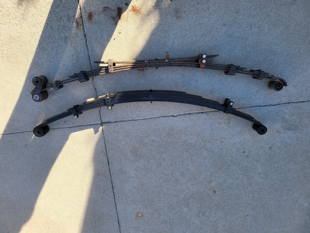

    Installed option 2 on my tacoma that came with the trd lift kit. Removed the 1 inch spacer that was on there.
    Before:
    After:
    Misc:

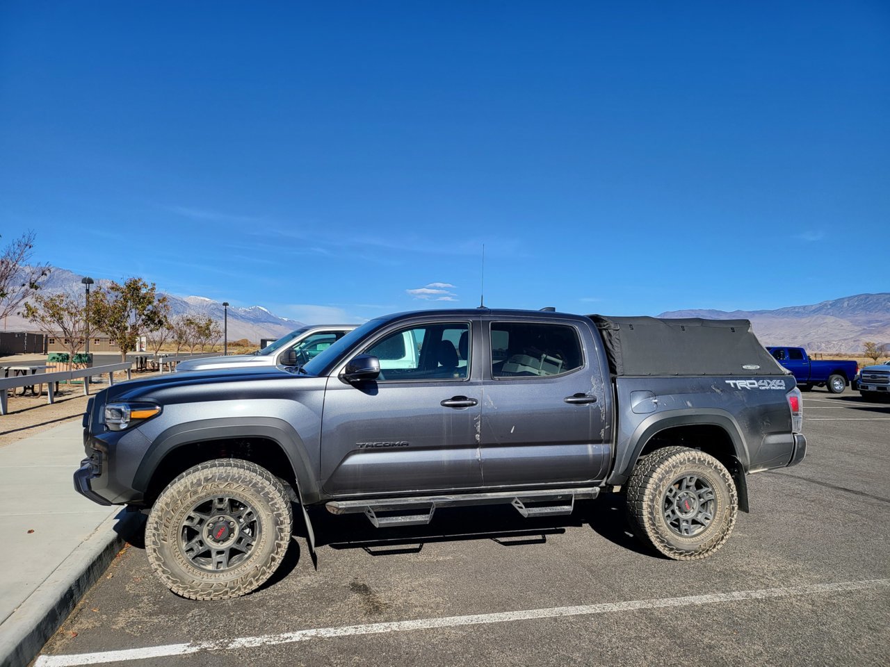

    After driving up to lone pine and through Alabama hills from Los angeles. Settled a bit already and I think it looks good.
