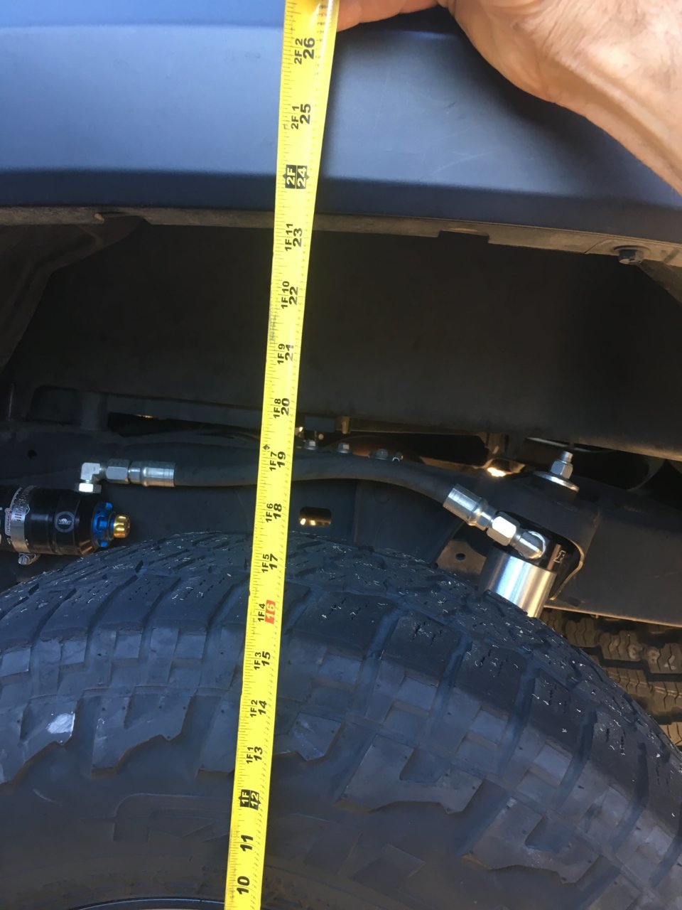

    I just installed stage 3 this weekend and went from 22.5" in the rear to 25". I have a snugtop topper and a RTT. But those numbers are without the tent at the moment. The ride is great though. Really happy with them for the money.
