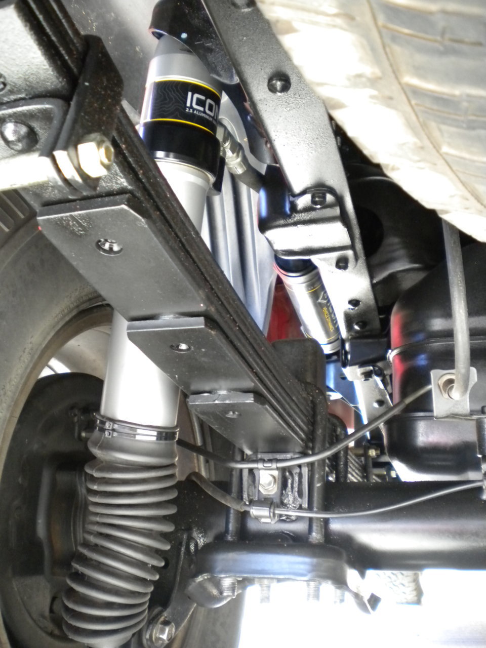

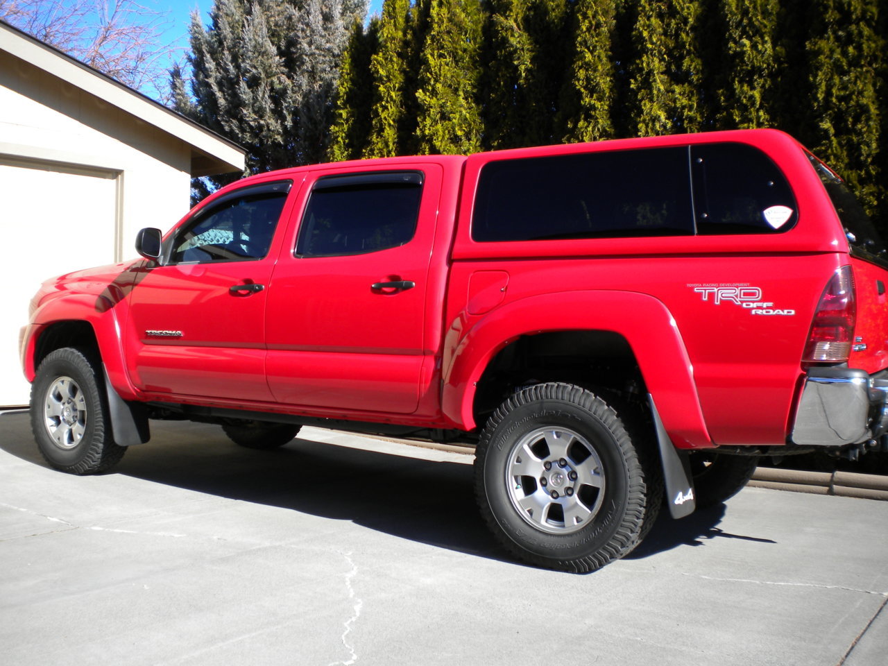

    Icon Stage 8, ECGS Bushing, Timbren ubolt flip, Crown extended brake lines, Overland Custom Design sway bar links, rear differential breather extension, oil filter drain hose, a/c drain hose extension & reroute, front windows tint, Cat Security, XPEL headlight/fog & grill protection, OEM block heater, RCBS illuminated 4X4 switch, Weathertech mats, Wet Okole seat covers, Sherpa Grand Teton/Crows Nest, Baja Designs S8 light bar, Diode Dynamics SS3 Pro fog lights, Piaa driving lights, Method 305 NV Double Black, 275/70/17 Toyo R/T Trail.
    Icon Stage 8/RXT leaf pack option 2... no vibes.DSCN0654.jpg DSCN0655.jpg DSCN0659.jpg

    My truck (picture in prior post) has a 2" lift front and the rxt leafs are option 2. The front hub to fender is 22" front and the rear is 24 3/8"... that's with the canopy/bed mat and around 150 lbs of tools etc in the back. With 200 lbs of sandbags it dropped the ass end around 1/2". Hope that helped.

    It's a SnugTop... maybe around 200lbs? Right now my front to rear difference is 2 3/8" but hoping once things settle it will go down a bit (i think factory rake is around 1 3/4".) Our numbers might be different... (2nd gen to 3rd.)
