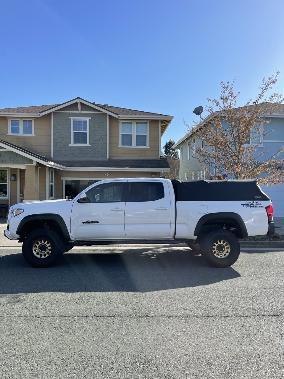

    I just installed as well. Yes they will settle a bit. I set it up for option 2 as well. Definitely the right choice for my needs. Love having rake when loaded. I see way to many leveled Tacomas :anonymous:
    I installed Thursday went on a trip on Friday. Loaded that bed up still had over an inch of rake :thumbsup:

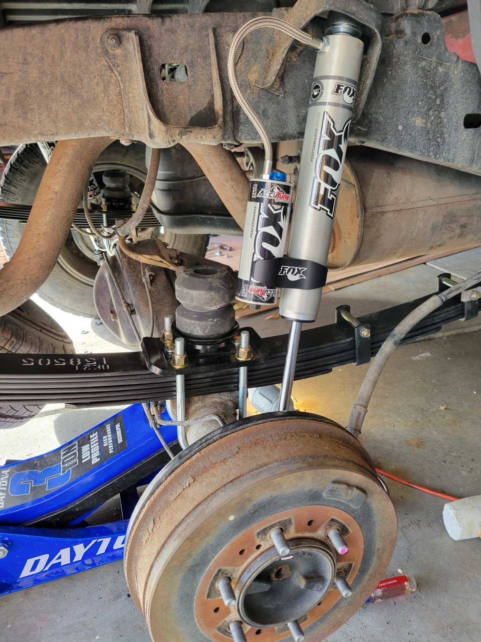

    I went with the Timbren Ublot flip kit (ABSTRFK) from ToyTech. I went with these because my Fox shocks with are about 1.2 inches longer at compression than stock shocks (also have about 1.5 in. more travel). Also they are a "softer" bump stop; since I don't have overload springs now I felt this was important. When compressed these Timbrens are about 1.2 inches taller than the stock bump stops so I don't have to worry about my new shock bottoming out. I would also look at Archive Garage ubolt flip - I would have gone with them except for the longer shocks. The ubolts came with the Timbren kit, I don't know their length.

    Option 2 (just insinstalled ) with about 220 pounds in the rear I am 24.5 inches ceneter of wheel to bottom of fender. I do think in the day & 1/2 they have been on and now driven on they have already settled a little. I will try to remember to update in a few months.

    Its about 2.5 inches, which means I have about 4.75 inches of up travel/compression - these Timbren bumpstops compress about 2&1/4 inches if I remeber correcty.
    If you are wanting a little more uptravel (compression) look at Archive Garage - They have an option for a Timbren bumpstop and I think the pedistal that they mount to is a little lower so you will get little more up travel/compression.
    I am good because my Fox shocks 985-26-118 have a compression length about 1.2 inches longer that stock/factory shocks(15.2inches). Since I am going with 34x11 inch tires (about 3.3 inches bigger) that have a radius about 1.7 inches bigger I wanted to make sure the tires would not rub at full stuff/compression. So the additional hieght on the bumpstop, which is about 1.2 inches, works perfect for me.
    I measure my old OEM Bilstien shocks and they are about 14 inches compressed and 23&1/4 inches at full extension.
