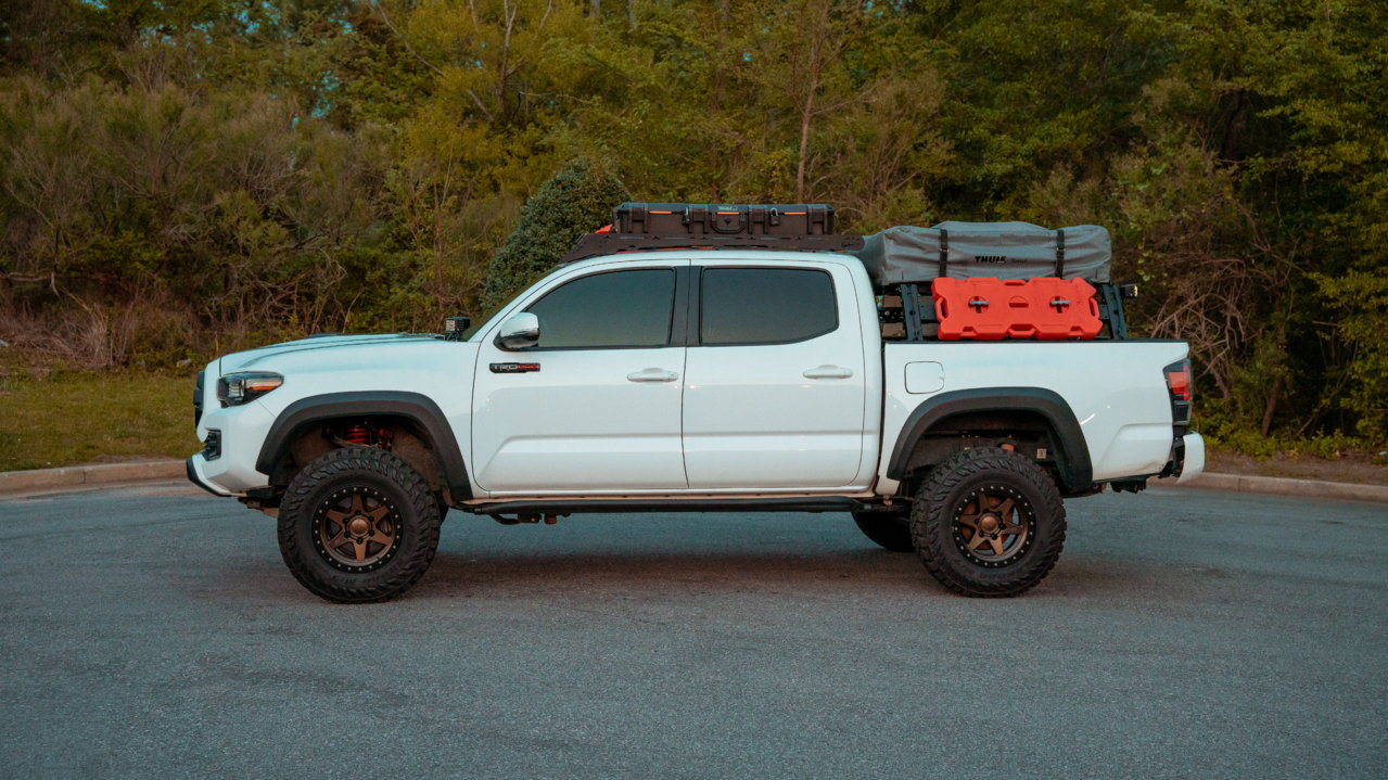

    So I read through the thread looking for anyone with the option 3 and I don't recall finding any. I'm running this setup daily because I don't have a garage or anywhere to store the rack or tent. I also have a work vehicle so I don't drive it daily so the weight doesn't really bother me since I don't commute.
    This is a westcott setup on the front, running option 3 in the rear. I was concerned about the weight in combination with the roof rack, rock sliders, bed rack, stuff in the bed that usually stays there, RTT. With everyone saying they settle I didn't want to chance option 2 settling and then being uneven or lower than the front.
    Option 3 does have a slight bit of rake, but it doesn't look bad in my opinion. I would prefer it to be level, but I suppose with time and riding around with constant weight it might have ended up uneven being lower in the back.

  13. Apr 12, 2022 at 6:27 PM

    71tattooguy
    71tattooguy Well-Known Member
    Dec 19, 2018
    #276275
    5,880
    Dino
    Petaluma , Ca (707)
    2019 DCLB TRD OFF- ROAD
    Kings 2.5” front and rears from Accutune / ICON RXT LEAF PACK black badges doors and tailgate / method 315 / 255/85/16 Yokohama G003 / magnaflow exhaust , axle dump / meso int delete kit / meso led map lights / dome lights / wheelers front super bumps / accutune Flip kit with spacer and new bumps / Cali raised fog light pods / Cali raised ditch lights / RCI FULL SKIDS / SLIDERS / RCI rear bumper / rigid backup lights / tuned on 4.88’s
    Looks great

    i’ll be moving up to option 3 tomorrow. currently on 2 but started to sag a little bit and gonna add more stuff down the road. hopefully it still has some rake!

    How long did it take them to settle down a little bit? I read a few people say option 2 settled a little lower than they’d like which is why I went for 3

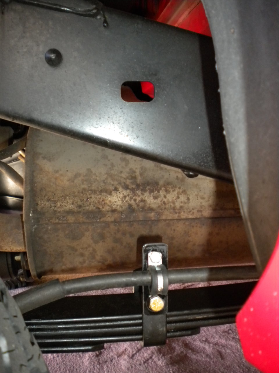

    Yeah. It is good to flip the nuts and bolts, esp on the fuel tank side. I've seen a pack or AAL (I can't remember which one, not Icon) gouge the tank.
    This was my solution as the rear section of the brake line needed the guide to not rub. Just ream out the hole in the guide and attached it to the leaf keeper. I used channel locks to bend the guide to match the angle.

    yeah don’t go option 3 if you on have a tonneau cover. My rear is probably an inch higher and I have probably 300lbs combined in the rear.
