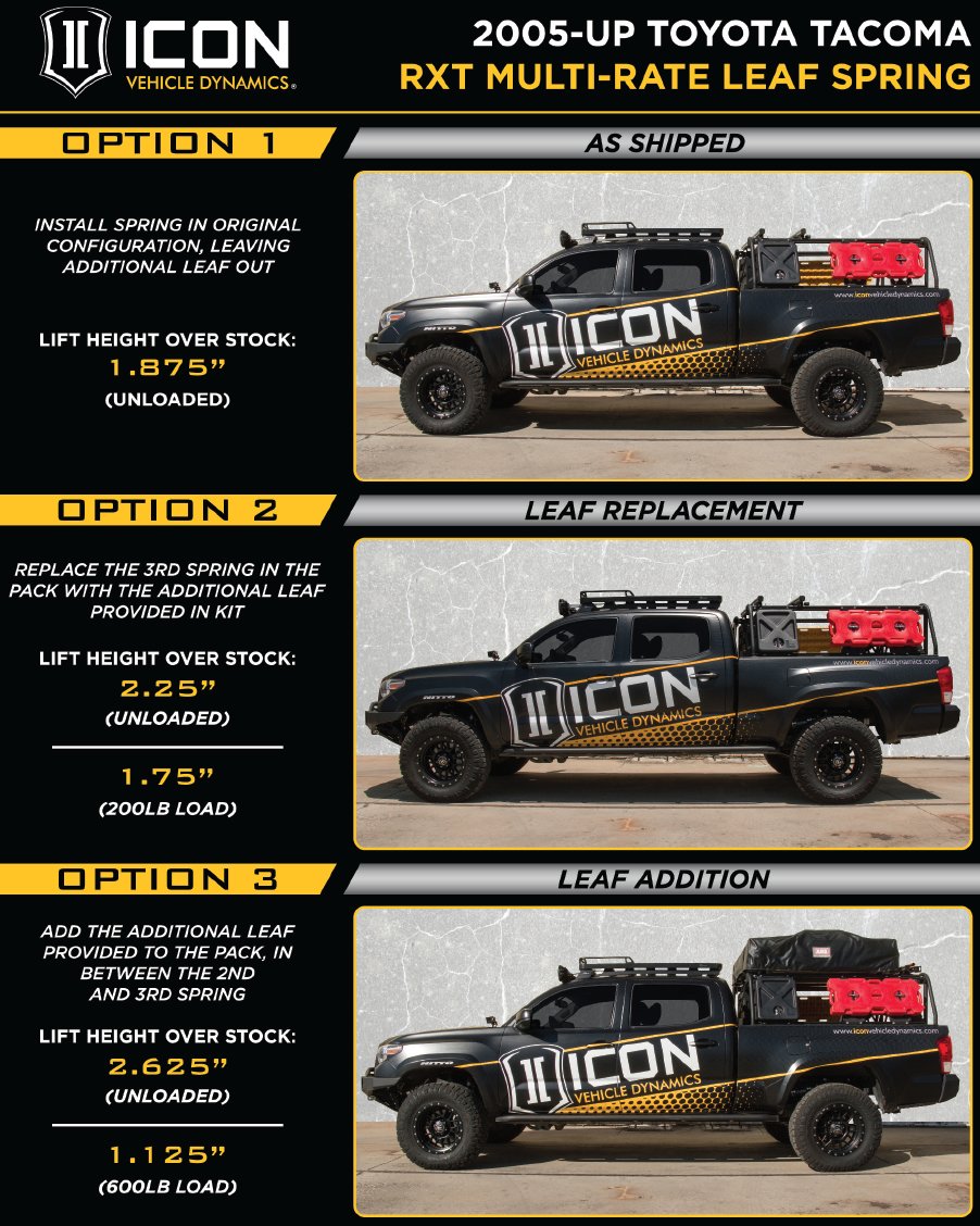

    The list is long but distinguished

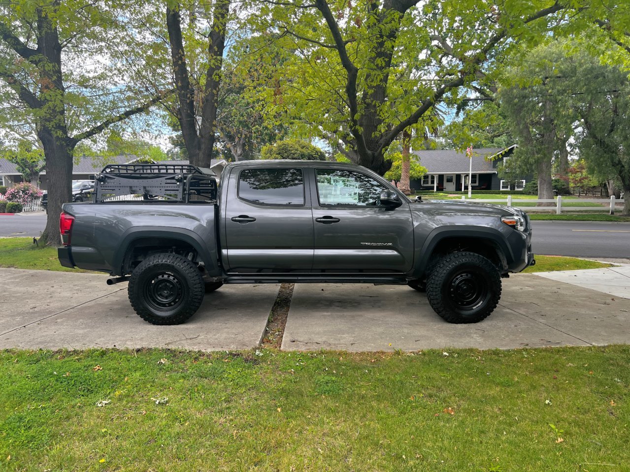

    About a year for the Option 2 to settle on my truck. I did about 5 trips in that time period and a full load out is probably more than option 2 is rated for. With a BAMF rack I'm sitting about level. Will probably go to option 3 before the next trip and see how it goes.

    did you use axle or carrier bearing shims?

    Axle

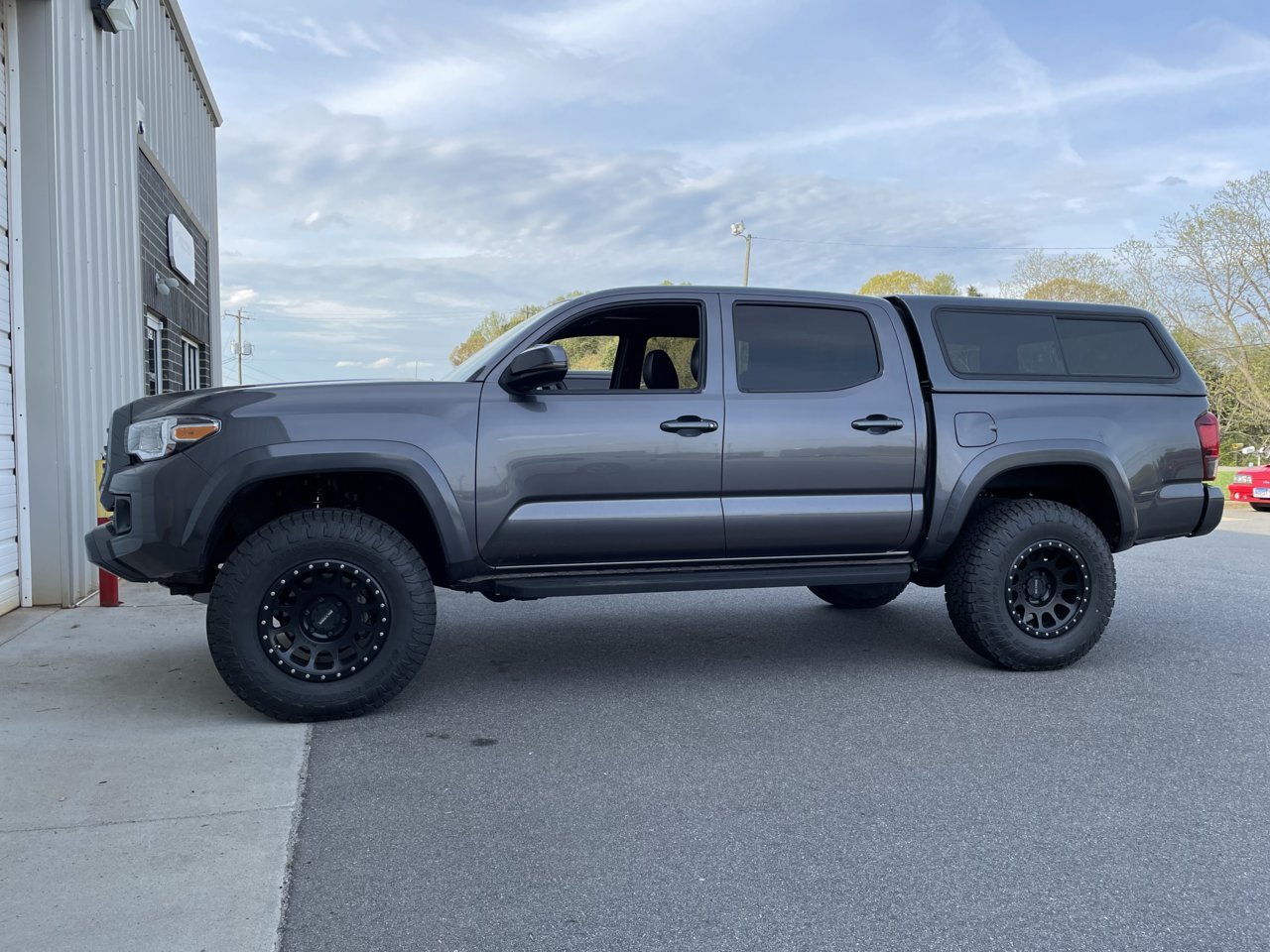

    Installed last week and loving them so far. Option 1 with 5125’s, archive ubolt flip/bumps, and wheelers +2” brake lines. Fronts are 6112’s set at 4/507637266-BDFC-4BDC-BE22-46CFB9B1C32E.jpg

    I went with option 2 and 5160s and I am right at 24" hub to fender on my DCLB. Stock is 22" so I got 2" on option 2. I tow a trailer with a 430 lb tongue weight and with about 120 lbs of additional weight in the bed(5 gal gas, 5 gal water, large tote of firewood, and a shovel) it sags about 1" Rides great when completely empty.
