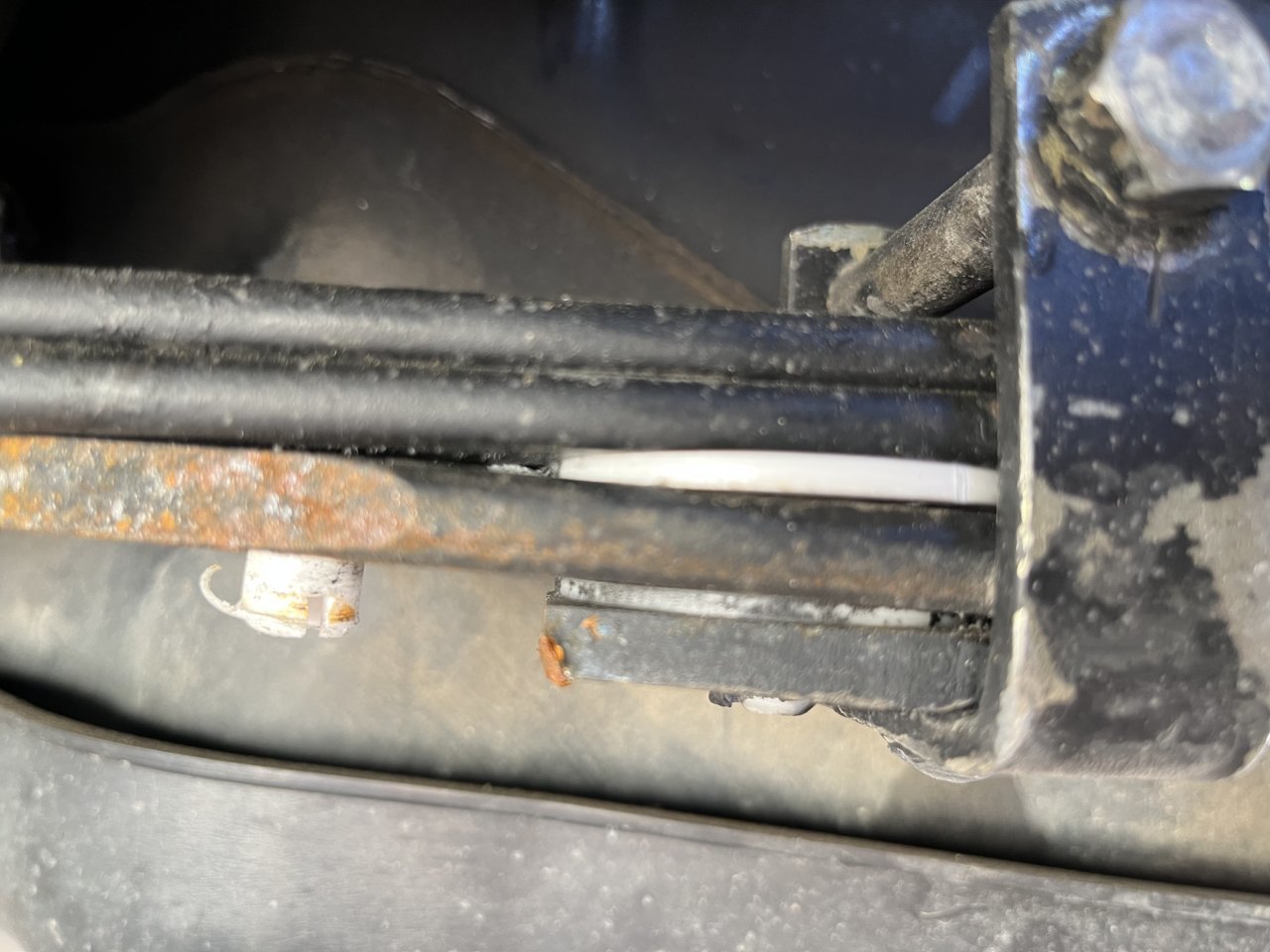

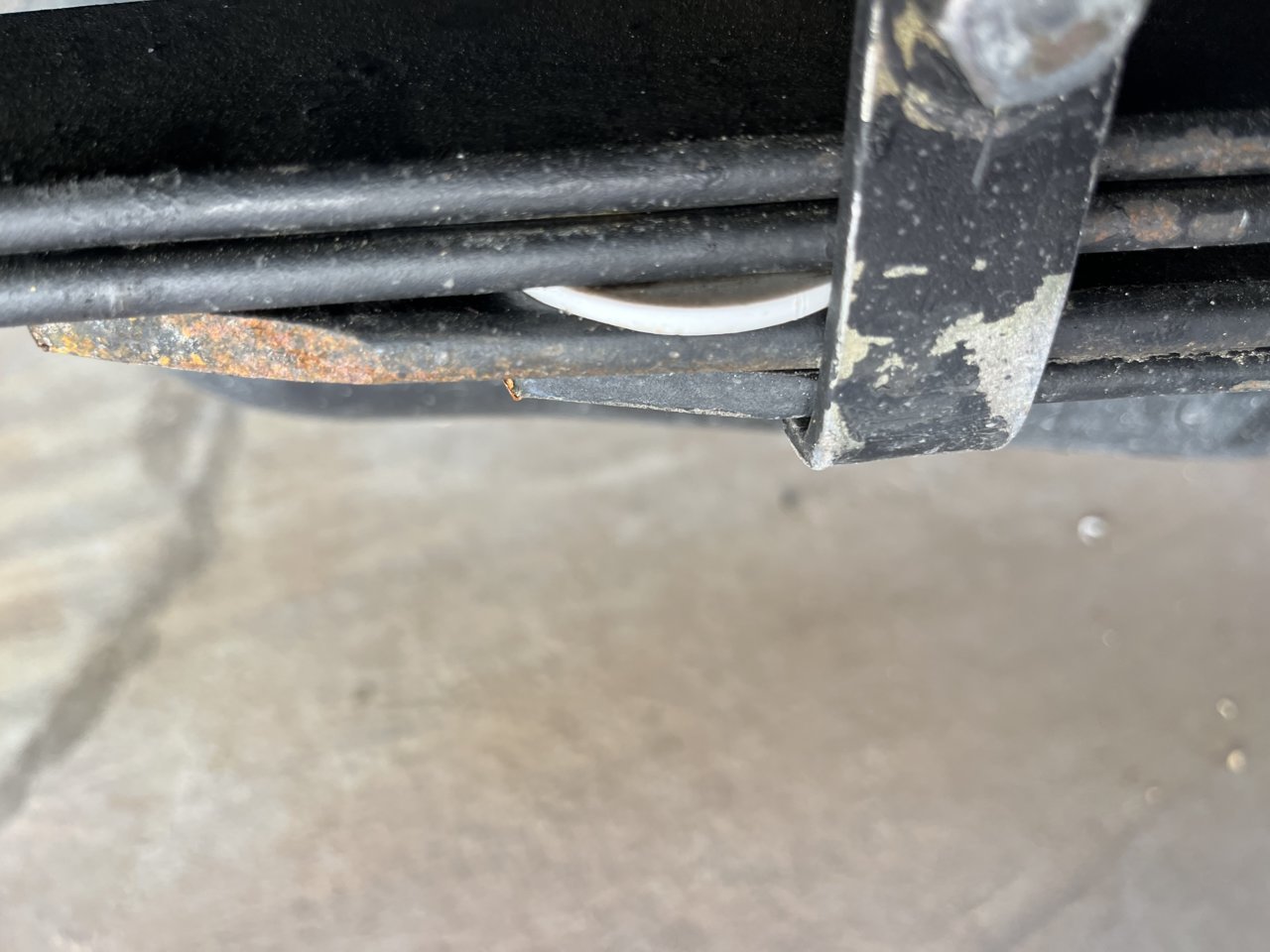

    Anyone have the pads break off?

    SOLD - 05 Dub Cab TRD Sport 4x4, CURRENT - '21 Tundra MGM Limited
    Sure did!
