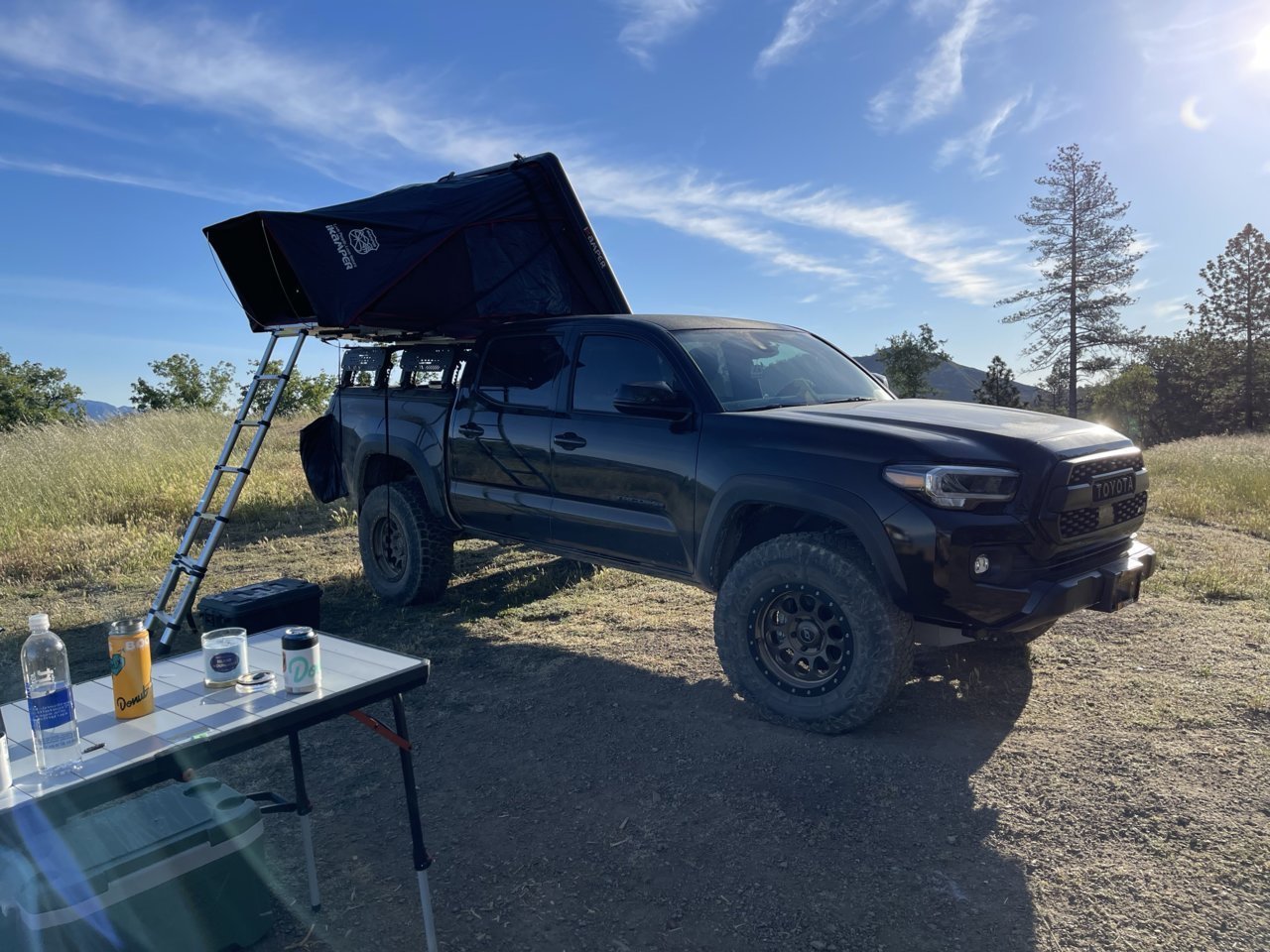

    Here is a pic from the trip to give you a visual. Granted a lot of the heavier camping supplies are removed from the bed in this pic, but should give you a good idea.

    LeFreakyBone I know you said a page or two back you were running Fox 2.5's up front. What lift do you have them set for and what sort of rake, if any maybe it is level, do you have as pictured in this photo?

    The Fox 2.5s were installed as they came. I wanted to get them on and let the springs settle before I made any adjustments. I definitely have some rake. Now that it’s been a few months I’ll probably adjust the fronts to level it out a bit.

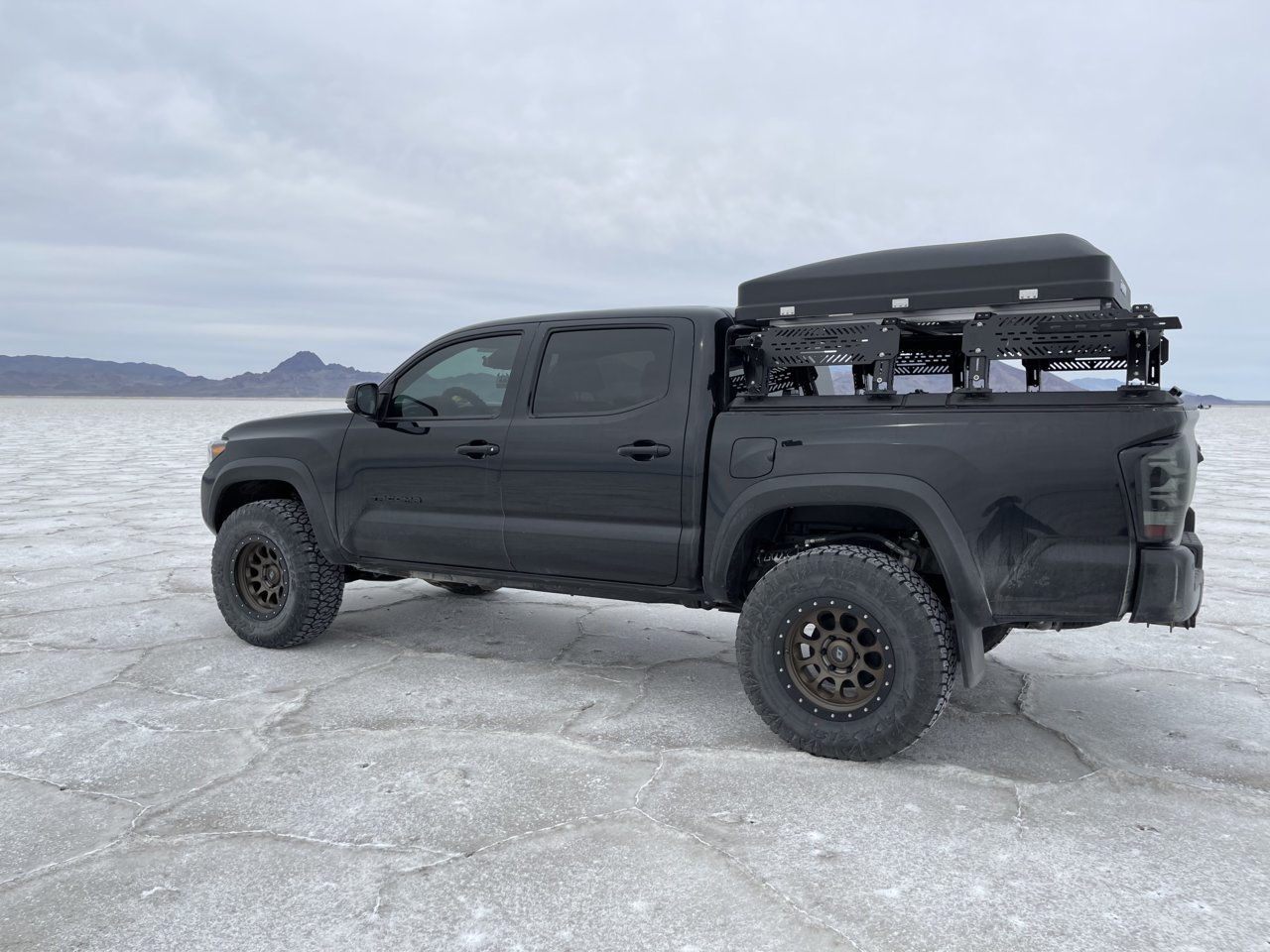

    Found another pic that might show it better. This was on a solo trip, but loaded up with a bike, snowboard, and camping gear.

    Oh wow, it appears to have a fair amount of rake. 2+ inches? Or is it the picture angle?

    I think the picture angle exaggerates it a bit, but there is definitely a good amount of rake. I measured at the frame rail in the front and rear a while back and I think it was about a 3/4" difference.
