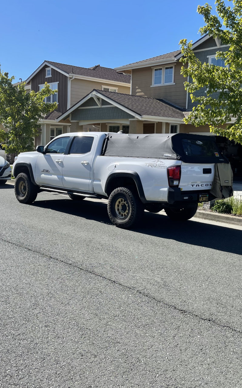

    loaded down camp gear option #2 still have rake :rasta::thumbsup:

    Has lockers a skewp and a bit of droop
    Needed at option 2 for my truck.

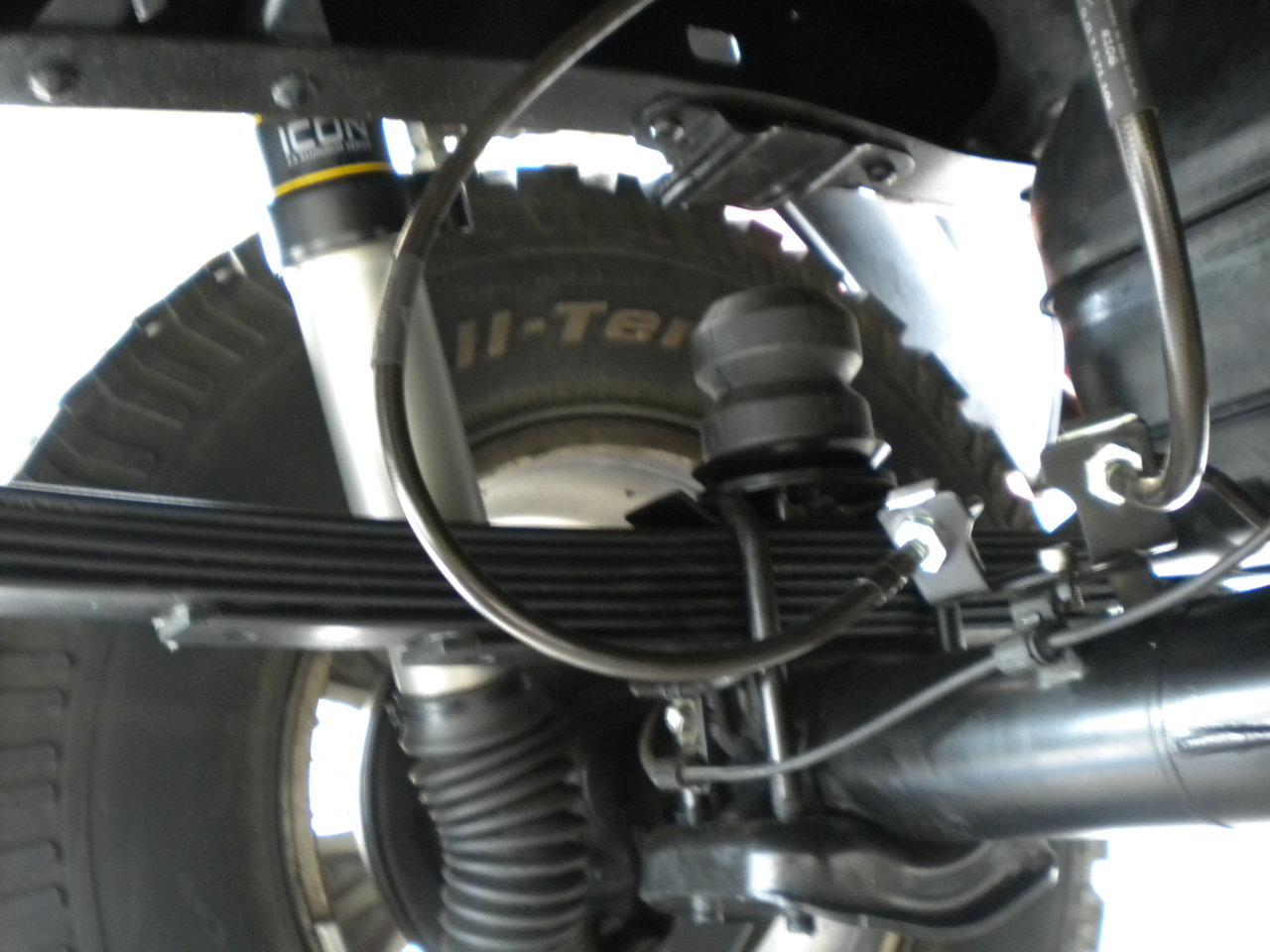

    Icon Stage 8, ECGS Bushing, Timbren ubolt flip, Crown extended brake lines, Overland Custom Design sway bar links, rear differential breather extension, oil filter drain hose, a/c drain hose extension & reroute, front windows tint, Cat Security, XPEL headlight/fog & grill protection, OEM block heater, RCBS illuminated 4X4 switch, Weathertech mats, Wet Okole seat covers, Sherpa Grand Teton/Crows Nest, Baja Designs S8 light bar, Diode Dynamics SS3 Pro fog lights, Piaa driving lights, Method 305 NV Double Black, 275/70/17 Toyo R/T Trail.
    RXT option 2... went with Crown extended lines. Got them from Headstrong Offroad as a package for the Tacoma (1" extended fronts/4" extended rears.) They come standard smoke color.

    If I am following along correctly you plan to have 200lbs of static load. Option 3 will put you somewhere in the 2-2.5" of rear lift with that amount of weight. Assuming you want a level truck you would need to have the front lifted 3". If you want OEM rake you'd only need 2" up front. 600lbs at option 3 is 1.125" - different than the 1.875" than you referenced. Long story short an unladen Option 3 truck is going to ride a little stiff in the rear. Even 200lbs will begin to engage the leaf pack so you should be just fine to set it and forget it there.

    Is the installation of extended brake lines a pain? Does it not require flushing the system? I have Wheeler's +4" but never needed them for option 1.

    You'll need to bleed the brakes after the extended lines. Is it fun? Never. Is it difficult? No, especially if you have another person with you to pump the brakes (no pun intended).

    I have not experienced any difference in ride quality. You're also driving a truck that's rather rugged and not a grand marquis so I'm not too sure what people's ride comfort expectations are when buying a tacoma to begin with.
    Additionally, I do not have extended brake lines and I'm running the standard trd pro fox suspension with westcott fronts and option 3 rear. No problems here and my rear brake lines are not tight or stressed. Again, cannot speak for people using other suspension systems.

    In case anyone is curious, an option 3 RXT should be roughly 2.75" thick. I measured option 1 at about 2.25" and the extra leaf is a little under 3/8". I was looking for new round u-bolts and settled on some that were 7.5" in length from Rough Country. With a 3.25" axle diameter, I should be covered...guess we'll find out.

    This may not work for everyone but I gravity bled the rear lines and got all the air out. Brakes are firm as before the extended lines and only took 1 min per side

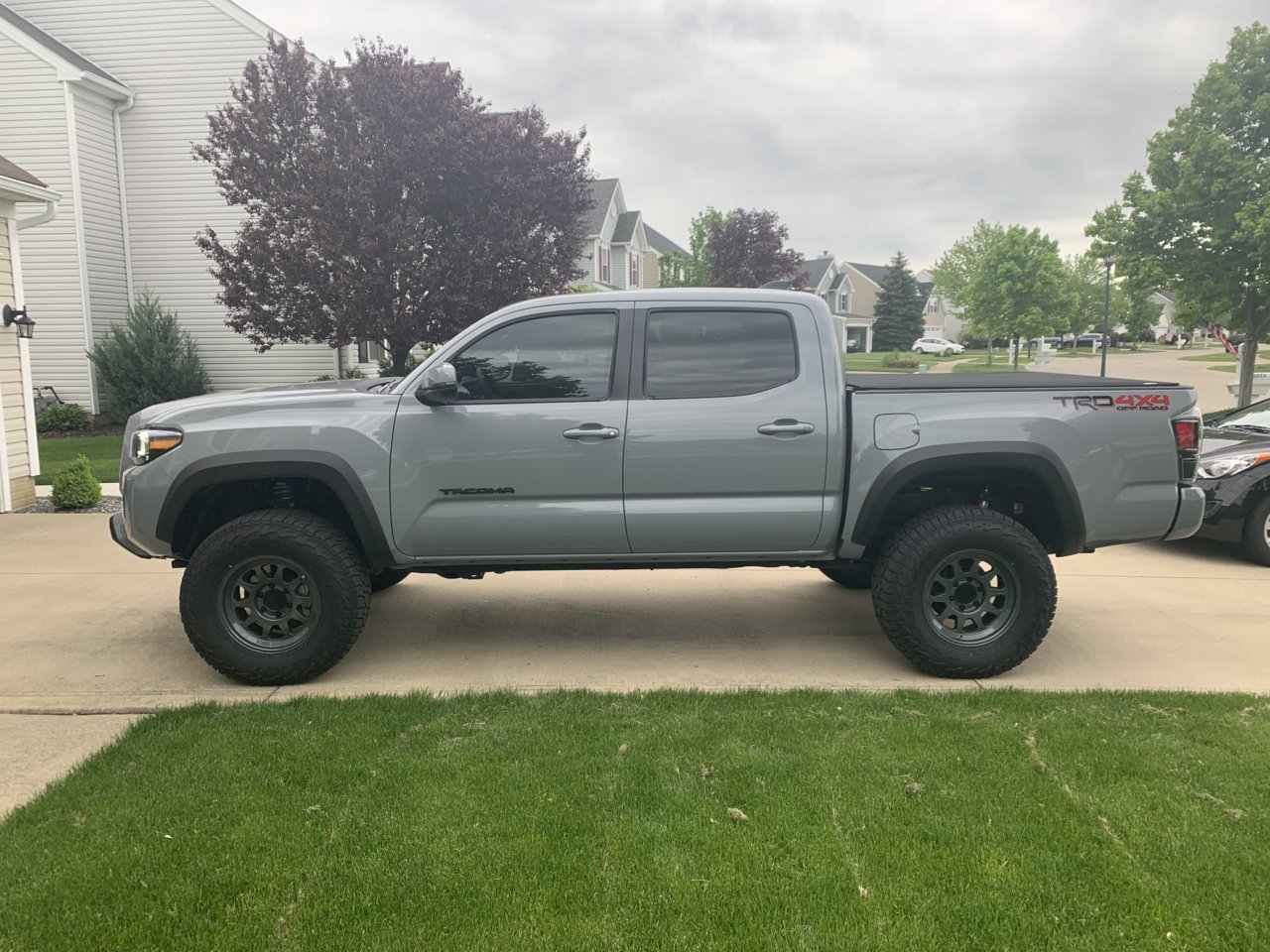

    Option 2 installed. I’m kind of thinking I should have went with option 1 since I don’t usually carry much weight. Just eyeballing, does the height/stance look alright?

  14. May 18, 2022 at 6:37 PM

    Your stance looks primo :thumbsup:

    Stance looks great having a little rake is the way a truck should look :thumbsup:

    Yes. That's the good look of a truck on a quality lift.
