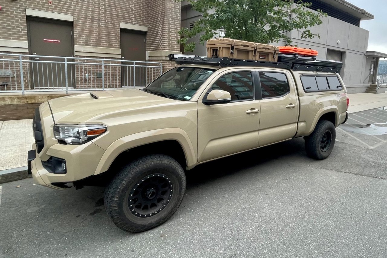

    option #3 thats what i run and its great

    you got any photos of your rig?

    how much weight do you keep in the bed/over the bed?

    Dont have exact numbers, but my full size spare, HD ARE shell, 65L Yeti, RTT, and random tools are always on my truck

    got it. so not much weight. do you have hub to fender measurements?
    I set the springs up on option 2 over the weekend. Im having them installed this week. i figure its no big deal to add a leaf to it when the smart cap arrives

    No I don't on hand, it sits level as far as I can tell and rides smooth, doesn't bounce around
