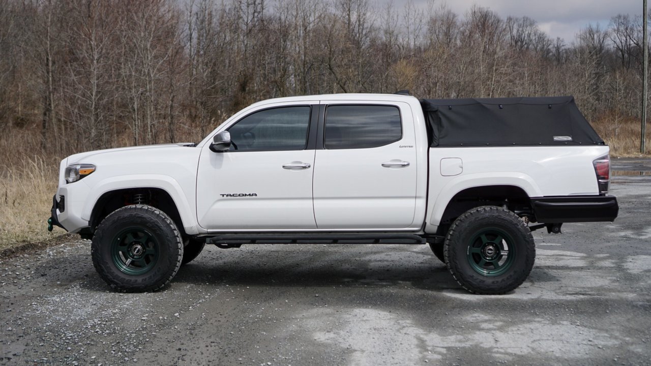

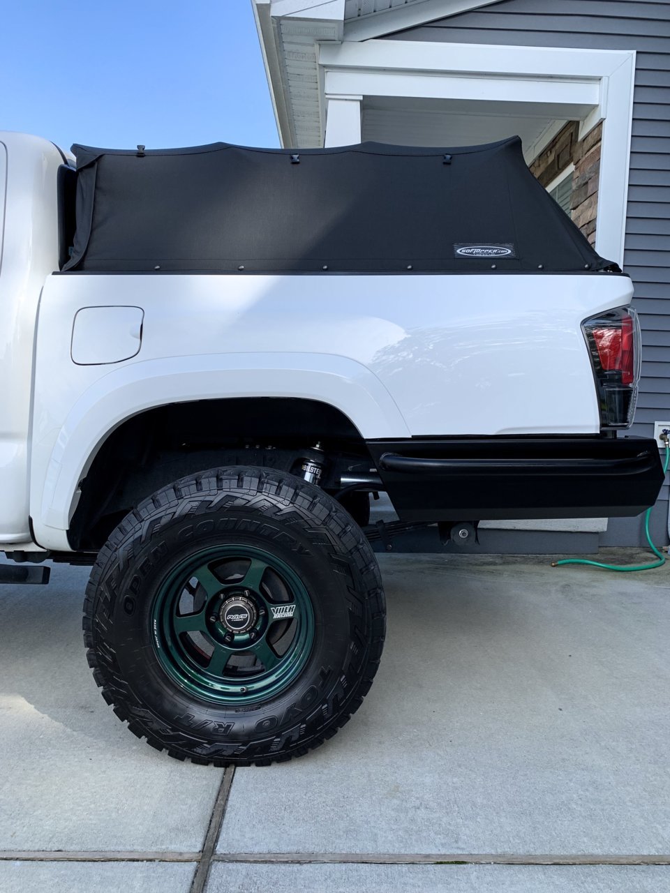

    Bilstein 8112/8100, JBA UCAs, Icon RXT leaf pack, work wheels 17x8.5;-10os, 285/75/17 cooper LTX AT3, Mobtown HC rear bumper and Sliders, SSO front bumper, BAMF greceased grill.
    For those wondering this is option 3 for the icon RXts paired with Bilstein bypass 8100s and 6112 6/5 clip for 2” lift with slimline bumper and mobtown rock sliders.
    About 225-250lbs in the rear including bumper and tools and other BS in the bed. RXTs don’t squeak and have no issues for the past year I have no shims and no diff drops of any sort and no vibes. Ecgs mod was done.

    #133
    SpeySquatch
    SpeySquatch Function over Form
    Mar 6, 2018
    #246516
    7,366
    2016 TRD OR DCSB
    C4Fab LoPro, BAMF Sliders, Ext ADS 2.5’s, 4.88's, OVTune (OG to KDMax)
    Looks great man +1 on the softopper

    what bumper is that?
  18. Mar 21, 2019 at 11:05 AM
    #138
    oscolivar1
    oscolivar1 Well-Known Member
    Oct 30, 2013
    #115568
    2,267
    Oliver
    VA
    2017 Tacoma Limited
    Mobtown off-road HC bumper.
