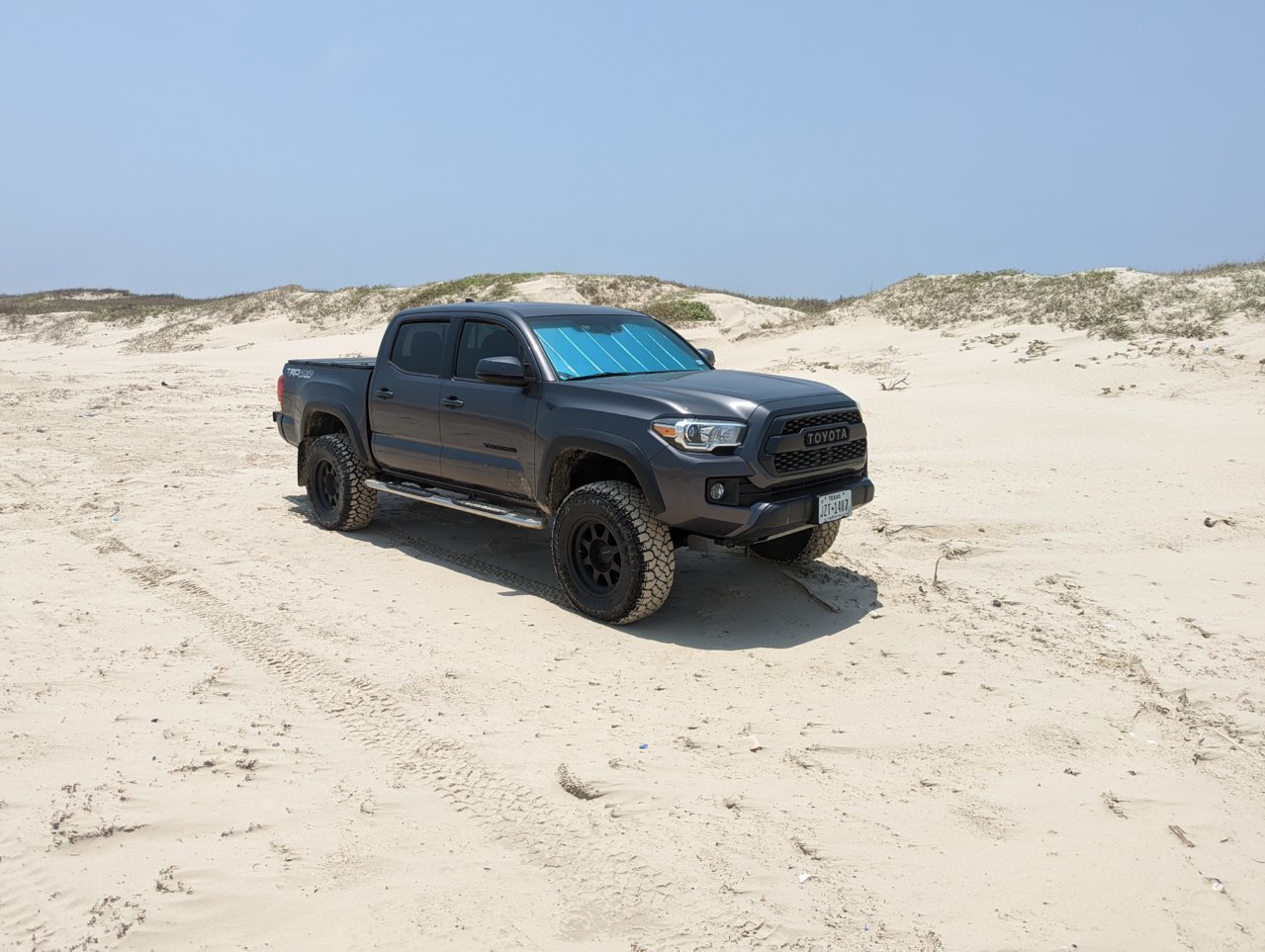

    2nd gen here... I just went with the RXT 2.5 RR shocks to match up with the RXT leaf pack. Here's option 2 with around 250 lbs of weight.

    Well either way i go i can add or remove the leaf depending on how much lift i want. I’ll probably go option 2. I dont want too much rake and im planning around 2 inch lift in the front so if the rear settles too much i can add the leaf in. I would get the 2.5 rxt shocks but thats out of my budget and my suspension plans are already overkill for how I use my truck

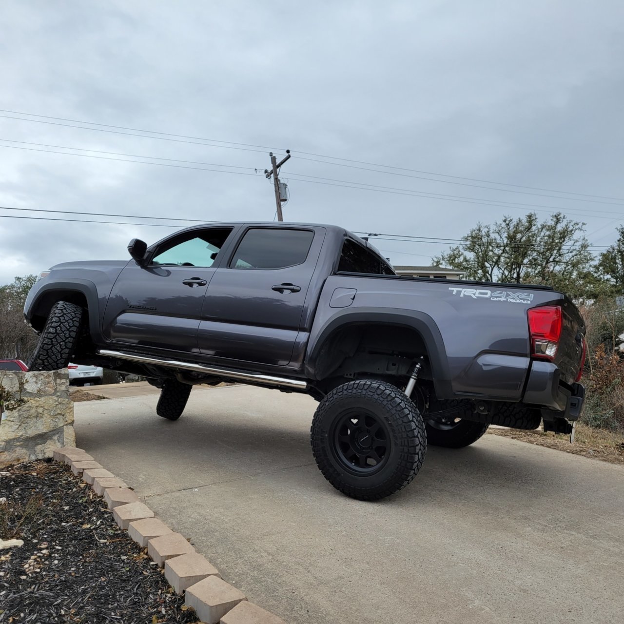

    Front-Icon 2.5 Extended Length Coilovers Rear-Icon 2.0 (Ext for 1.5"-3" lifts) with RXT Leaf Pack Method 701 Matte Black 17"x9" -12 offset Kenda Klever R/T KR601 33x10.5 17"
    Yeah if you are looking for a 2 inch lift option 2 maybe better. I was aiming for around 2.5-2.75 with mine. I felt the same about the 2.5 rxt shocks. Would love those but i was already going outside my lift budget as it was. :rofl:

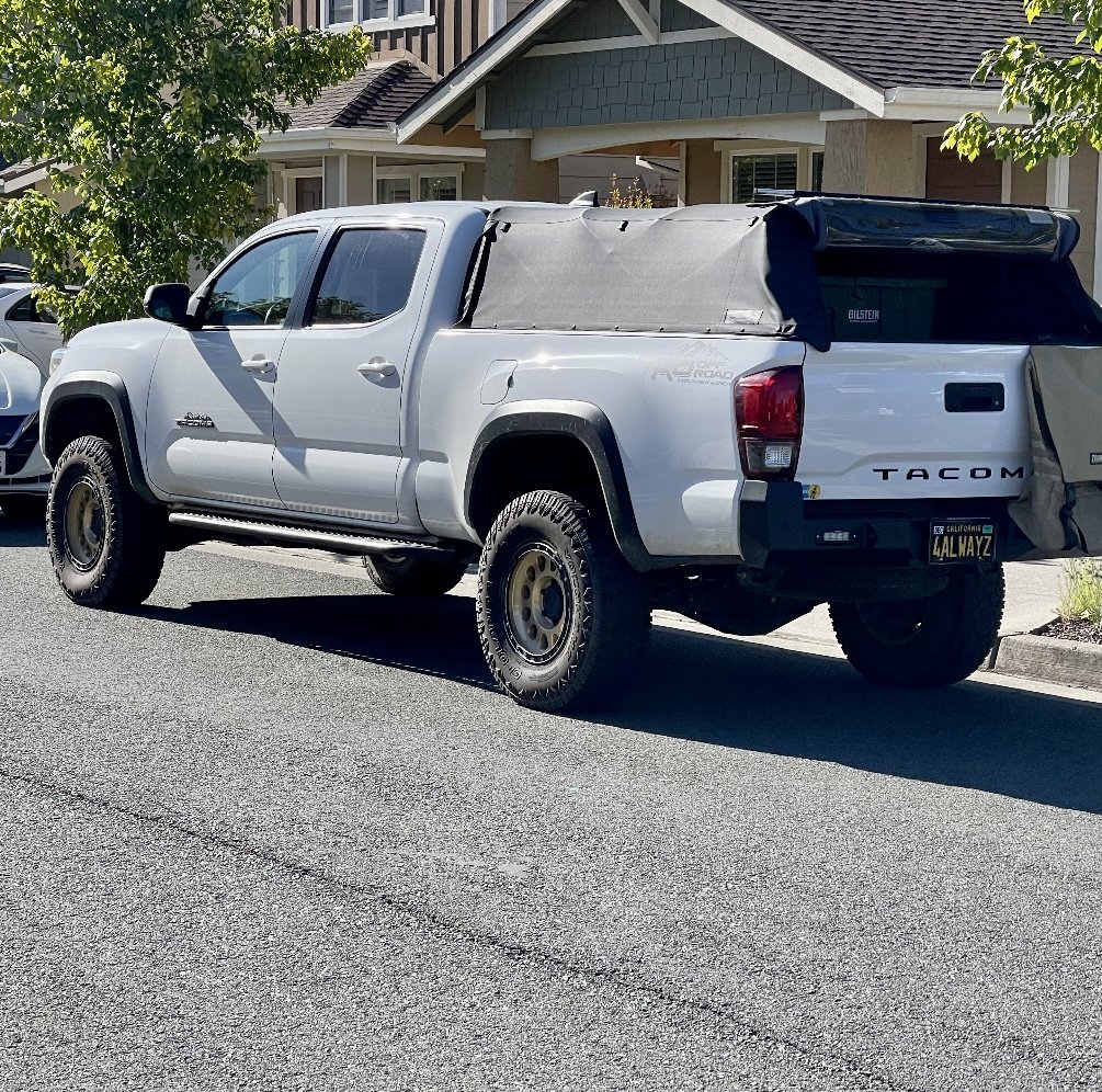

    Here is 2” front lift / Option #2 full load with camp gear still have close to 1”of rake :thumbsup:

    that last picture... i take it you have extended break lines? :eek:
    After taking some of the weight off the back end I wonder if you could seperate each leaf just enough to get grease in between using a bottle jack? :confused:

    Yep i got extended brake lines installed with the lift. Yeah the droop and flex impressed me too for mid travel. I did go with the icon 2.0 (56515) made for 1.5-3 inch lifts which also probably help a little. That is a great suggestion on jacking it up to get better access in between leaves. Im gonna try that. Thanks!

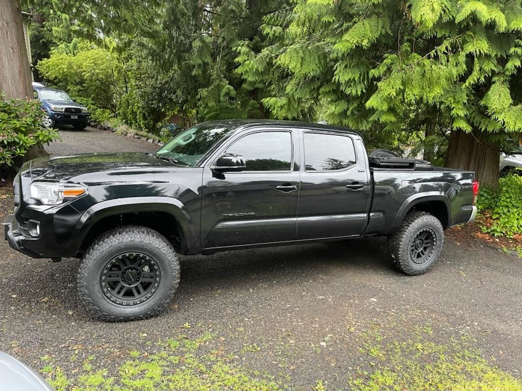

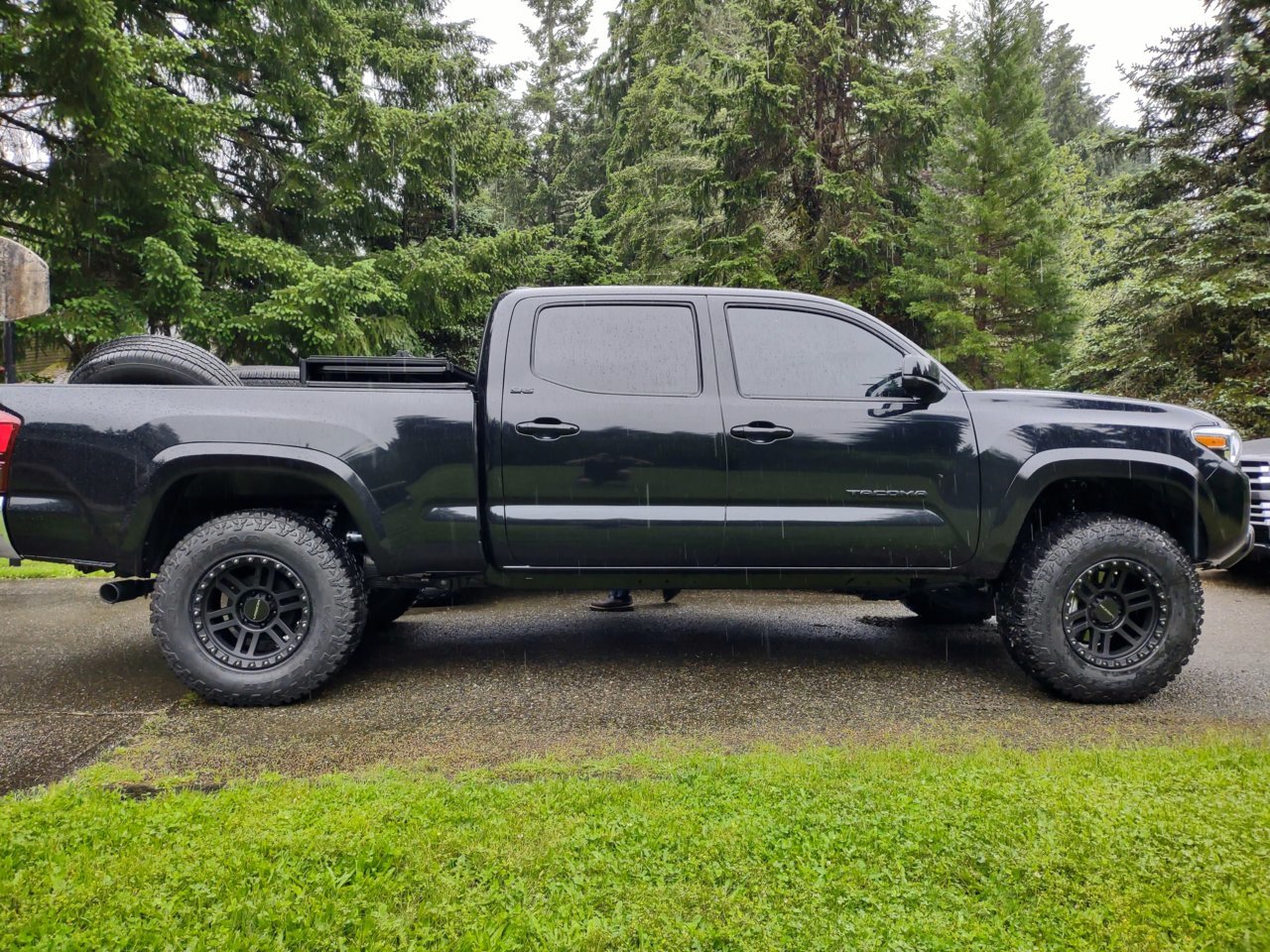

    I installed a lift for my buddy. Icon RXT level 1 paired with 5160's in back. 6112's at 6/5 in front. 285/70/17 Goodyear UT. I really like the way it turned out and how it drives.IMG_20220610_155152744.jpg IMG_20220610_205127.jpg

    Yes, this is at option 1.
