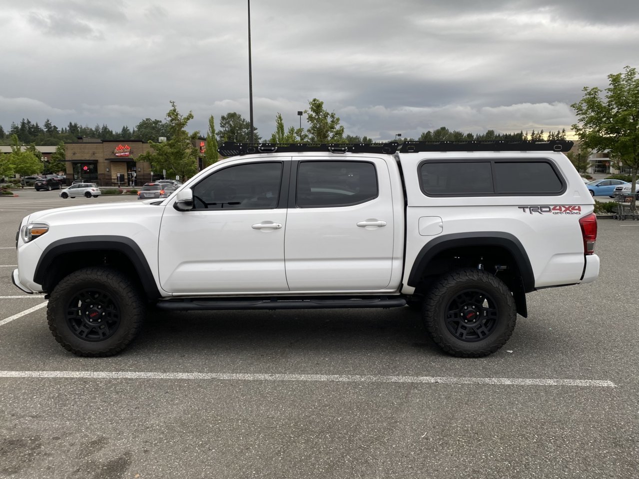

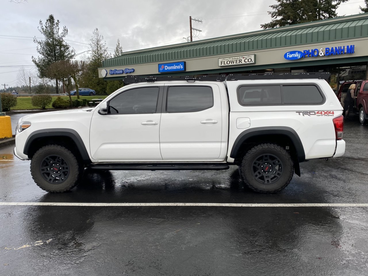

    Here’s the truck now on option 3.
    Before:
    Paired it with 6112 (@ 1” lift setting)/5160s. Gained about 3” from the RXTs with a constant load of about 500 lbs of gear in the rear (Leer canopy, Decked system, tools, recovery gear, and rack).
    I suspect it’ll settle another 1”, especially when I have my RTT on, leading to my desired rake.
    Installed the OME/ARB carrier bearing drop and there’s been no vibrations.
    Prior to lift, I was riding on my sumo springs with all the weight in the back. Here it is now

    Those pics look so familiar. Completely wild guess that you were from WA before looking at your profile. Hahaha!

    Hahah yup! What gave it up? The Pho restaurant and the Blazing Onion?

    Both of those, along with the trees and weather. :D

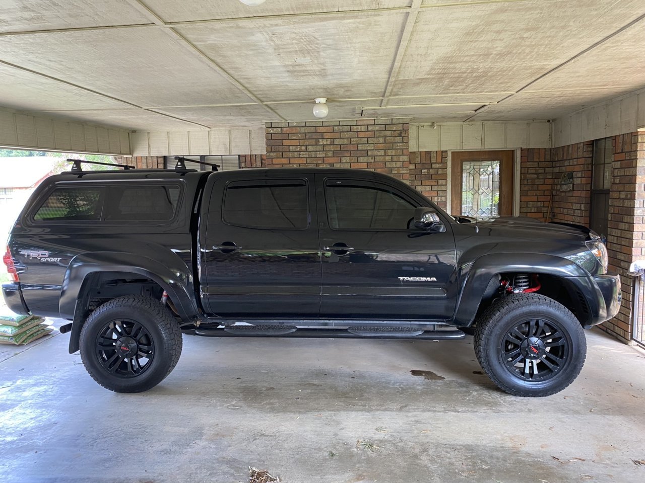

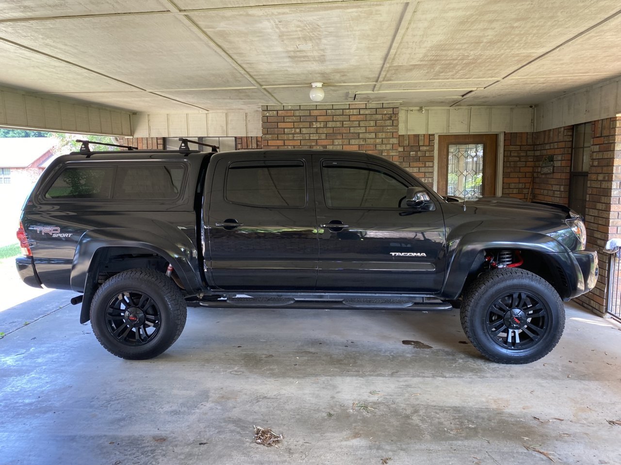

    I just got mine installed...went with stage 3.
    Nothing in back but a bed mat.
    and with 4 50lb bags of sand in the bed.
