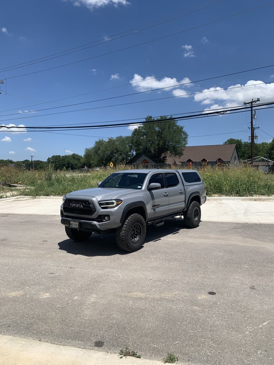

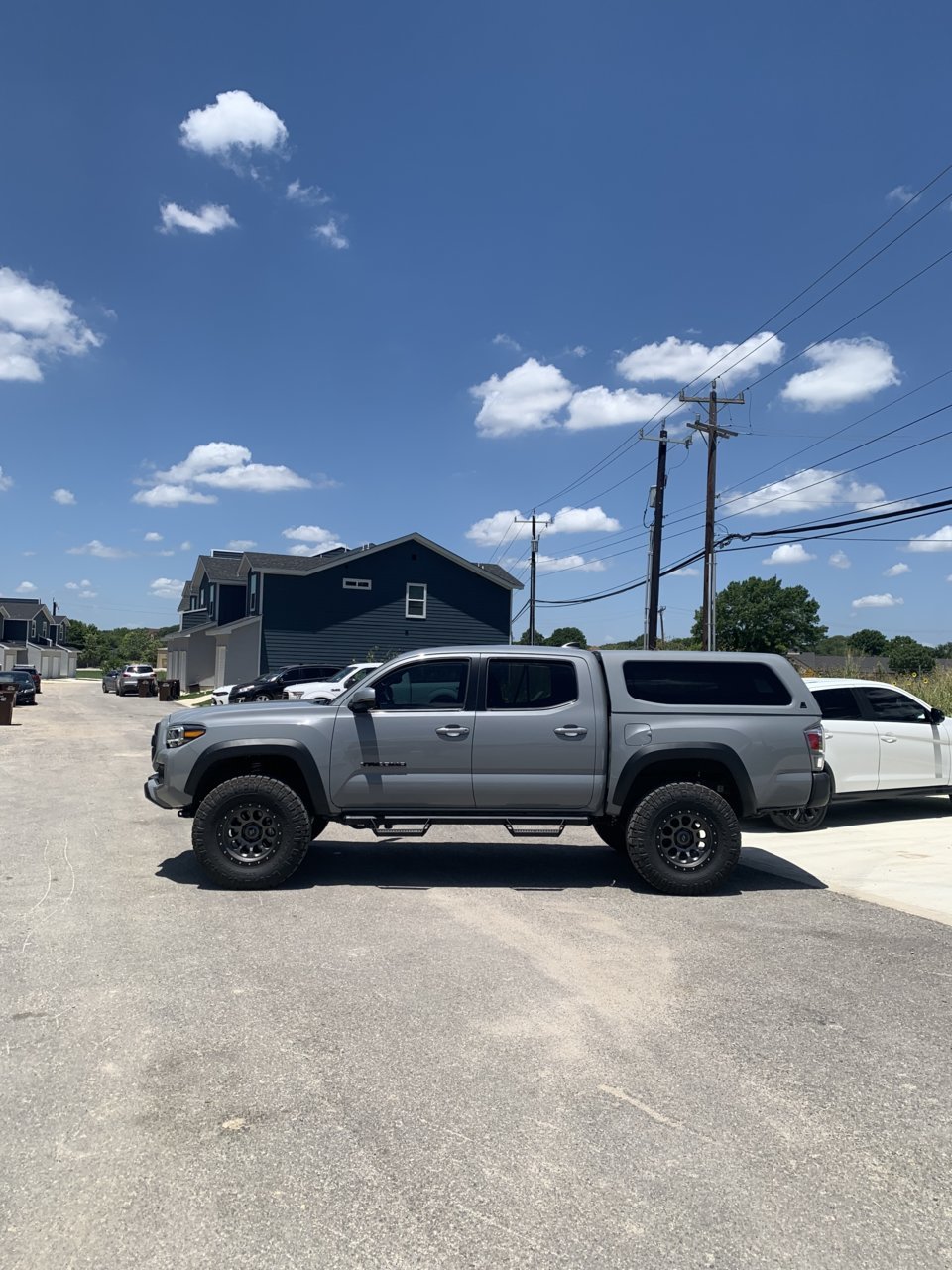

    •LEER 100xq cap •~2” Lift: Eibach stage 1 shocks on 2nd notch w/ Eibach coils in front, Fox 2.0 ifp paired with Icon rtx leaf pack set in option 2 in rear. •285/75R17 Nitto RGs •17” SCS Ray10 gunmetal -10 •CMC. •SSO Bumper.
    Leaf pack set on second option paired with fox 2.0 in the rear and eibach pro lift up front. with a leer100xq cap. nothing in the bed. 285/75R17

  17. Jul 8, 2022 at 11:10 AM
    #1437
    4xThad
    4xThad Thad
    Apr 25, 2020
    #325806
    752
    Thad
    Bend, OR
    2021 Cement Tacoma TRD OR DCLB; 2021 Blizzard Pearl 4Runner Limited; 2006 Tundra-SOLD
    Tint, DK ucas, Big Billies with Icon springs, SCS S6 wheels wrapped in Duratracs, a GFC, a Smartcap, martin OR RR, roam boxes sometimes, maxtrax and rotopax sometimes, and a ski rack other times
    fuck yeah bud, what a unit
  18. Jul 8, 2022 at 11:15 AM
    #1438
    bwhiteside5
    bwhiteside5 Active Member
    Jul 8, 2022
    #400942
    27
    Brandon
    San Antonio TX
    2020 CMNT 4x4 TRD OR DCSB
    thanks man, i had been watching and reading many of these threads for about a year to piece it all together, feels good to finally join TW to show the final product!
    4xThad[QUOTED] and elmontemike like this.
