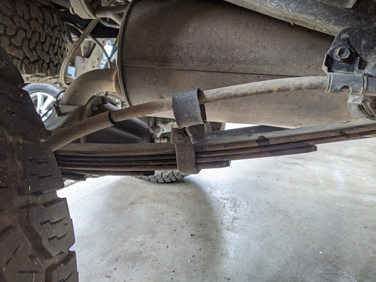

    2. no, but the parking brake will rub on the leafs there's a mod on here you can do at home: https://www.tacomaworld.com/threads/replacement-brake-line-clamp-for-icon-rxts.765590/

    Good point. I posted this earlier in this thread. I don't think it needs to be bent outward, but I'm only at Option 1. Just a little tweak to rotate the loop towards the back to follow the angle.
    Definitely do not cut them off like the Icon instructions say.

    I don't have this setup, but throwing out my opinion any way. I have the factory TRD Lift installed and did Option 3. The stock lines are probably okay if you don't expect to go anywhere with a lot of flex. The TRD shocks will hit their max extension before the lines do, but it made me uncomfortable on how close to tight they were. I was already dumping a bunch of money into the rear, so for $75, I got Toytec 2" longer brake lines for piece of mind.
    The parking brake line will rub. I made a little Z shaped bracket out of some aluminum strap and a bolt and mounted it to the leaf keeper bolt.
