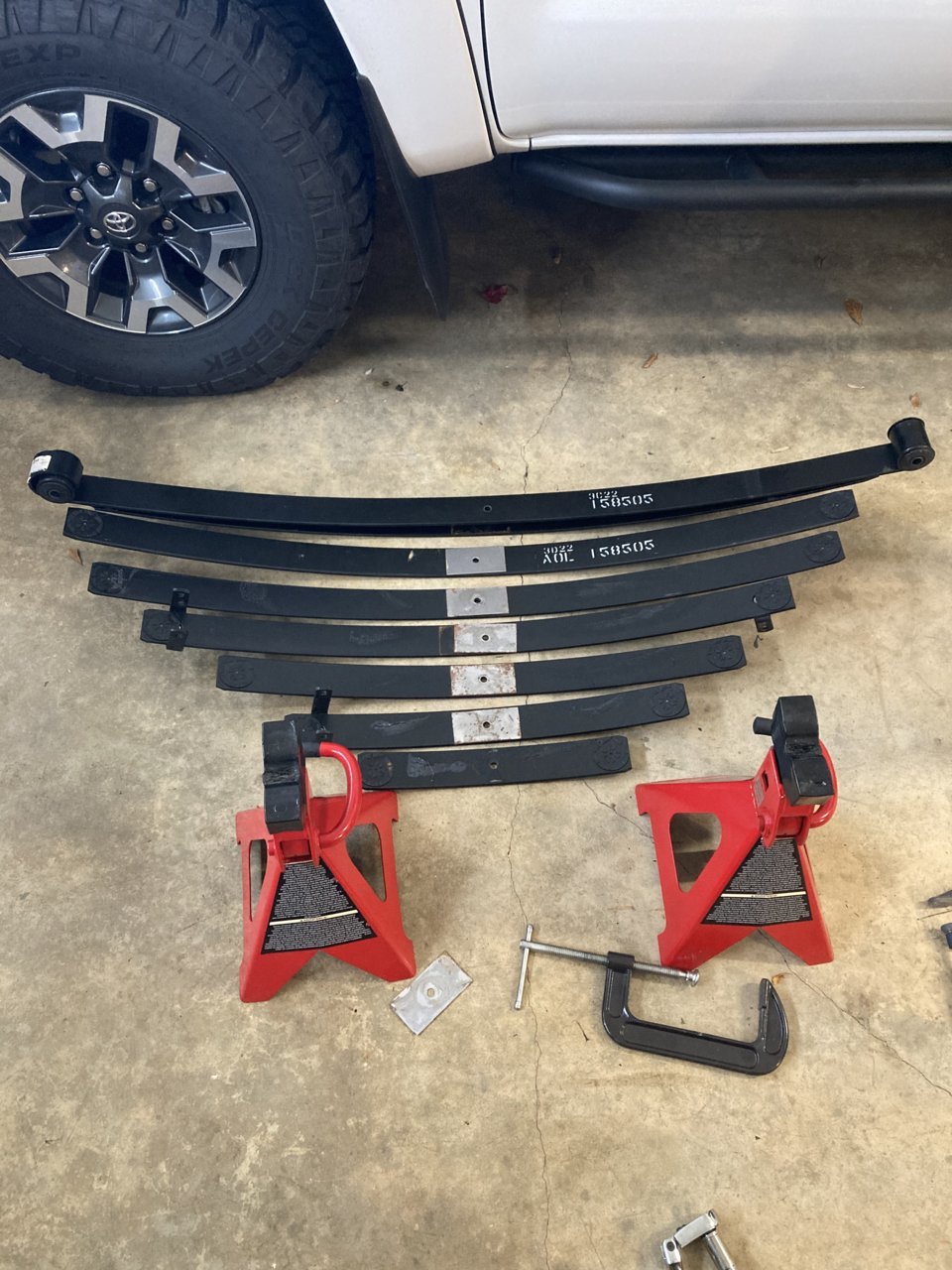

    Just got the extra leaf added to my RXTs for Stage 3. I was sure to put a thin layer of Fluid Film in between each leaf to hopefully prevent squeaks and rust. Gonna be running Bilstein 5100/OME 887 and the RXTs with Bilstein 5125s. Just waiting on UCAs and U-bolt flip kit from Accutune. I’ll be sure to let ya’ll know how it rides once installed. This thread has been very helpful with decision making on these.

    Has anyone gone from opt 2 to 3? where does that additional leaf go? after reading the directions 10-20 times I believe it goes beneath the 3rd leaf? can canyon chime in and confirm im correct?

    This is the video I used to help along with the directions from Icon. Make sure to pay attention to the front to back as well. As pictured above the lettering on my add a leaf and the original pack were oriented the same direction. One end of the added leaf is longer than the other.

    Clicked it up to option 3 today. Aligning the leafs was a big time PITA

    Option 2 should use the same hardware as Option 1 since its the same number of leaf springs… you are just swapping the third leaf from the top for a stiffer version. Only option 3 requires the longer retainer and center bolt because you are adding 1 additional leaf and increasing total pack thickness.
