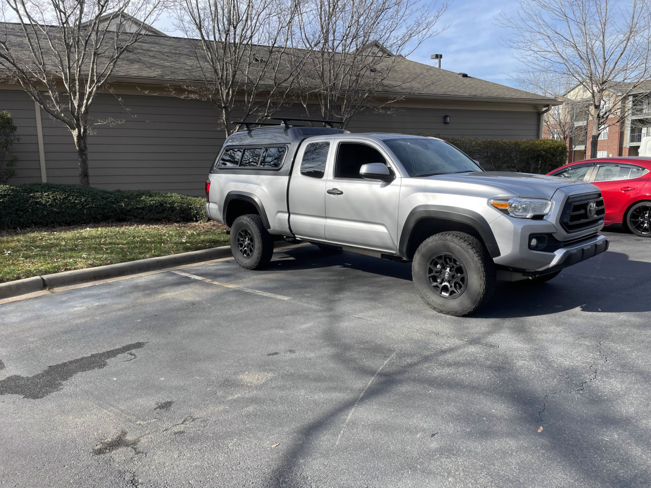

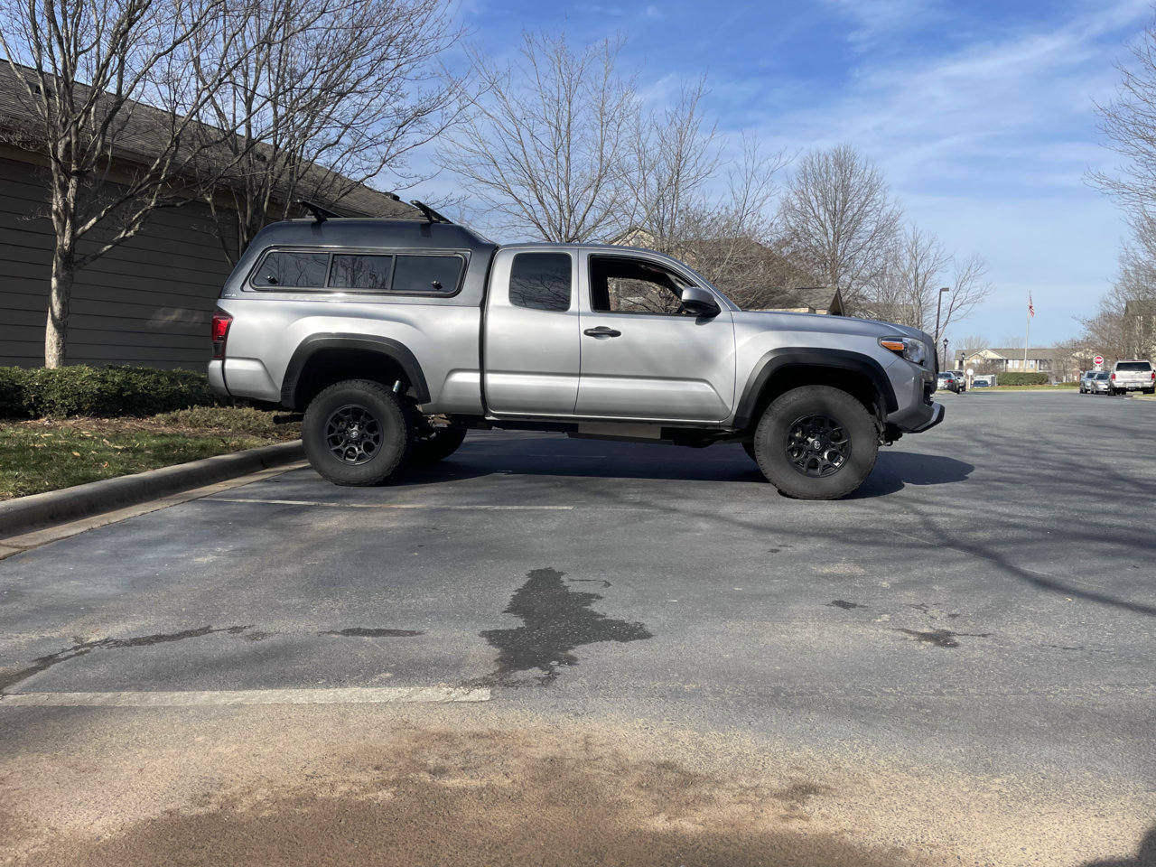

    Went from 39” ground to fender measurement on Option 1 to 40.25” going to option 2.
    did the install in about an hour on the truck, without pulling the leaf pack out.
    Rides just as good as option 1, or in my case I prefer it more as now it’s more balanced with the ride of the front end.

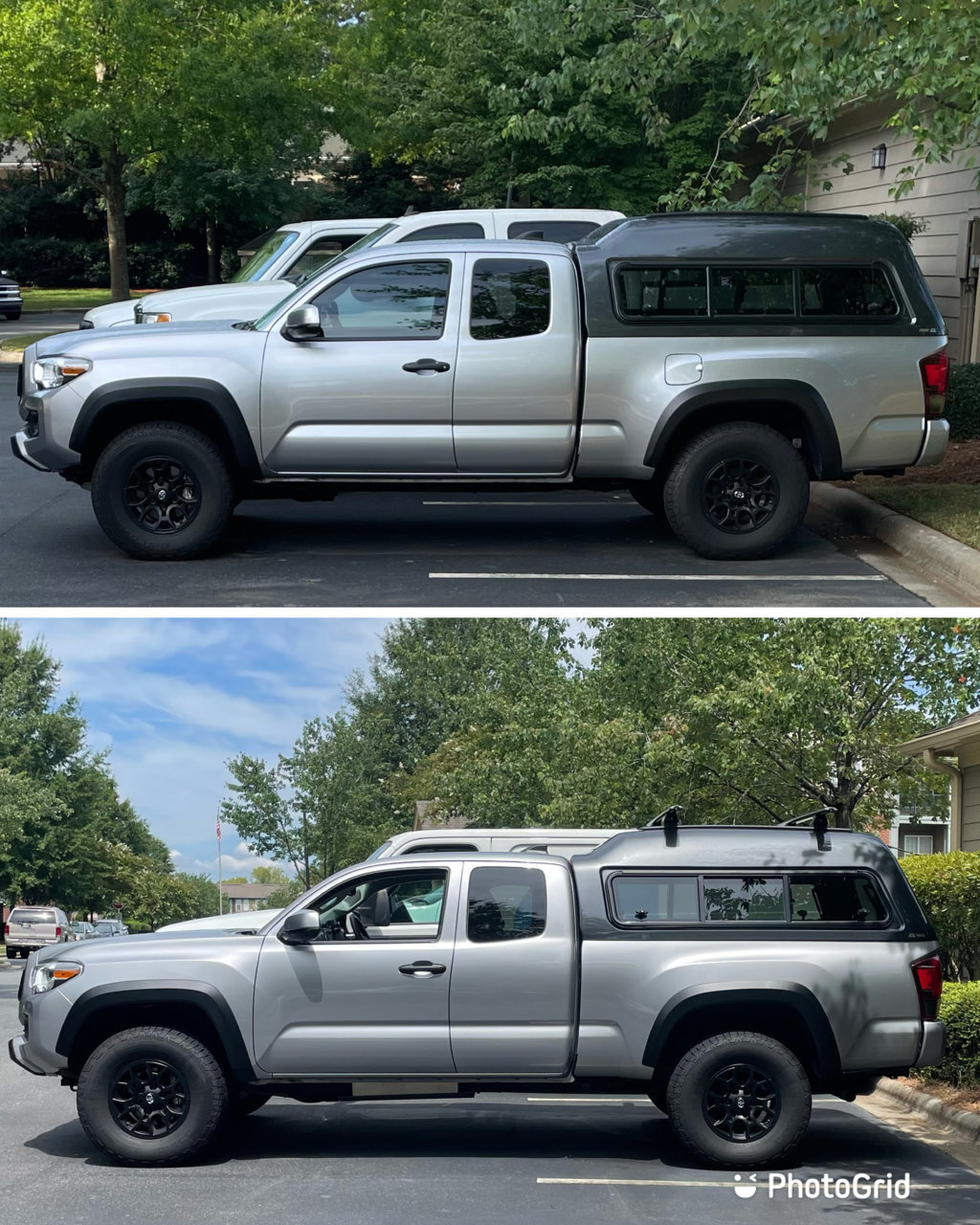

    Just installed the icon rxt pack on option 2 with 5125 shocks, 2.5 degree tapered shim, wheelers u bolt flip and some gm bump stops. With the topper and some gear in the back my guess is around 400lbs. I added a before picture on the bottom of stock suspension and then stock suspension with a 1.25 block. Next will be 5100's in the front to raise it about an 1'' i prefer more rear rake vs level. Its more firm but rides nice, quiet no vibrations. I am going to wait about 6 months and see how these settle before i put 5100's in the from my guess is 1/2 maybe 3/4''. Anyone who's had this pack for a while notice how much it settles?
    Icon Rxt Stage 2 w/ 5125 shocks
    Stock Suspension vs Stock Suspension w/ 1.25'' block on bottom

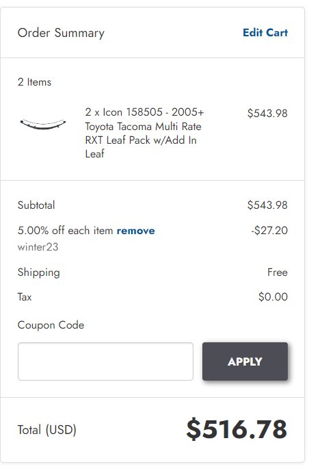

    about to order a set of these. combed the internets for best price and so far the best ive seen is this "CSP racing" @ $516 with a 5% discount/no shipping/no tax. anyone vouch for this company? they seem to be legit having a instagram and facebook page as well. not really an offroad or truck kinda site so curious that they would carry them "in stock."

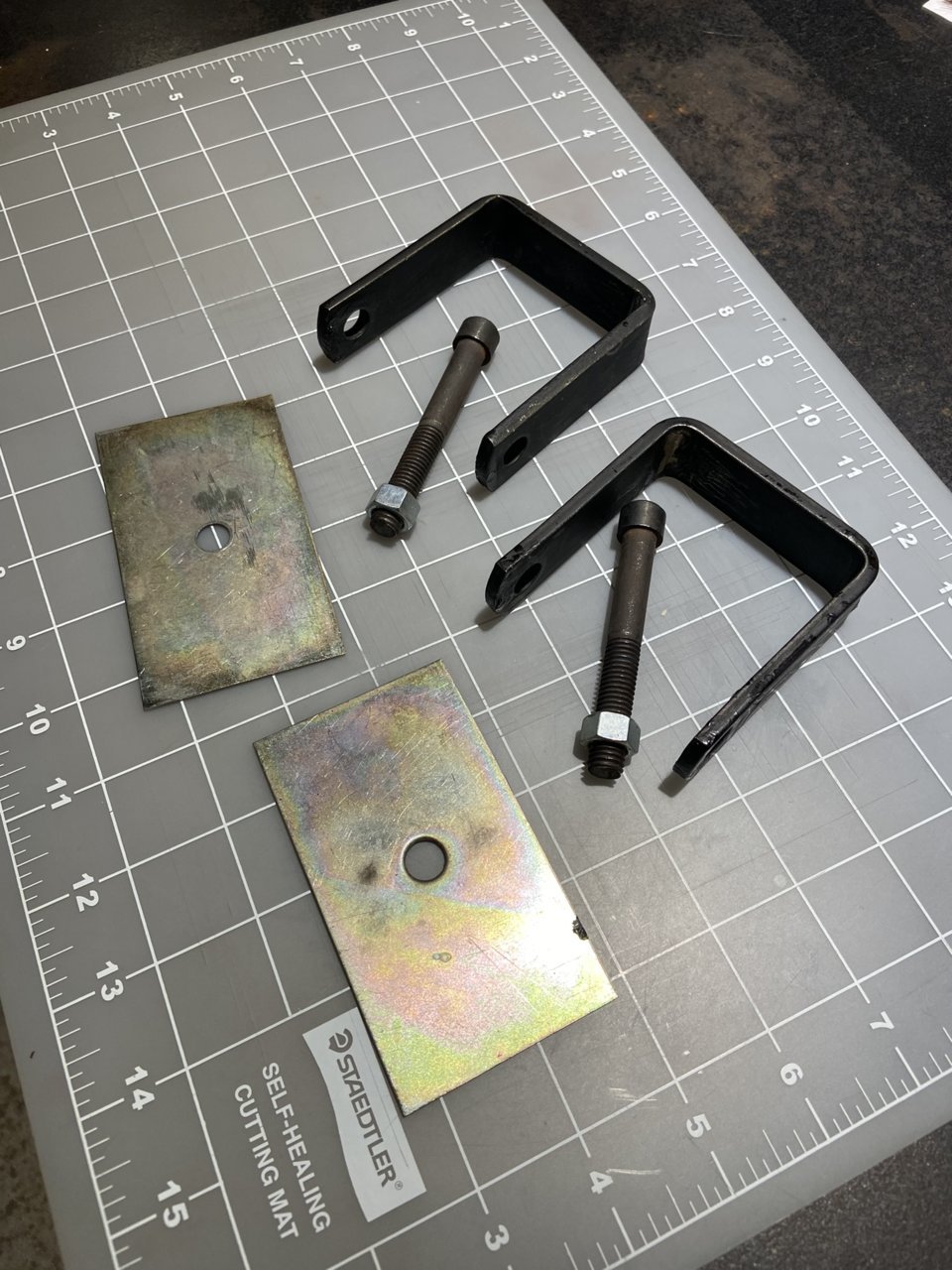

    i see you mention above installing longer retainers and center bolts. i'm pretty sure i received no additional hardware, and icon's RXT installation instructions say N/A for hardware included...what am i missing?

    You can order the hardware from Icon but will probably have to speak with a service rep as the hardware is not listed on their site. That was the case a few months ago when I ordered. I only had hardware for one pack so I either lost parts or they never came. I don't recall.

    looking just now i see the rear retainer will not work with installing the extra leaf as there's a rivet in the way.
    so it's confirmed then - additional hardware kit is required for option 3?

    Yes additional hardware is needed

    They should provide you with a longer center bolt, longer retainer u-clip doodad, and another brass spacer. One of each per pack.
