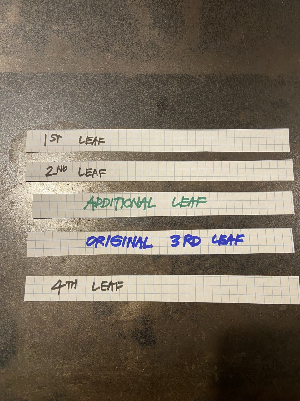

    wanting to confirm if option 3 is this order of leafs top down…if not I have early onset dementia

    Yes that looks right.
