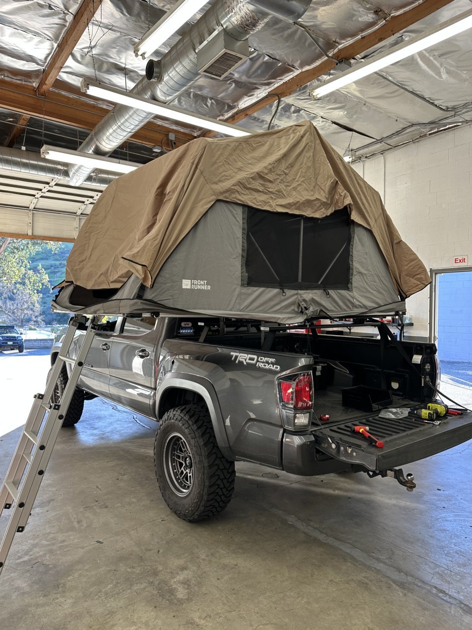

    This is my current setup. I'm running the Rxt pack on stage 1 and holding a 93lb RTT plus 2 load bars. The leaf pack handled it with no problems!
