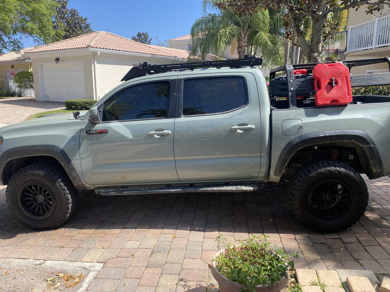

    I went with option (3) and I regret it feels like I’m driving down hill. I currently have a roof rack,sliders,decked system load (tools,camping gear etc), steel bed rack (RotoPax,maxtrax). It rides really nice but hate the rack forward. Last weekend I had 600lbs of play sand in bags and it didn’t make a difference.

    I'm eventually going to buy the fox elite performance 2.5"-3" kit as well as a iKamper 3.0 so we will see. I think with the suspension upgrade I'll be able to lift the front and then its smooth sailing from there.

    The driveway slope is exaggerating that. Do you have stock suspension in the front? Because it looks really low

    Front lift? Park on level ground with a side shot

    Agreed. Looks like he’s stock up front and the driveway isn’t helping

    It may look exaggerated but it's not. I will get a picture on flat ground tomorrow. And the only thing "suspension" wise I've changes is the leaf springs/bump stops. So yes factor fox that comes on TRD PROs
