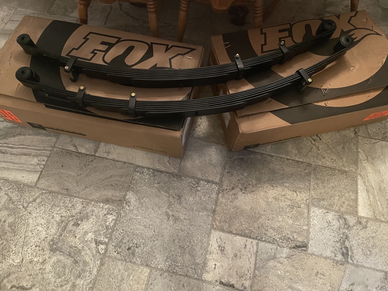

    Wow, my springs showed up today! 3 days since order... Impressive....
    Install coming soon, probably Monday since I'm off work

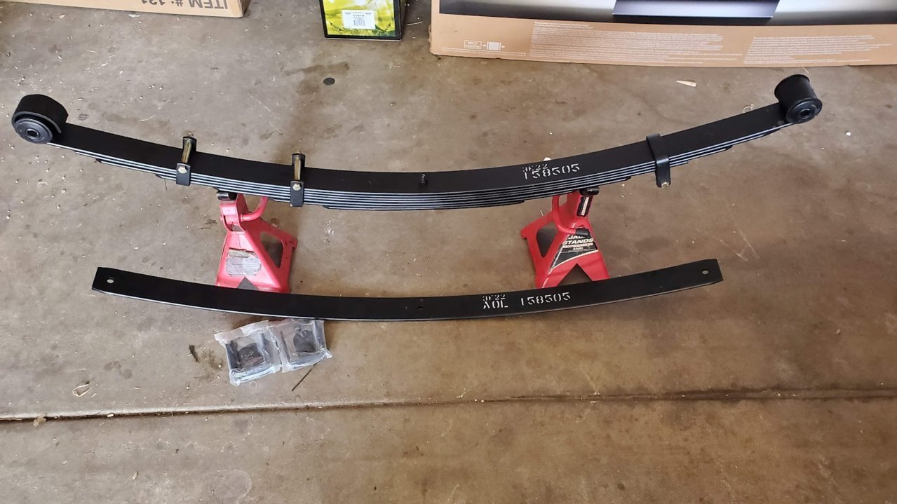

    RXT's showed up today. I pealed off the extra leaf pack and hardware. These will be left at stage 1.

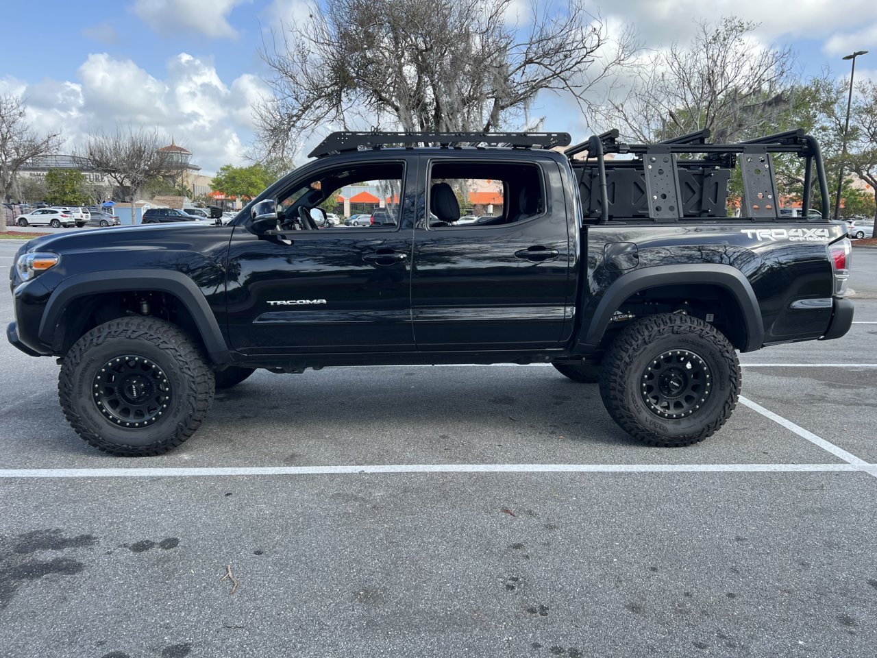

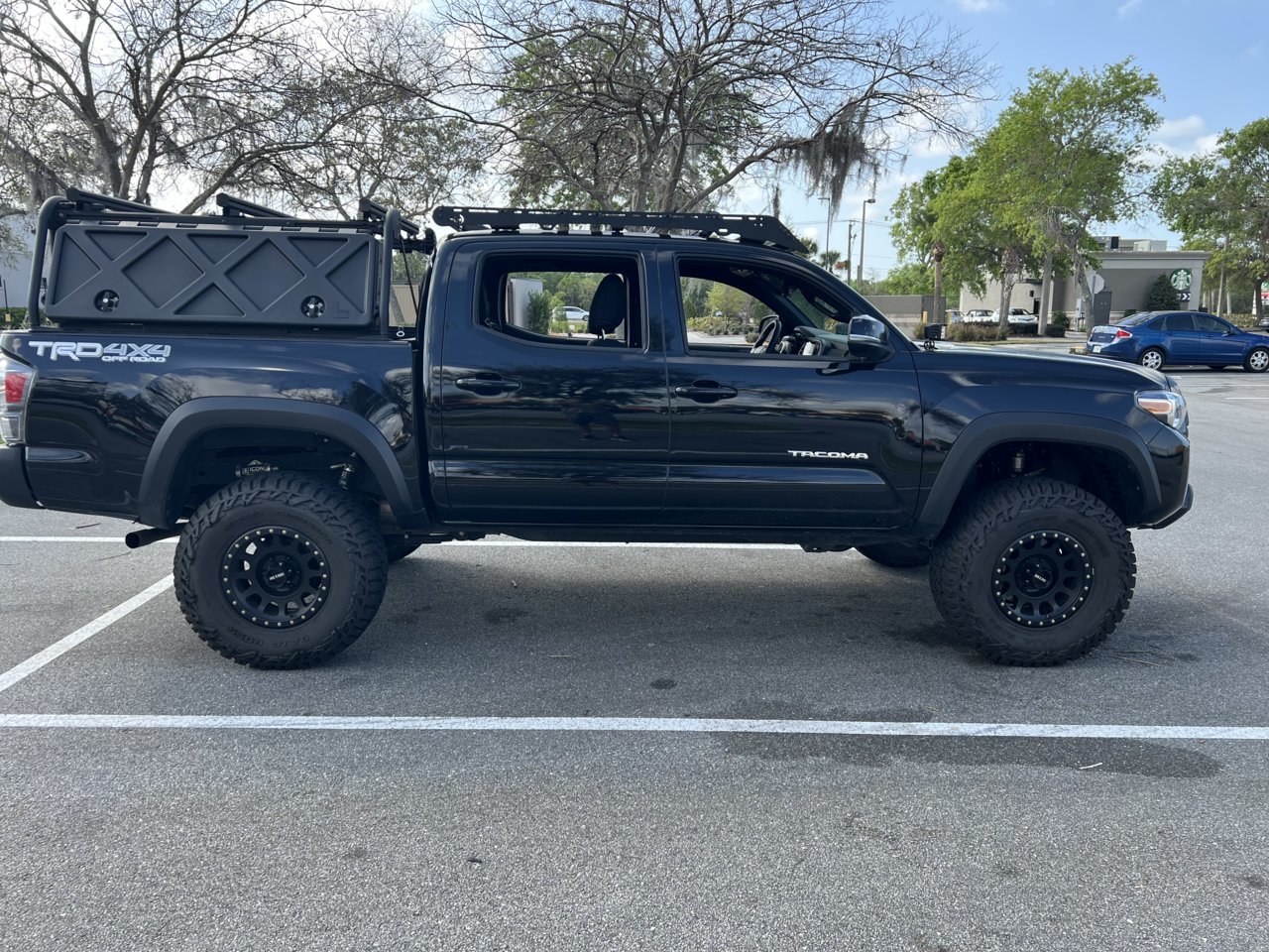

    DAF2E403-088A-44DC-B27A-23B2CB450129.jpg B9ACDDCE-9BD9-4424-83AA-EFAE6B09F3F6.jpg -Icon RXT Option 3.
    -Icon coilover suspension in front with 2.13in of Exposed thread.
    -Rear I have a leitner rack that weighs about 150lbs and a decked system that weighs around 200lbs.
    -was worried about rake in the beginning but it actually looks a lot better with a little rake in my opinion.
    -Truck handles and drives alot smoother.
    -Best upgrade you can do if you have weight in the rear.

    Looks hot

    Always like that ass up!!!

    So sorry, 100% noob question:
    I am trying to configure my leafs. Adding the AAL in... Which way is the front of the pack? I assume the end with the leaf that wraps around is the rear of the pack?

    Military wrap goes forward!
