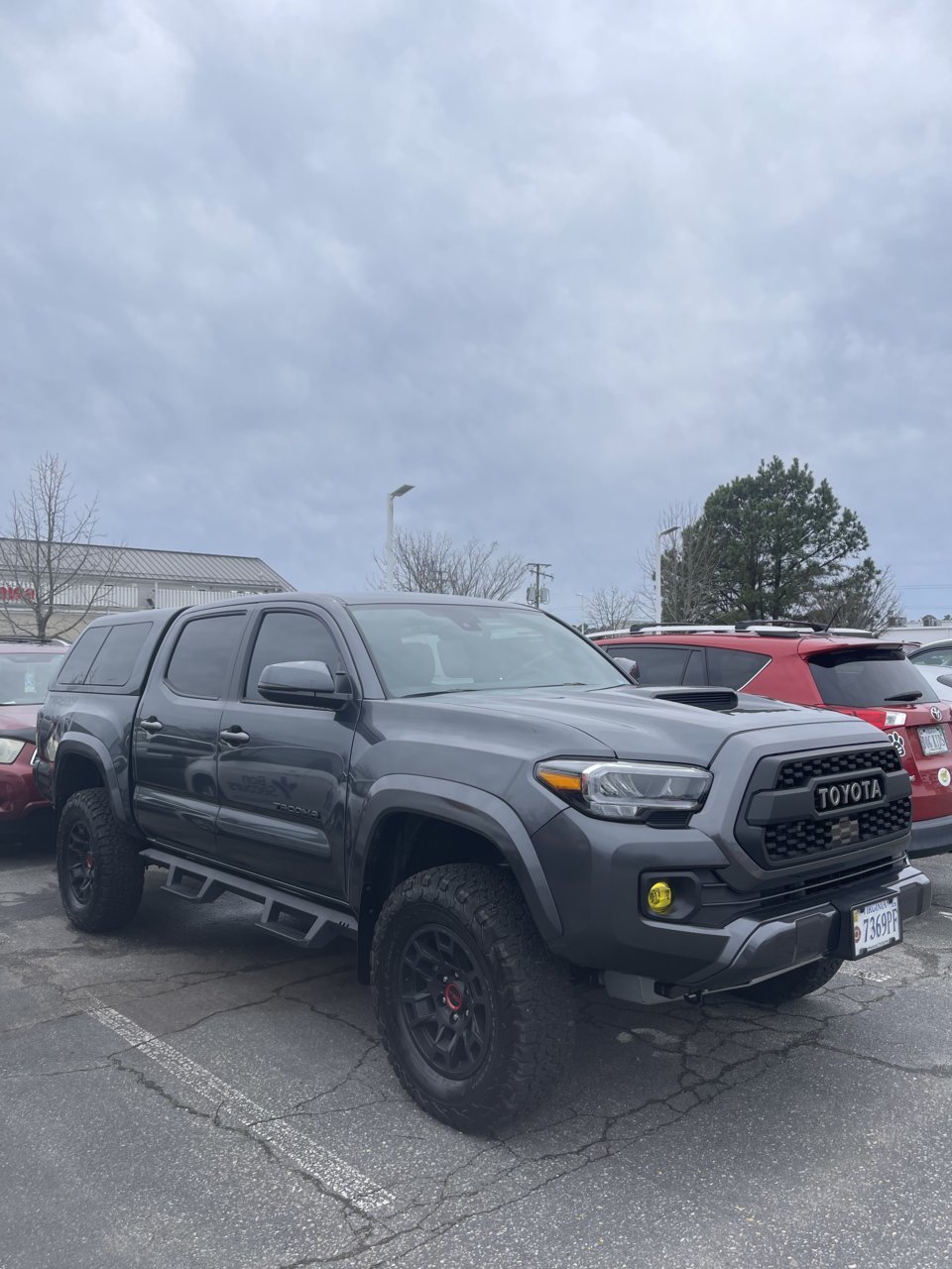

    Halloween
    Halloween Well-Known Member
    Nov 8, 2022
    #410220
    522
    Steve
    Toyotas a plenty
    Good advice. I went with 2 and rides great and will prob settle some more. Still has some rake. 3 would have been too much for me too even with a topper. This only pic I have.
    MGMDesertTaco and JDKred[QUOTED] like this.

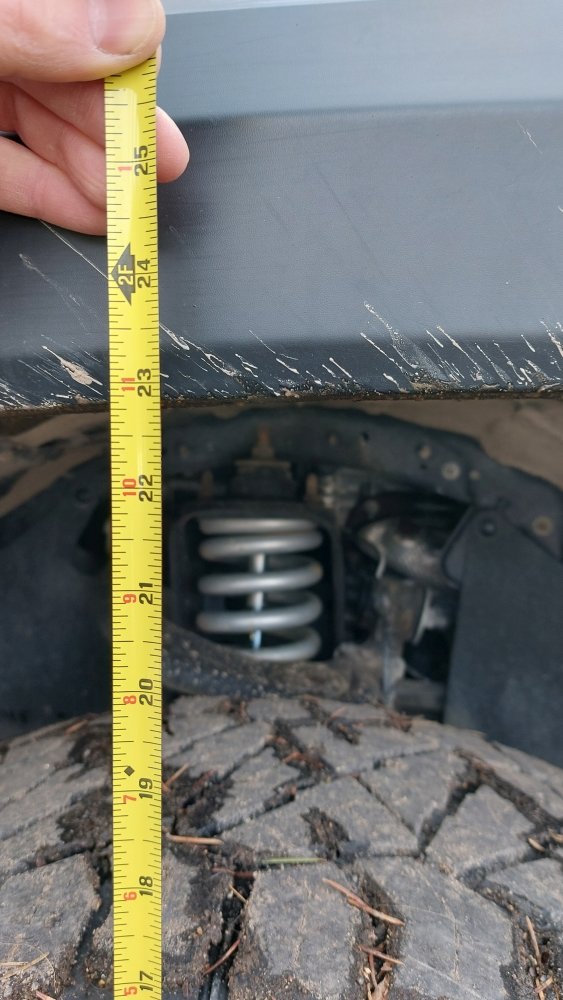

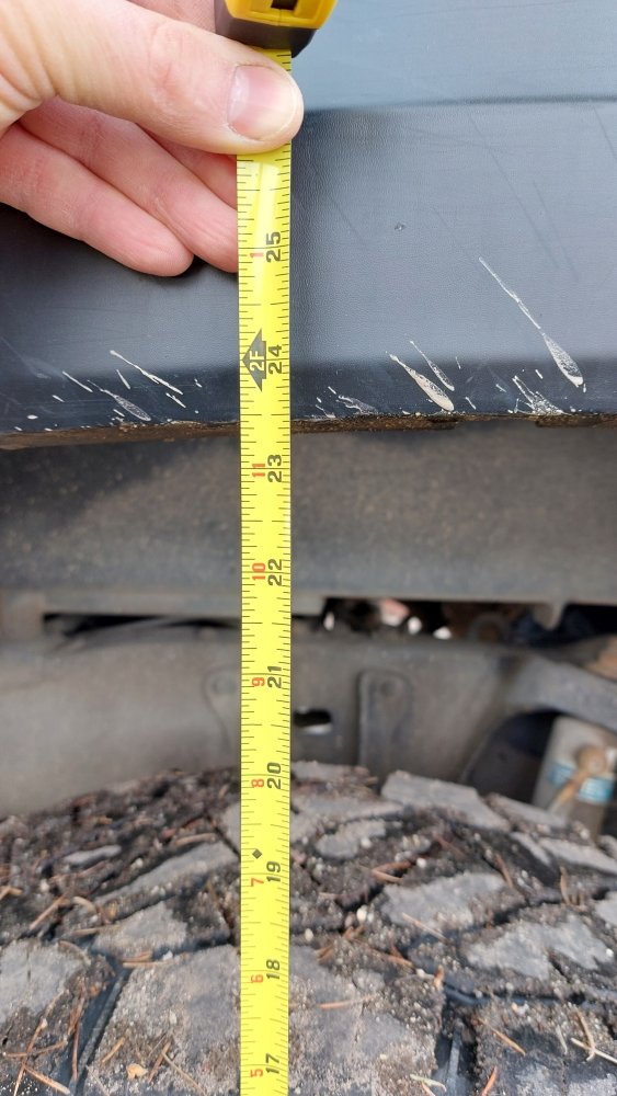

  8. Mar 28, 2023 at 9:03 PM
    #1748
    92se-r
    92se-r Well-Known Member
    Jan 5, 2017
    #206708
    260
    Got pics and measurements? I have similar weight
  9. Mar 29, 2023 at 4:09 PM
    #1749
    BRFab
    BRFab Well-Known Member
    Sep 24, 2018
    #267226
    255
    BC
    '19 Alien Grey TRD OR
    Kolache007 and 92se-r[QUOTED] like this.

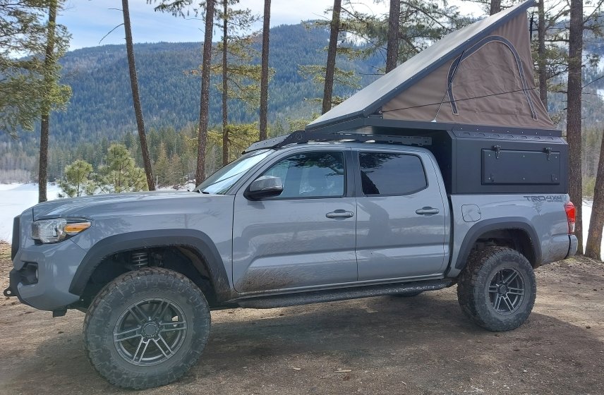

  20. Apr 16, 2023 at 2:32 PM
    #1760
    phdog
    phdog Well-Known Member
    Jun 27, 2017
    #222534
    1,269
    Jim
    Northern Colorado
    2017 TRD Off Road
    w/Super Terrific Happy Hour Mod
    What camper is that?
