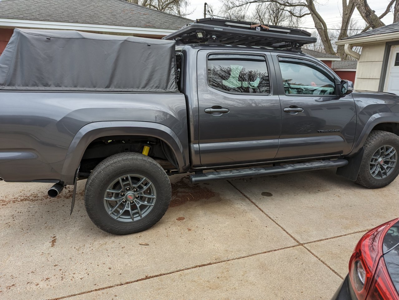

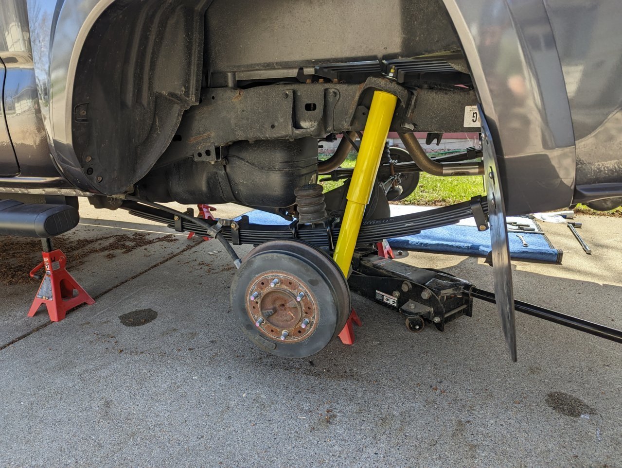

    Finally installed my Icon Rxt leaf pack, option 2, matched with some Dobinson shocks.
    Before I was sitting at 20 3/4" and the leafs had negative arch. Now I'm at 24" unloaded, I tossed 300lbs of sand in the bed to help break in the leafs. My target height is 23 1/2"
    Next weekend I'm installing the front lift so it won't be so raked.

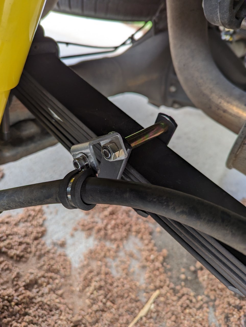

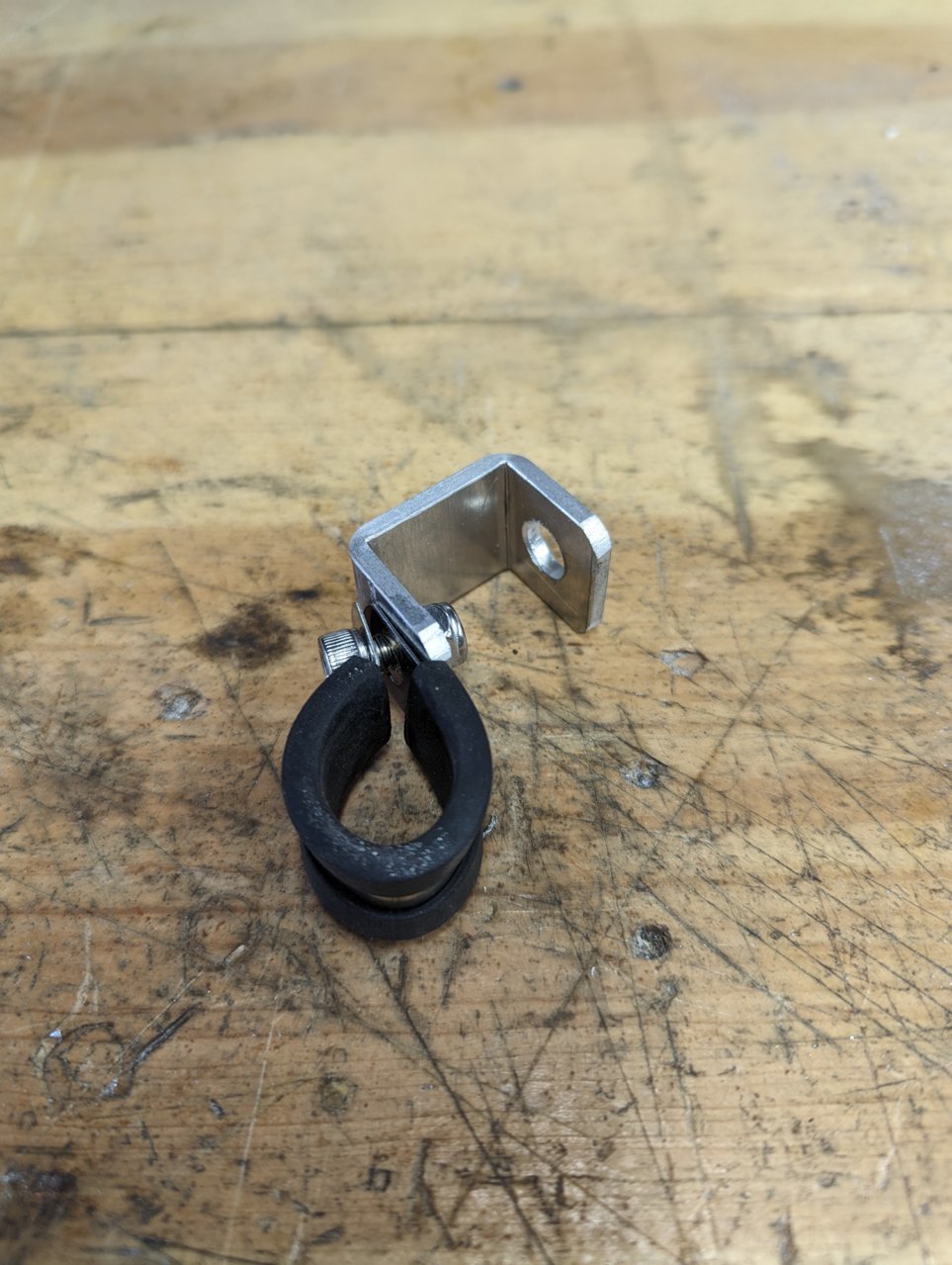

    The one thing I didn't like about the leaf install was the brake line bracket that had to be bent to work.
    And if I used a cable clamp by itself the line is awfully close to the spring clamps and risked rubbing.
    So I made 2 little brackets to hold the lines about an inch away from the leaf pack.
    PXL_20230426_213909055.jpg PXL_20230426_181746379.jpg PXL_20230427_211342582.jpg PXL_20230427_211401281.jpg
    Dfpftw, Ryan188, DavesTaco68 and 6 others like this.
