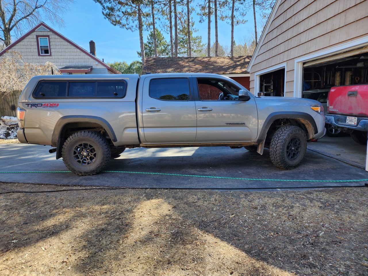

    Yes, I am replying to myself, in hopes of keeping my question and data (if you want to call it that) together in hopes that is might help someone with the same question, since no one seemed to have my exact combo.
    Starting point; with factory springs, I was sitting about 2" (guesstimating) off the factory bump stops. The truck was borderline unsafe at highway speeds, bottoming out over expansion joints, in a turn, was not fun. When removing the factory items, I could tell I was right, this thing was bottoming often- the otherwise dirty crusty springs were clean and shiny where it mated with the bump stops.
    Finally got everything but the extended brake lines installed. Late night, buuuutt we didn't start 'til almost 8:00 PM. I went with stage 3, and so far it rides awesome! Once again, it rides like the small/medium sized truck I bought and wanted. It has a decent amount of rake, but that is what I wanted, for looks and functionality. This isn't my DD, most of the this truck's miles are spent hauling range gear for matches or hunting. So it has anywhere from about 150-250# of gear for matches, to 300-600# (and maybe more) for hunting gear and loaded coolers.
    Are the measurements most are providing from center of hub to middle of the quarter panel/fender well? if so, I am at 24" on the passenger side.
    Stupid me; I forgot to measure beforehand, but it was sagging bad.
    I will post pics when I get to a more level parking space.
    Shoutout to @memario1214 for answering all my questions and order updates!

    #335, as mentioned, I quoted myself from earlier to tie info together.
    New on the rear; Icon RTX stage 3, Bilstein 5160 rear shocks, Durobump 3.5" stops.
    The front is all OE, with a 2" spacer. I will save up and do Bilstein 6112 fronts too.
    Initially, I started with a 2/1" spacer kit, but after adding bed topper and Decked system, I was Carolina squattin'.

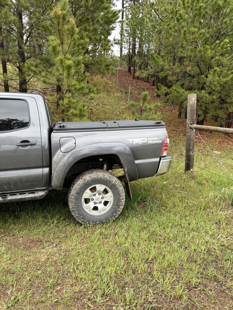

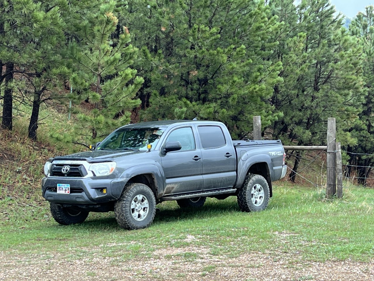

    I’ll work on grabbing a few this week with the professional camera. (Don’t want to confuse anyone with bad photos) Grabbed these on the shake down drive.
    It has some good rake but I haven’t put my bike rack and other gear that I will always have on the truck.
    I’ll make a detailed post after I get some time with them as I’m not the typical stage three user.(not running near the weight)
    Right now I’m 25” center of hub to fender.

    Looks great

    Looks good!
    Had you done this before me, I would’ve made my decision easier. I’m glad I went w stage 3, definitely want rake and less sag when loaded.
