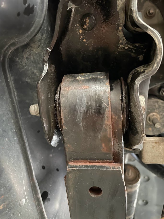

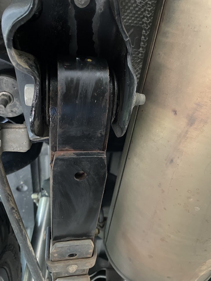

    So after about 3 months of going back and forth with Icon support (they reply to emails about every 24 days), and sending them videos of my noisy bushings - they have agreed to send me a replacement set of bushings.
    BUT BUT BUT, I've also had a weird clunk that has sounded like the leaf packs moving around in between the "clamps". Well I got under the truck to spray these noisy bastards down with silicone and look at the 2nd leaf on my drivers side. Is that a typical amount of movement? Seems excessive, and if that leaf is "sliding" around I'm sure that's my clunk.
    EDIT - First pic is passenger side where the leaf is nice and square. Second pic is the drivers side that is all out of whack.

    They are absolutely horrible! The only reason I went w Icon is because @memario1214 at Hotshot Off-road is so good to work with. I emailed Icon over a month before I purchased from Hotshot, then randomly one day I get a reply, weeks after I’ve already decided, shipped, and installed (almost two months after email). They need good vendors, and might as well refer them to vendors, as they’re unable to help.

    Toyotas a plenty
    That’s wild….. I’ll keep an eye on mine. Def don’t look good.
    I use spray white lithium grease on mine about every 4 weeks.
    if mine go bad I will get a new set from a diff manufacturer. Wonder which ones are the best and ride good
