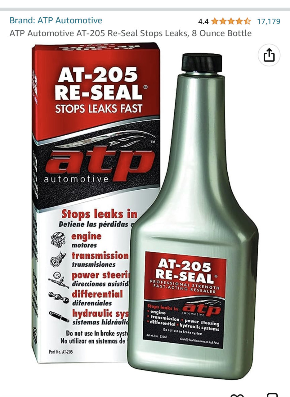

    This will sound dumb but the stuff worked on what I used it for. It may help maybe not. I used it on LCA bushing on my Lexus IS commuter and made a big diff.
    I dumped some of this in a small
    Spray bottle and it swelled and softened up the bushings. I was surprised. It supposedly can be used in a bunch of other things like internal engine stuff but I’d never do that. Bushings is another story. It may help swell/soften bushing and hold your spring in place better.
