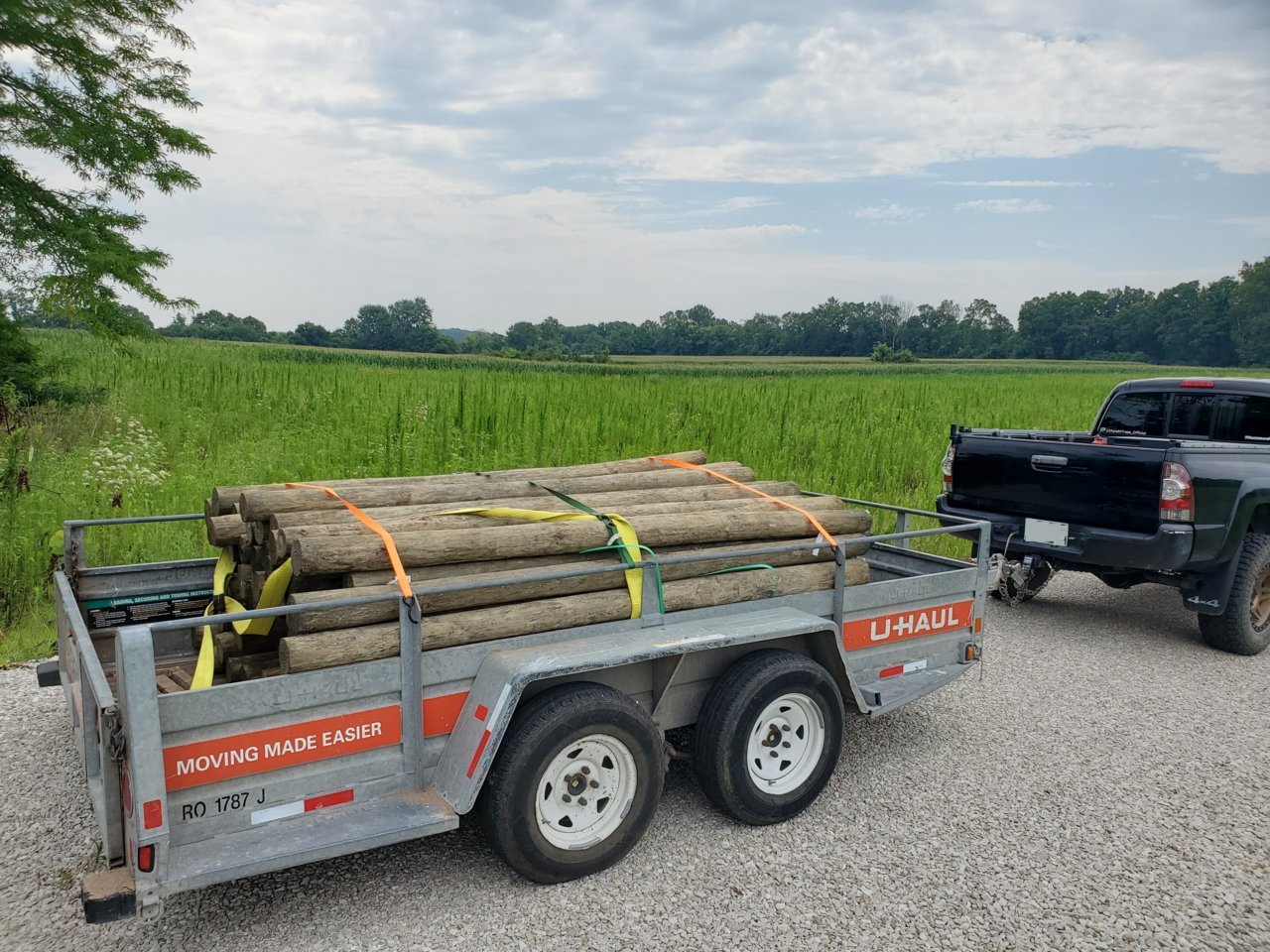

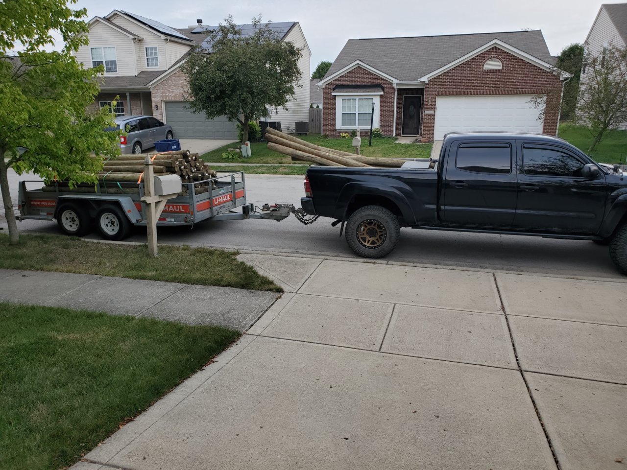

    Icons option 2 with riderite airbags are so far an amazing setup for me. Hauled about 3000lbs of fence post in a 6x12 uhaul trailer and another 150lbs in the bed, icons only drooped about 1-1.5". Gave the bags about 40lbs of air and it came back to level and drove great for the hour drive to the property.
    Then throughout the day I carried about 600lbs of more fence posts a couple more times in the bed alone and with a little air in the bags and it handled it like a beast.
    I unloaded the ones in the bed of the truck before making the hour trip down to the property. No easy way to strap them down and not hit the tailgate on the tongue of the trailer so multiple trips were used.

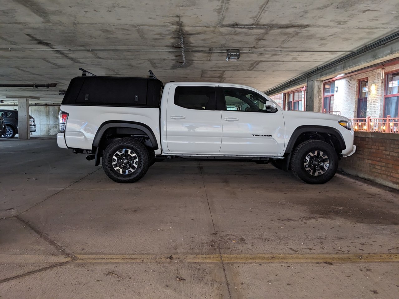

    If this helps anyone with what stage to use, this was what I ended up with on my new '23 OR. Any off road are light trails/forest roads. No lift or anything.
    I have the RSI Adventure cap. Approx 200 lbs. I was riding about level with stock leafs.
    Stayed with stage 1 and used my OEM Bilsteins/bump stops. I got about 2" of height. I'm sure this will settle to about 1.5 or so. Then I tossed about 200 lbs in the back for what I'd assume camping gear/etc might be. Didn't lose much at all. Has a little rake, but nothing crazy.PXL_20230806_201118709.jpg
