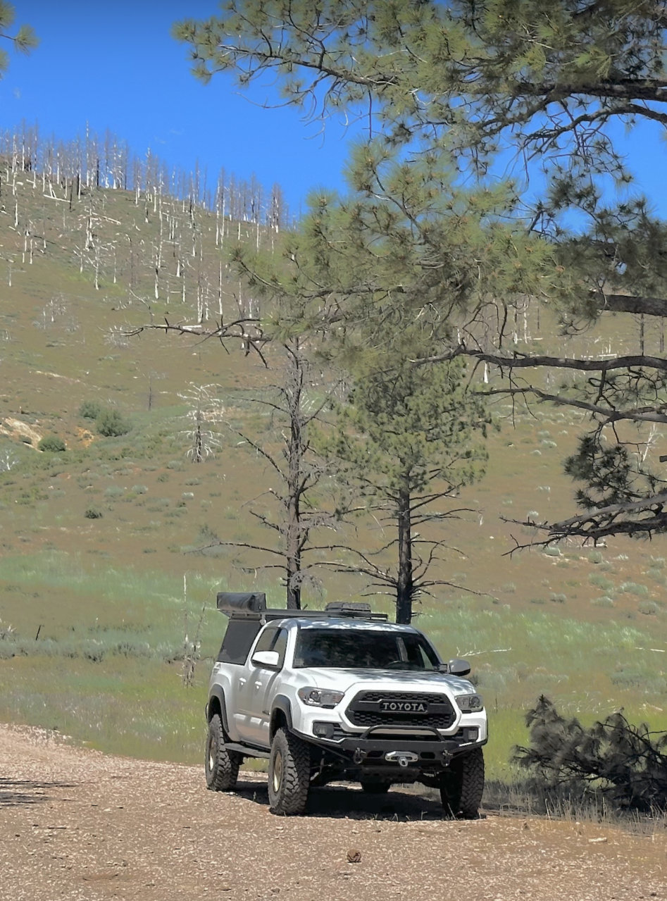

    Definitely go option 3 IMG_0433.jpgLoaded still have about 1” to 3/4” rake. I’m not I fan of the level look. Plus rake helps with visibility over these huge hoods

    @71tattooguy
    • Did you get a GFC?
    • Is that a 23Zero awning?

    I got the topper (camper shell) with the cross bars. Yes 270 AWNING By OVS overlandsystems

    Oh cool I haven't seen much on those yet. Did you do a thread on it? How do you like it? Any issues with water getting in?

    Have t done a thread but good idea. I should done one. I love it so far. No leaks to really worry about. Got recovery gear up top. Have sleep platforms (bam beds) Have totes stored underneath. Super stoked with set up. I recently did the rear seat delete and love it. Fridge in truck works out awesome. Been a fun project for sure.

    I did pretty much the same thing as you. Bilstein 6112/5160, Icon RXT, GFC topper, and I just got the OVS 270 LT awning, but I haven't mounted it yet. I decided on the GFC billet awning mounts, now I just need the time and motivation to install it!
    I have my leaf pack on option 2 but seeing how yours looks I might change it to 3. But I only have my shocks on the 3/4 notches and I don't want to increase it. Might have too much rake for my taste. But like you, I do like some rake since I tend to load up the bed.
    I have had mine since January and I think it's great! I did a little write up in this thread: https://www.tacomaworld.com/threads/gfc-finally-releases-the-new-topper.778711/page-5#post-28231435

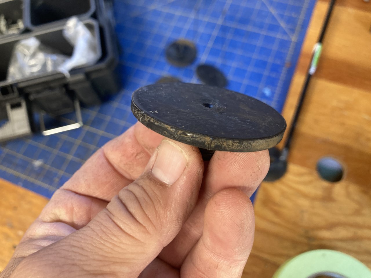

    As far as squeaks go, I have them when I don’t spray the lithium … has anyone tried this yet. I may take mine apart and swap the pads to the stock pads off my old leaf packs . They are quite a bit thicker and rubber instead of the hard plastic that comes on the RTX springs

    I just disassembled, cleaned, and rebuilt a slightly used set of RXTs as Option 2, but I'm probably going to rebuild as Option 3 now because I just picked up 700lb Eibach front springs for 6112's and I'm adding a winch, SSO hybrid slimline front bumper wings, and sliders. Already have a heavy ARE XT topper, 2X hitch mount bike rack, and the wife and I haul a ton of junk, dogs, and camping gear. The stock rear leafs are always bottoming out.
