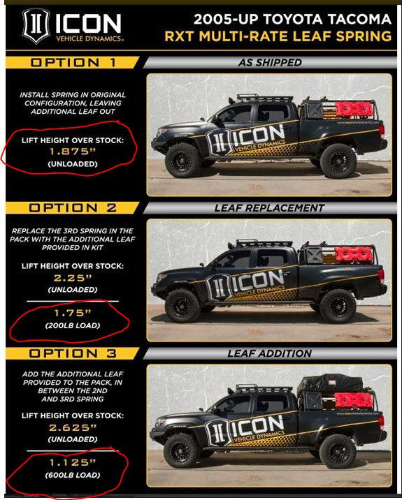

    How much settling are you guys seeing with the RXT leaf packs?
    I installed mine on Option 2 which advertises 2.25" unloaded, 1.75" w/ 200 lb. load.
    2nd gen DCLB with a fiberglass cap (~200 lbs), and I'm at about 2.75" of lift after 400 miles or so. Would you guys expect this to settle in to the advertised heights?

    I got 2" on option 2 with 300 pounds of extra weight. 18 months in it has not settled at all.
    I did a 1.5" lift on the front. When I load up for camping I end up at just about level. Note I camp light, if I have more than 300 pounds of camping gear I would be surprised.

    I would go straight to Opt 2. The lower spring rate of Option 1 will definitely feel the effects of the added weight. The boost in spring rate of Option 2/3 definitely feels nice when you start throwing weight at it.

    the icon techs i was talking to when i was comparing stage 7 (3 leaf aal) to stage 10 (rxt) i was told that the rxt pack has a higher spring rate than the oem pack with overload replaced with their 3 leaf add a leaf.

    I think that we're referring to the same thing here, but I'll reiterate just to make sure!
    For the full RXT leaf pack, Option 1 is 20% LOWER spring rate than OEM stock pack, Option 2 is 20% MORE than OEM, Option 3 is 40% MORE than OEM.

    the rxt pack on option 1 has a higher spring rate than oem leaf pack. that is before it starts hitting the overload leaf. that thick inverted overload leaf drastically increases spring rate at that point. replacing it with their aal pack causes oem pack to have an overall lower spring rate than the rxt option 1 pack. spring rates arent exactly linear on these so not sure at what point they are measuring and comparing.

    Is this why they don't even state what the expected lift result would be with any added weight on option 1? I always found that weird.
    Sounds like option 1 is pretty much focused on lift and handling performance but specifically with no added weight? Anyone looking to improve with even say 200 pounds should be looking at nothing less than Option 2.

    I'm carrying 400 lbs consistently (go fast camper, drawer build-out, and compressor) and top out at 600 lbs on trips that total around 4 months of the year in my 2015 access cab. With 400 lbs on my stock suspension, my front and rear are even height but it sagged on the rear when I was around 550 and bottomed out on bumps. I drive a lot of rough dirt roads for work during those 4 months with lots of highway driving in between. Is level 2 the way I should go, or should I compromise the daily driving comfort and go to level 3? Everything is stock on my rig.

    see my post #1807 in this thread, and I quoted myself from earlier to tie all info in together.
    I am about 335# with a Decked and a fiberglass topper and went with stage 3, and I am very happy, but also happy I didn't do stage 2 and have to pull it all apart again.
