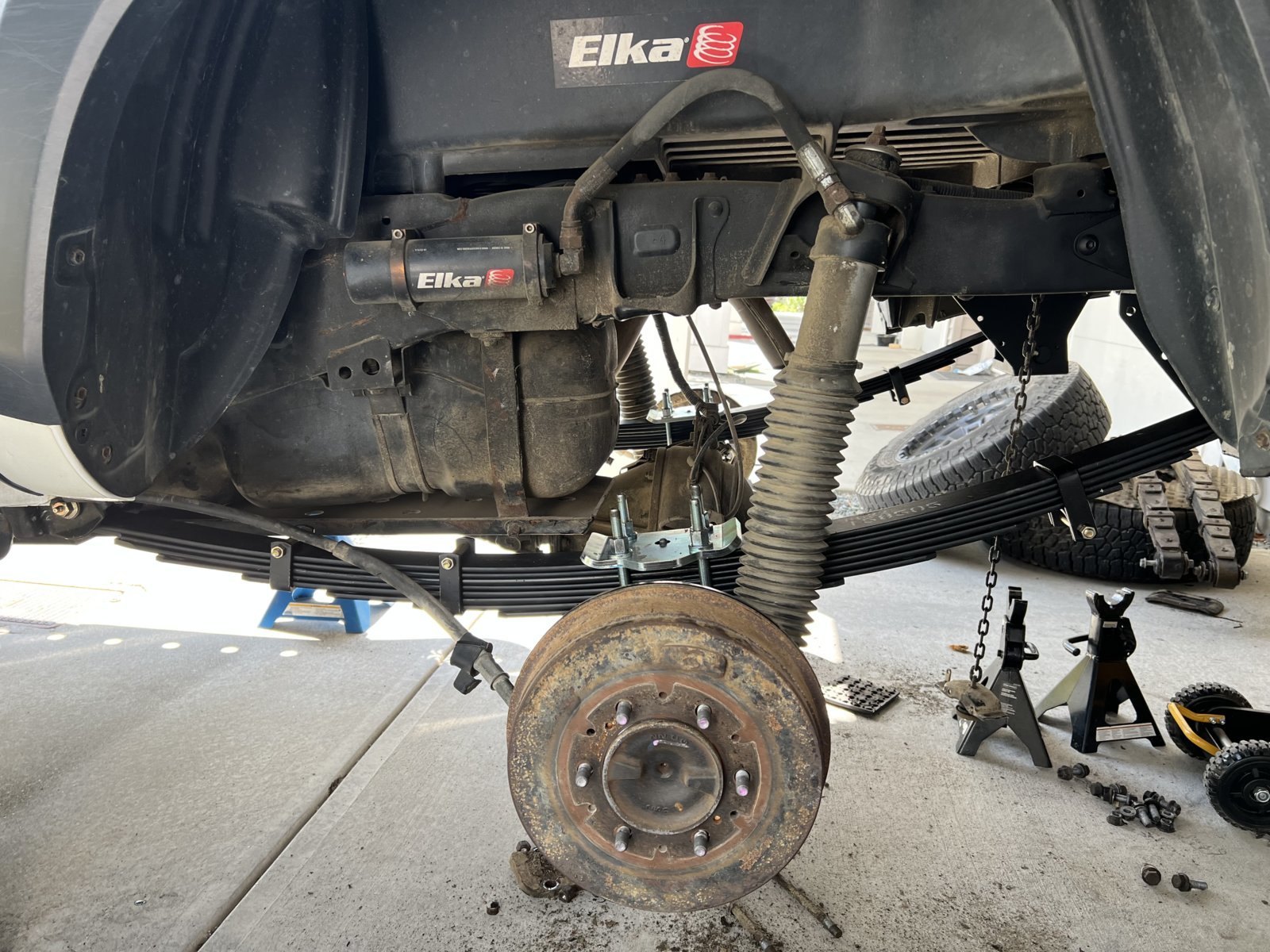

    I have Elka 2.5 resi suspension with Timbren bumpstops and u-bolt flip kit. I wouldn’t use factory Bilstein with these leafs. You are going to top them out and eventually the shaft will pull out of the body. I would swap them out for Bilstein 5100 or Eibach suspension

    Yes they are. With stage 3 and 300-400 lbs of gear my bumpstops frequently make contact when I bomb down fire roads. It’s nice to have them at slow speeds too while crawling up rocks and dips. Those factory bumpstops are like cement blocks. They’re very stiff and when they make contact with the frame it’s a very jarring/hard hit.
    There are two versions of the 5100 but both will work with these leafs. One is a mid travel length (5100) and the other is an extended travel (longer length called B8 5100).

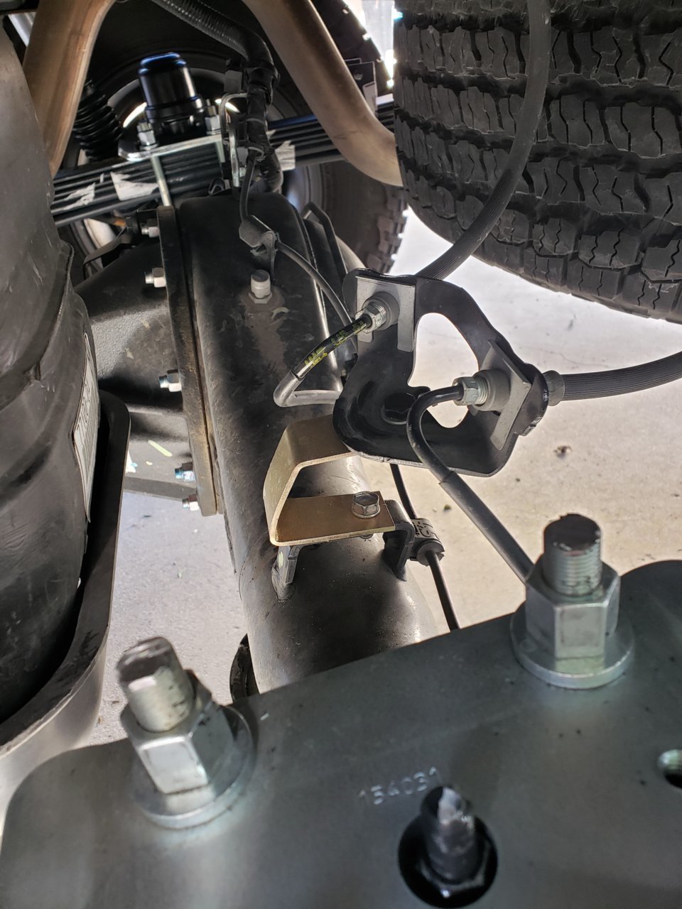

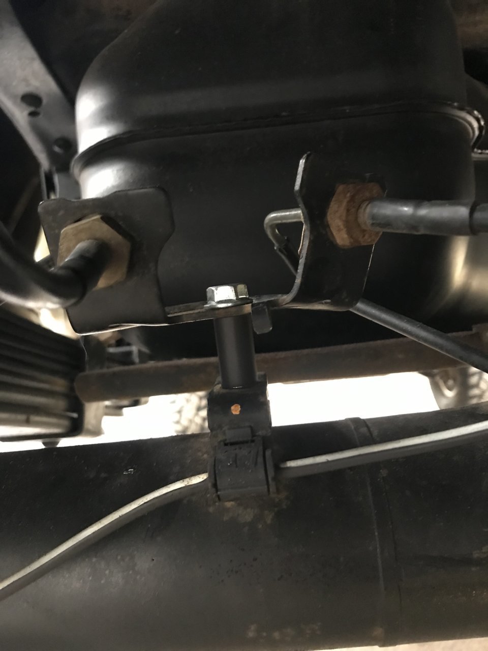

    Stack a bunch of washers, a block or metal sleeve with a longer bolt is all you’ll need. Couple different variations to do it to avoid extended brake lines.
    https://www.tacomaworld.com/threads/when-to-use-extended-brake-lines.651956/

    Wasn't there a link to a bracket from Lowes that people were using? Something about preventing fuel tank rub or over extension of the brake lines?
    edit: flipping the bolt around was to prevent rubbing on the gas tank. I think there was a link to a bracket for the brake line though.

    Thanks. Doesn't look too complicated.

    Did you find that Lowes bracket?

    Thanks that looks pretty easy to replicate.
