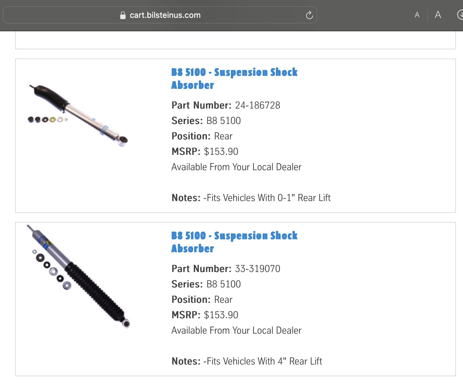

    If going with Bilstein 5100s with the leaf pack (or an AAL) to get 1.5" lift in both the front and rear, is the B8 5100 (rear) Part Number:33-319070 (Fits Vehicles With 4" Rear Lift) required since the B8 5100 Part Number:24-186728 (Fits Vehicles With 0-1" Rear Lift) appears to not extend past 1"?
    I'm a bit confused since the 33-319070 part doesn't mention a range.

    I'm running a 200 lb camper shell and about 50 lbs of stuff every day. I have about 1.5" of lift in the rear. With about 200 lbs of gear, I'm level. Option 1.

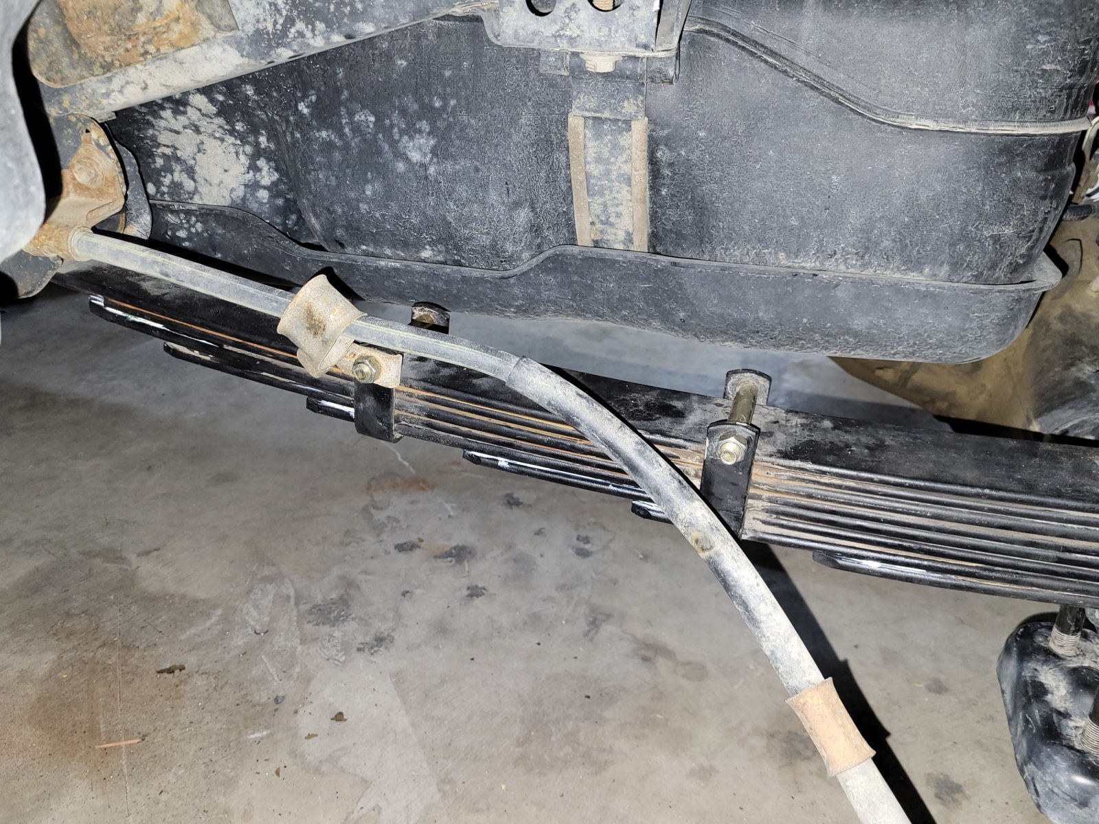

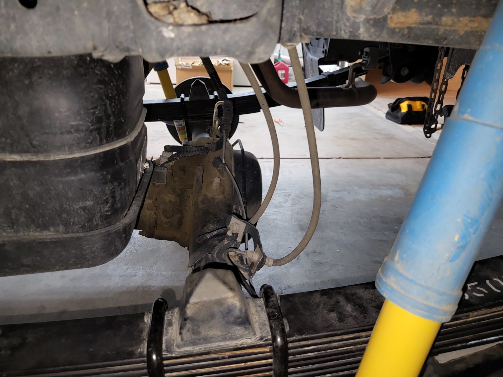

    Well I had an interesting full day putting in the springs. Learned a lot. Only problem is stage 3 raised my back end just shy of 4 inches! Can't even get out of the garage with the limited clearance from my go fast camper, lol. Is that typical? I have just under 400 lbs on the bed right now (gfc platform camper @300lbs and drawer buildout inside the truck). I am surprised it didn't settle lower, as I bought the springs lightly used (he told me 3K miles with some offroad use). Maybe the old springs were that beat, such that my measurements at stock height would have been that much higher? Its an access cab and I have 265/75/16 tires and with the load in the back, the top of my wheels wells were at 36" and now they're just under 40. I'll probably be down grading to level 1 so I can get in and out of the garage.
    Here are some photos of the brake lines. I dropped the axle all the way and the lines had plenty of play, so I'm assuming I'm good on not needing to extend them? Is the location I moved the E-brake line to on the spring good enough?

    think because you are on stock billies, there limiting your droop so your brake lines are fine

    2002 Toyota Tacoma trd
    That makes sense. I'm planning on installing 5100s in the near future. Will have to reassess the brake lines then.

    shocks are gona be limiting factor. but with my icon omegas there was no way stock lines were long enough. i added a 1" spacer and longer bolt to the brake line bracket on the axle. this got me just enough where i felt comfortable at full droop.
