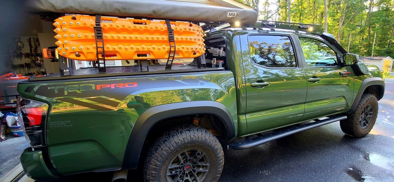

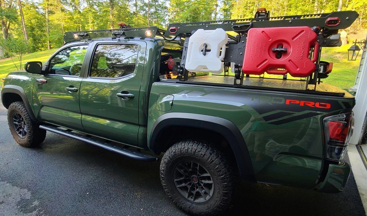

    I have an overland setup (pic below). They recommended a stage 1 for my usage to start and stage 2 if I plan heavier loads. They said stage 3 would be overkill and way stiff.

    What all are you carrying? Hard to tell if you have a RTT or not.
