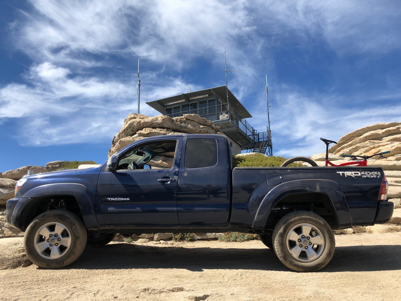

    Installed Option 2 because I liked the height and anticipated armor+spare 33. Slight rake. Picture above is unloaded and does not change with 250lbs in the bed but does keep my tires on the ground better. Unloaded ride quality also improved after settling for a couple months.
