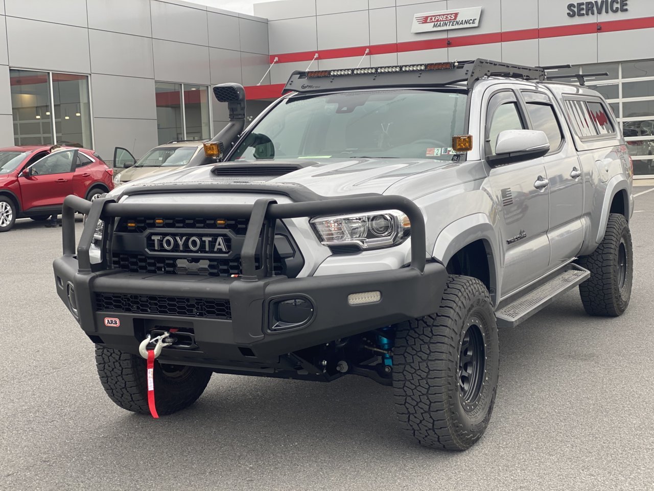

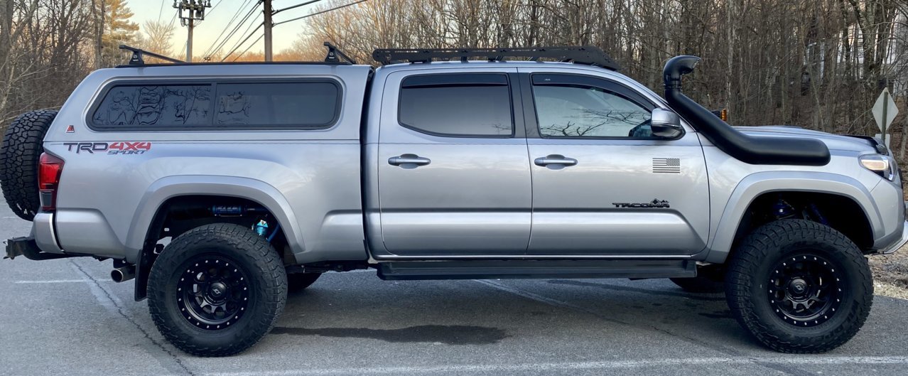

    I’m running Stage 3 on my truck but have about 400lb in the bed constantly with camper shell, bedslide, Rotopax, hilift, Wilco Hitchgate tire carrier and rtt when camping. If you are running no weight either go with Stage 1 or 2. I am also running 700lb Spring with King 3.0 with very little preload. Now have an ARB SUMMIT bumper with 10k Warn winch. No sagging at all 711478C0-2324-4007-9C7F-44713531A720.jpg F1B6462D-90C0-4572-9385-95CFFD78741F.jpg 7F9809E8-A94E-4EDB-BD09-097734B243C7.jpg

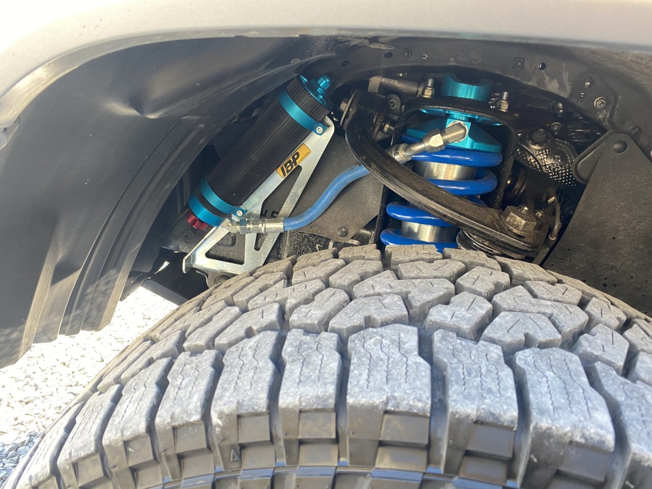

    I can’t speak for what to do with the leaf pack as I’m running OME Dakar’s. But I have icons with the 700lb springs and I wouldn’t suggest over preloading them past Icon’s suggestion if you use the truck off road and are going to flex it out. It’ll definitely effect the ride and you might bind up the coil and break it. Do you still have your sway bar installed?

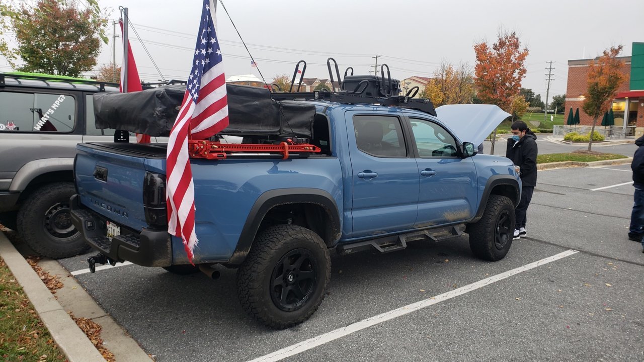

    I'm running the ICON 2.5 coilovers extended travel with 650lb coils, and ICON RXT leaf pack at stage 3. I still have some rake in the back (which I prefer because it levels out when loaded with the rest of my camping gear. I also have a craftsman toolbox loaded with tools, and an UnderCover SwingCase loaded with gear in my bed at all times.
    My truck is heavy(and will only get heavier)... between the sound deadening(100% interior coverage), triple subwoofer rear seat delete, 3 amplifier and pro audio (all Skar audio products), all the weight on my roof rack, steel steps, URD Supercharger up front. The pelican case on my roof rack is loaded with recovery gear (tow straps, shackles, crow bar, jumper cables, portable battery starter/charger, and a few other items.
