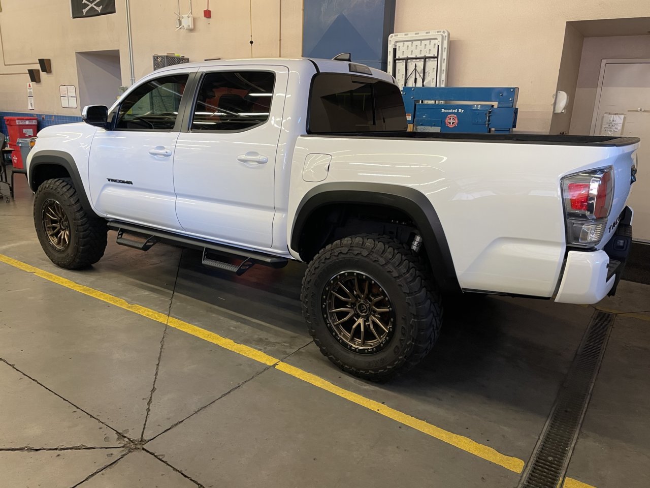

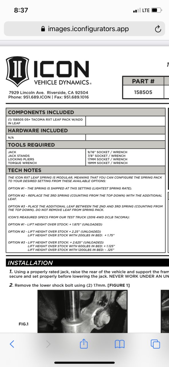

    Hello everyone! I just bought a used 2020 Tacoma from a dealership. Previous owner added an Icon/Fox suspension system including the RXT leaf pack. Unfortunately, it was a trade-in so I did not get the extra leaf-spring. Further, I don't know if the leaf-pack is currently set up as option #1 or option #2. I am assuming it is option #2 using the heavier spring since it sits noticeably higher in the rear and rides extremely firm. Plus, I only count 7 leafs.
    I want to lower the rear about an inch. Is there anything that would indicate to me that the heavier spring was switched into the leaf-pack? Is there somewhere to source just the option #1 standard leafs?
    Thanks in advance for the help!

    You should measure from Center of hub up to your fender. Icon says option 1 is 1.875 inches higher than stock. So you would be around 24 inches.

    So it looks like I am at 24.75" from hub center to my fender. Based off of that, I would think the previous owner switched out the leaf spring to go to option #2 (does that sound correct?).

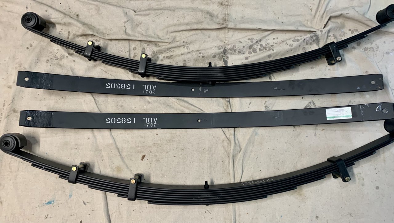

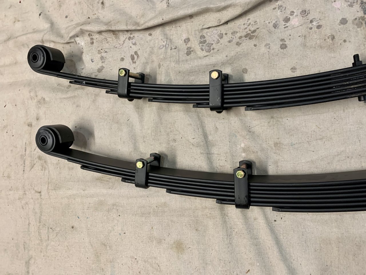

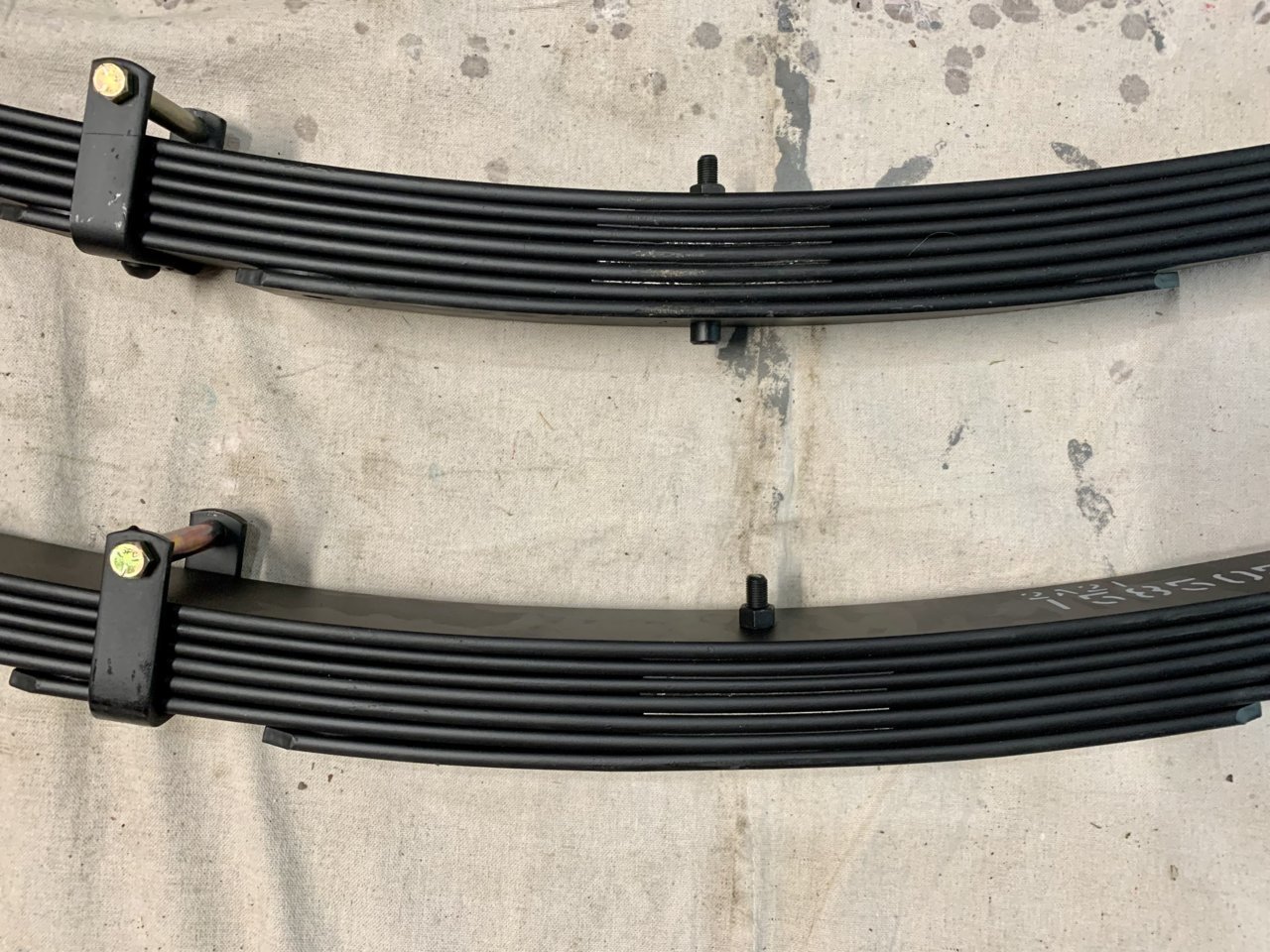

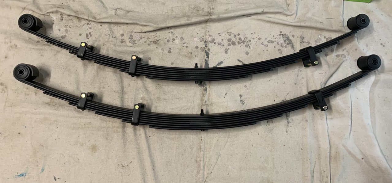

    I just received a set from Icon. For reference here’s how the “out of the box” Stage 1 spring setup arrived, 7 leaf pack…
    Kolter45 and 71tattooguy like this.

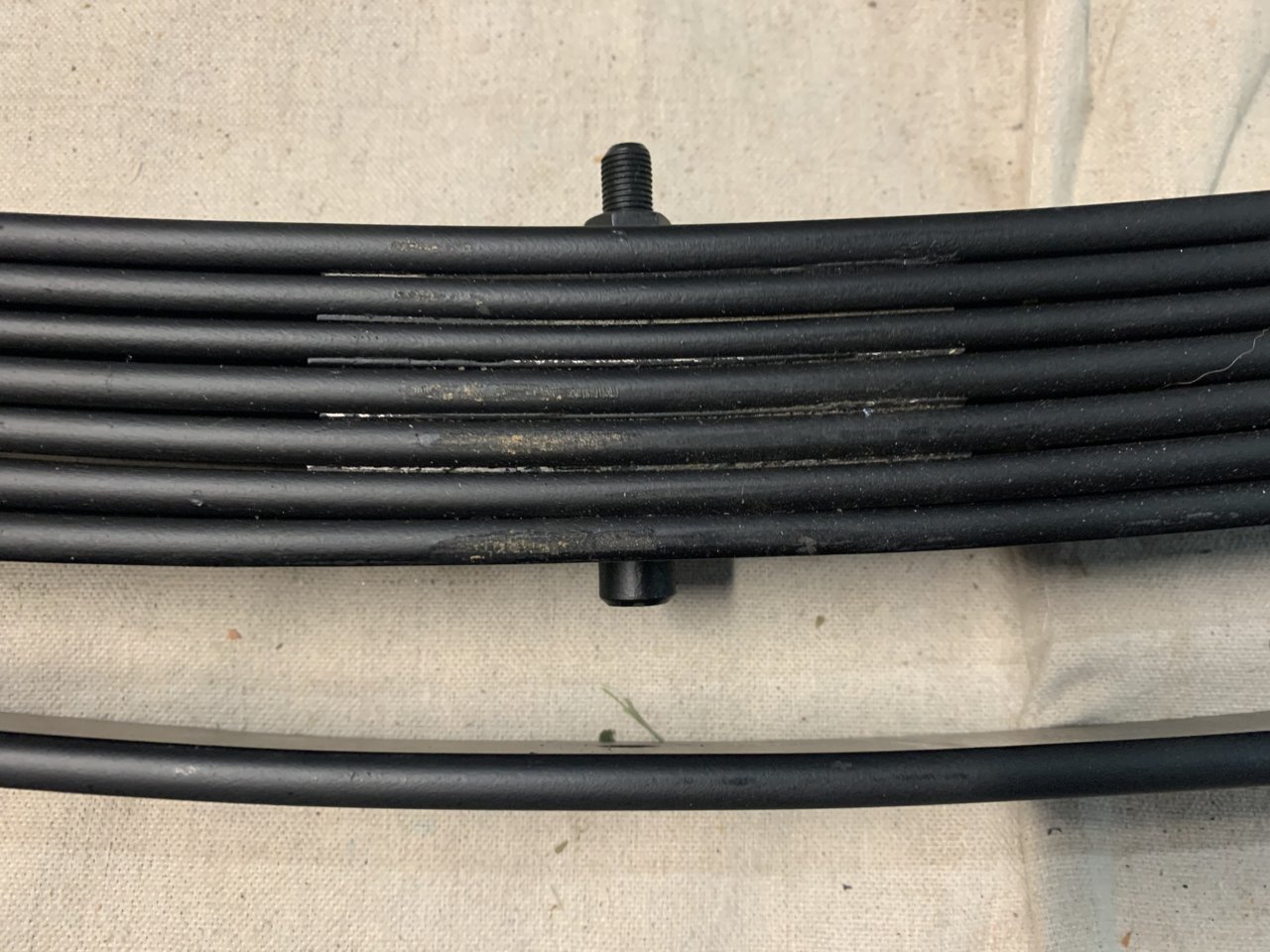

    From what I can see on mine, the 3rd leaf (from the top) is thicker than the others which is what is making me think mine is set up in option #2. In your pictures, they all look to be the same thickness.

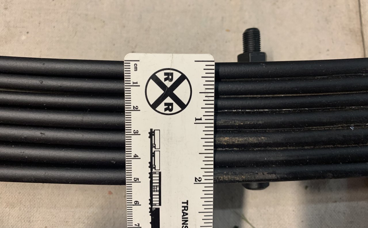

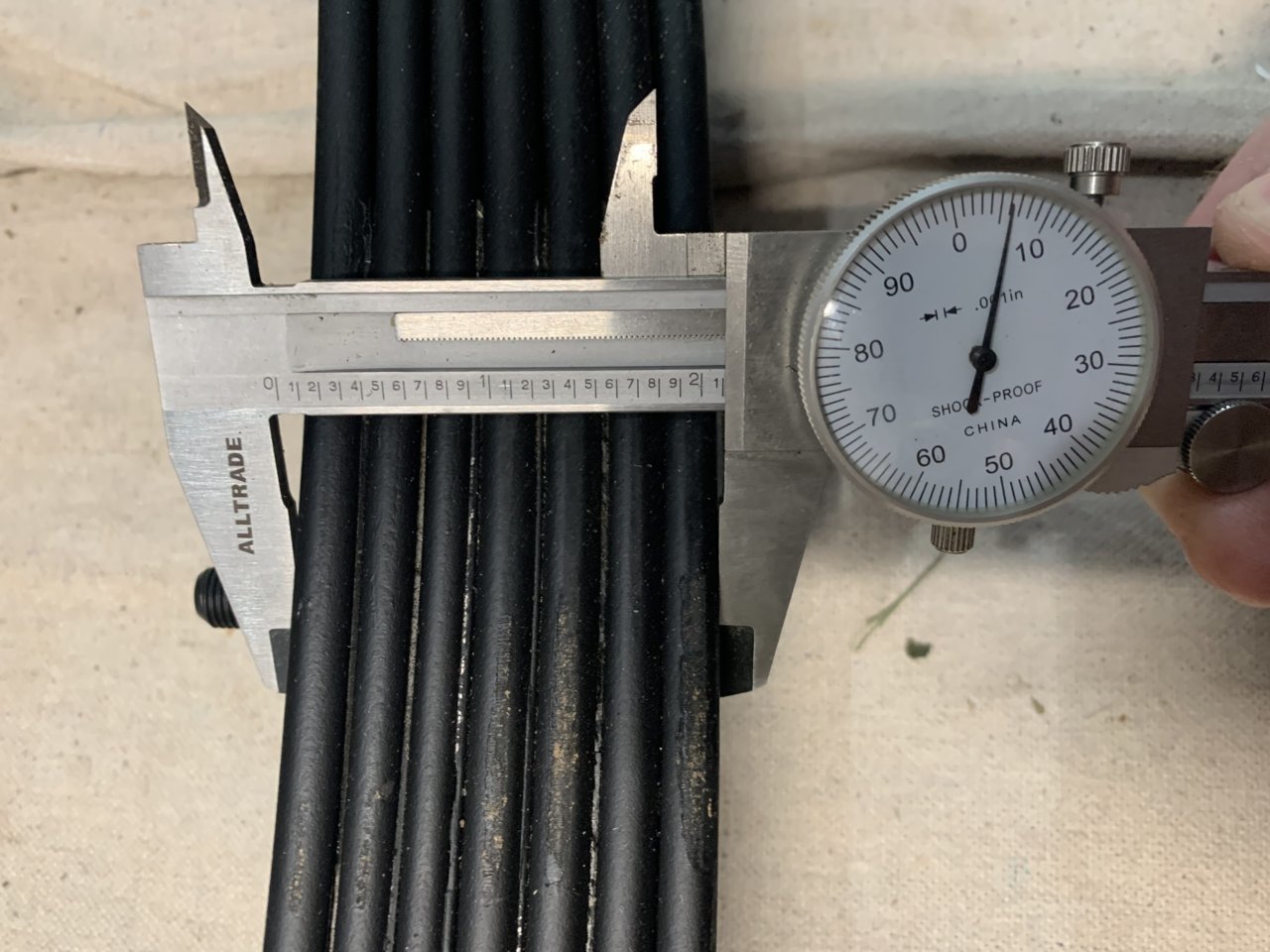

    I measured the Icon stage 1 spring stack, about 2.1” thick. It does seem the each leaf has slightly different thickness. I measured the following from bottom to top:
    1 - 0.3”
    2 - 0.3”
    3 - 0.3”
    4 - 0.3”
    5 - 0.23”
    6 - 0.23”
    7 - 0.3”
    The extra spring included with the RXT spring kit is 0.325” thick (not installed), so total stack would be ~2.50” with spacers if installed if aiming for the Stage 3 (8 leaves).

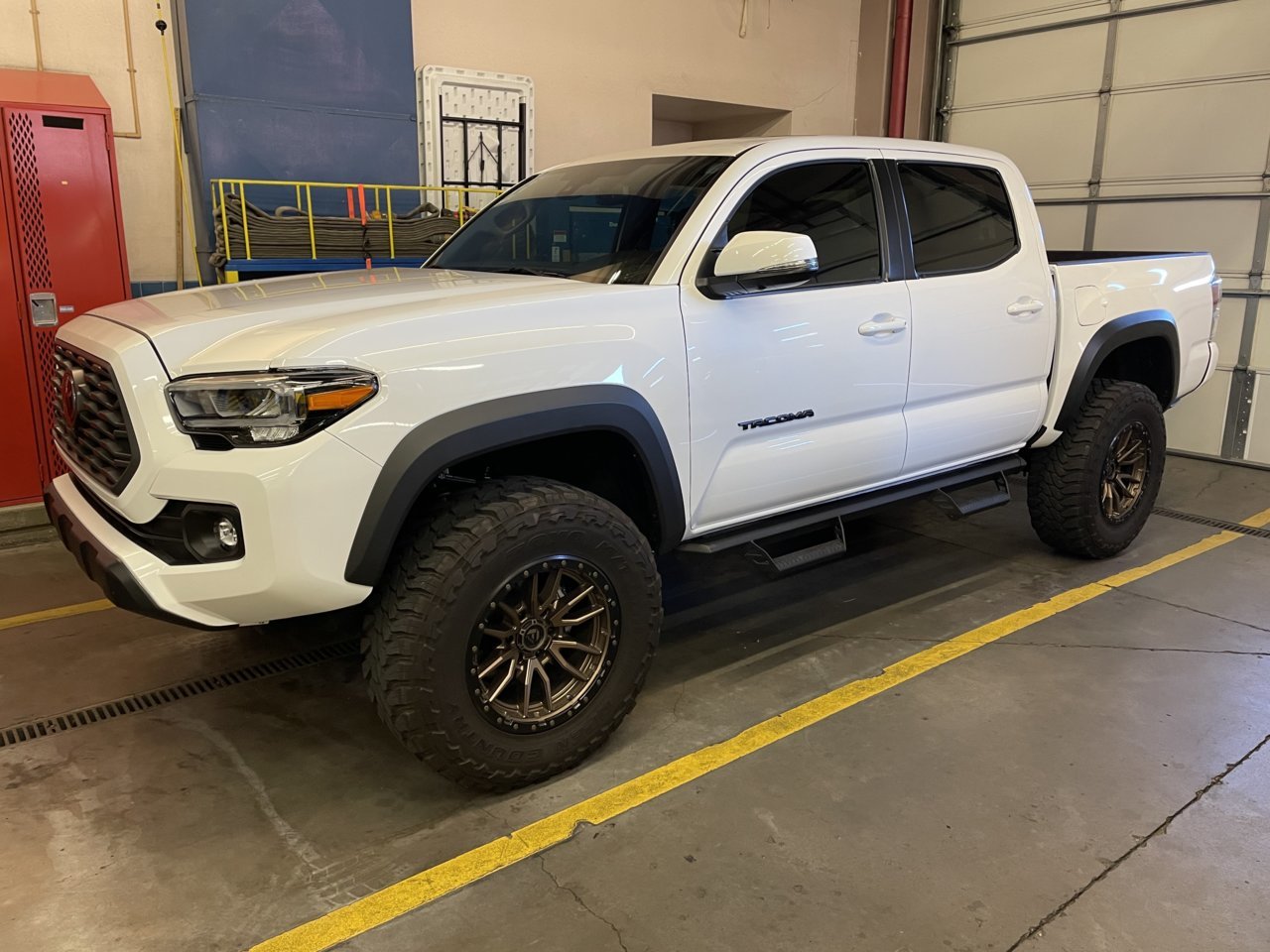

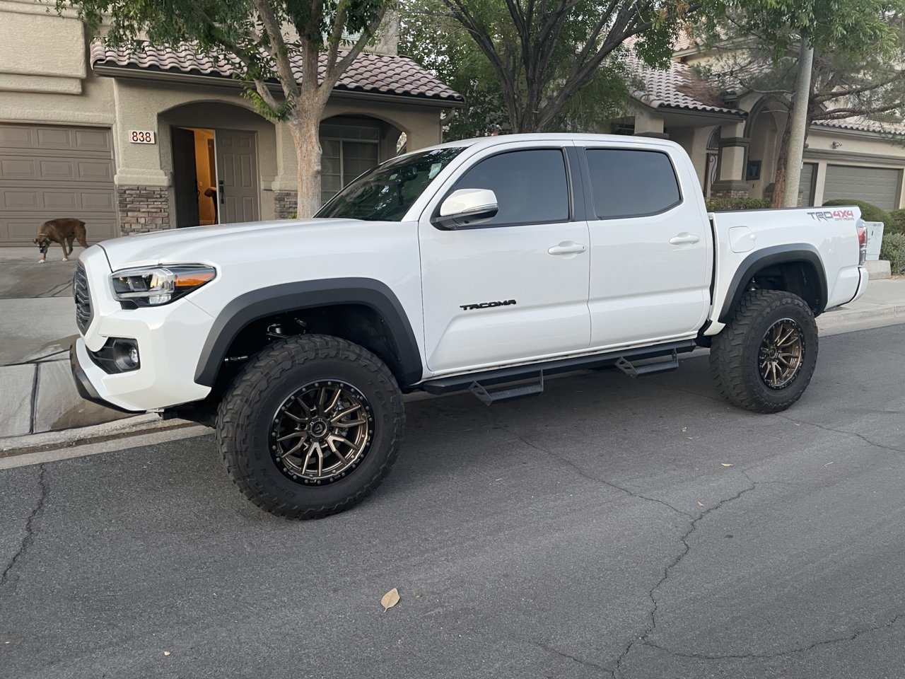

    First, I want to thank everyone who potentially offered their option #1 leaf. A friend recommended that I go to the local spring shop here in Vegas and see what they thought. Once I explained the situation, they offered to fabricate a replacement leaf that matched the thickness of the others and remove the option #2 leaf. Looking at the pictures provided above, this would be consistent with how they come stock. In total, the shop had it for about 3hrs and when I went to pick it up, the stance was better (roughly 0.5-0.75" lower) and the ride was softer. Definitely happier with it (and I have the #2 spring if I ever add a few hundred pounds to the back)! Thanks again everyone.
