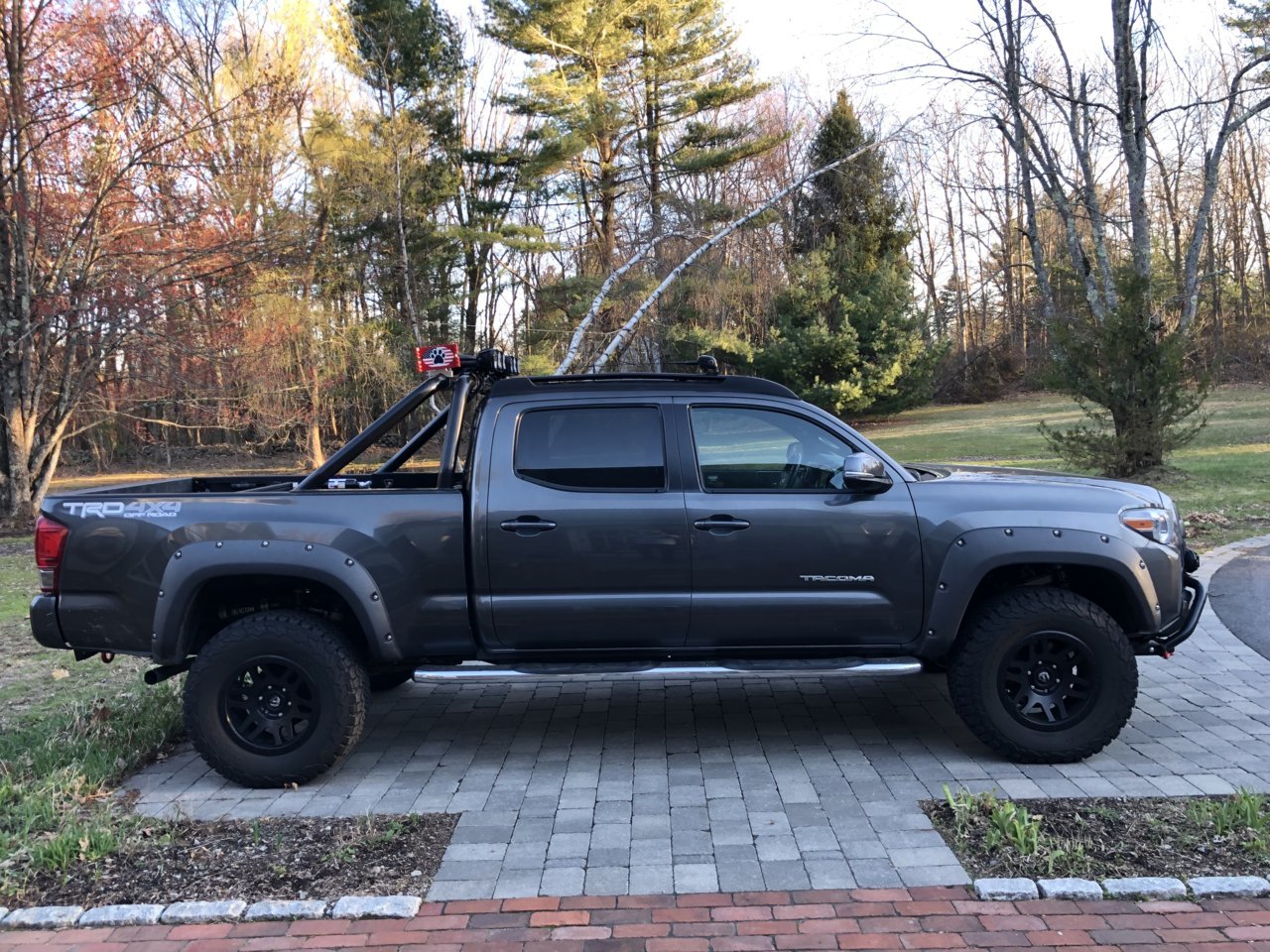

    Cudgel “Tonka”
    Mar 28, 2017
    #214640
    3,156
    Live in: An Ocean of Plastic Trash
    2017 OR DCLB
    ICON8 Lift -285s. upTOPoverland rack.
    The performance is excellent. I have a complete Icon system so the excellent handling is somewhat a factor of the coil-overs, but the rear is stable, responsive and durable. I set mine at medium (2 of 3) as I only carry 245 lbs of overall dead weight, much of it centered of course, so I find the sweet spot is when I add about 100 lbs more in cargo. Regardless that’s really splitting hairs as I can take speed bumps at 50 and washer board at 75.
    I’m not sure what you mean by “looks” as it’s pretty hard to see any of it without climbing under.

    Sorry for the confusion. Looks as in if by any chance you had rake and didn't like how they settled, maybe they settled too much and you are sagging in the back, etc. I have new 6112s in the front and 5160s in the rear installed last week. My factory oem leafs are trash and dont do my suspension any justice. I wanted to go with Deaver, but they just quoted me 6-8 weeks for completion of my leaf packs and that's just too long. Wondering if these Icon RXT would be a good out of the box option.

    Ahh! I wanted to preserve the factory rake...I’m not much for leveling and have no interest in going Bro. I don’t believe I’ve seen any setting in 25k miles. This was another reason I chose setup option 2, as it was 1/4 inch higher than where I set the front to keep the rake even with some settle. For longevity I could reset them to option 3 (more lift) as they approach end of life I suppose as it is all in how you stack the leaves.
